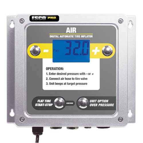

Fifty150 Posted December 26, 2019 Share Posted December 26, 2019 On 12/22/2019 at 3:40 AM, Gideon said: simply ignoring the TPMS warning in dash Expand I am driving with the TPMS light on. I am okay with that. I am using the spare tire. It's a full size wheel and tire, so I rotate it into use. I visually inspect the tire. I top off the air whenever I can, as I remember to do so. I use a tire inflator, with a gauge which stops at the correct pressure. Set the digital gauge to desired PSI, turn on the pump, and it automatically stops at the correct pressure. For anyone who does not want to buy a tool like that, they can use the tire fill stations which are equipped with the same type of pump, at Costco or most tire shops. For some people, they don't want to ignore the light. They want the sensors to work properly, so that the light can actually warn them. TPMS is an important safety feature. That being said, if all of us were looking at our tires, and checking air pressure, there would be no need for TPMS. We would see the obvious nail in the tire. Air would always be topped off. We would also see if the tread and sidewall appears damaged. TPMS sensors on my truck are original, and that makes them about 13 years old. Still working. I wonder how long the TPMS on my Transit Connect will last. Quote Link to comment Share on other sites More sharing options...
