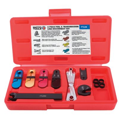

mike56 Posted April 17, 2012 Author Share Posted April 17, 2012 UPDATE. Instead of disconnecting the hose at the bottom of the trans cooler It is much easier to go right to the transmission in front of the left front wheel. I do not have the tool to disconnect the hose so I just removed the nipple on the transmission with a 17mm wrench. I put the end of the removed nipple into a 3ft peice of heater hose. I took 3 milk jugs and marked them at 3 quarts. I started the engine and pumped out 3 quarts, then put 3 in,replaced the jug with another and repeated. I did this 3 times with 9qts of ford LV fluid. When done I put the nipple back into the transmission. I looks to be a fine thread so be carefull and mine is not leaking but I should have used locktight or rtv sealant. email me if I can help you do yours mgrant0606@aol.com The fluid was about $60 at a ford dealer. operating engineer O/O 1 Quote Link to comment Share on other sites More sharing options...
