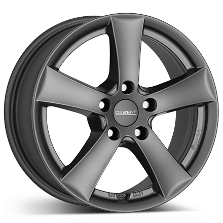

mrtn Posted April 1, 2018 Share Posted April 1, 2018 I went classic. You could call them base modelish, but I wanted to make sure they're strong and from a reputable manufacturer as I sometimes ride fully loaded and a thin spoke wheel may fail a pothole, so I ditched the original idea to get a fancy replica wheel. Quote Link to comment Share on other sites More sharing options...
