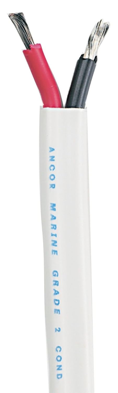

Fifty150 Posted December 23, 2018 Share Posted December 23, 2018 Use a 2 conductor wire which is already jacketed. jrm223 1 Quote Link to comment Share on other sites More sharing options...
