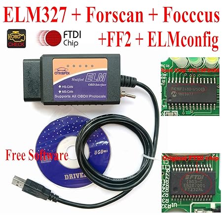

Fifty150 Posted February 9, 2019 Author Share Posted February 9, 2019 On 2/4/2019 at 7:57 AM, jrm223 said: Lenovo ThinkPad with Windows 10, and I used this OBDII wired USB converter from Amazon - I'm a computer tech and I prefer wired instead of wireless, whenever possible, except for keyboard/mouse lol. Good information. You are a computer tech, and you were able to make this work for you, without the very expensive OBD II hardware that some people believe is necessary. I also see an inexpensive kit which includes FORScan. I suppose a $100 investment into a cable is not always "must have". Roll over image to zoom in ELM327, Forscan ELM 327- HS-CAN and MS-CAN Modified ELM327 OBD Self Diagnostic Tool Compatible with Forscan Focccus ELMconfig FF2 Software for Focus Mondeo Kuga Edge Exploror F50 Taurus Everest Escort by OTKEFDI 4.1 out of 5 stars 8 customer reviews Price: $29.99 | FREE One-Day Quote Link to comment Share on other sites More sharing options...
jrm223 Posted February 10, 2019 Share Posted February 10, 2019 I have Forscan and Focccus already, both are free. I'll have to look into those FF2 and ELMconfig programs to see what other features they might offer. I still need to find a way to change tire size to correct for my 215/65's and I don't think any programmers are made for our vans like more popular vehicles. The two programs I have only have a few options for tire size, which are various factory options. My cheap ELM327 device has the MS-CAN/HS-CAN switch like that last one, I was surprised to not see a switch on yours (Fifty150). Maybe the unit you have has firmware programming that automatically switches between the two CAN-bus types, if not you'll be limited on what parts of the computer you can access. Quote Link to comment Share on other sites More sharing options...
Fifty150 Posted February 11, 2019 Author Share Posted February 11, 2019 4 hours ago, jrm223 said: My cheap ELM327 device has the MS-CAN/HS-CAN switch like that last one, I was surprised to not see a switch on yours (Fifty150). Maybe the unit you have has firmware programming that automatically switches between the two CAN-bus types, if not you'll be limited on what parts of the computer you can access. Mine is from 2007. It's 12 years old. jrm223 1 Quote Link to comment Share on other sites More sharing options...
Fifty150 Posted February 16, 2019 Author Share Posted February 16, 2019 On 2/10/2019 at 3:58 PM, jrm223 said: My cheap ELM327 device has the MS-CAN/HS-CAN switch Okay. So I really didn't know what that means. I had to look it up. Here is what I found @: https://www.ecoboostperformanceforum.com/index.php?topic=651.0 HS-CAN modules: -PCM (Powertrain Control Module) -ABS (Anti-lock Brake System, includes AdvanceTrac and Traction Control) -RCM (Restraint Control Module, AKA airbags and seatbelts) -AWD (All Wheel Drive module, if equipped) -OCSM (Occupent Classification System Module, AKA Passenger Seat Sensors) -PAM (Parking Aid Module) -IPC (Instrument Panel Cluster) -BdyCM (Body Control Module 2013+) -ACM (Audio Control Module, 2013+) -FCIM (Front Controls Interface Module, 2013+) -PSCM (Power Steering Control Module, Hydraulic PS only) -SECM (Steering Effort Control Module, Electric PS only) -CCM (Cruise Control Module) -SCCM (Steering Column Control Module, 2013+) -APIM (Accessory Protocol Interface Module AKA SYNC) MS-CAN modules: -SJB (Smart Junction Box) -HVAC (Heating, Ventilation & Air Conditioning module) -ACM (Audio Control Module, pre 2013) -DSP (Audio Digital Signal Processing Module) -DSM (Driver Seat Module) -DDM (Driver Door Module) -RFA (Remote Function Actuator Module) -DCSM (Dual Climate Controlled Seat Module) -SDARS (Satellite Digital Audio Radio Service) -FCIM (Front Controls Interface Module, pre 2013) -FDIM (Front Display Interface Module) -ILCM (Interior Lighting Control Module) -HCM-2 (High Beam Control Module) -SOD-R/L (Side Obstacle Detection Control Module AKA BLIS, a module for each side of the vehicle) -IPC-MS (Instrument Panel Cluster, MS-CAN) -GPSM (Global Positioning System Module) -APIM (Accessory Protocol Interface Module AKA SYNC) jrm223 1 Quote Link to comment Share on other sites More sharing options...
clb3092 Posted February 21, 2019 Share Posted February 21, 2019 I'm using an ancient cheap o netbook and VXDIAG VCX NANO for V112 Ford/V112 Mazda that I ordered directly from the manufacture's website vxdiagshop.com At about $87 it works flawlessly with Forscan and does both HS-CAN and MS-CAN automatically. Just select j2534 for the connection type. I should note that I do not use the VXDIAG VCX with Ford IDS or any other program besides Forscan. Most people buy the vxdiag for IDS but from what I understand Ford periodically tries to block j2534 adapters except for the official one that costs a lot of money. I originally purchased an earlier version on vxdiag when I was in California and my main concern was making sure their were no surprises when it came time for the dreaded SMOG inspection. If you don't mind spring for the extra $ I recommend the vxdiag. J2534 connection is the superior connection tech for Forscan. It's faster, comprehensive functioning and as far as my experience just works. I should note that I haven't tried anything dicey or fancy with it like hacking the .... Quote Link to comment Share on other sites More sharing options...
