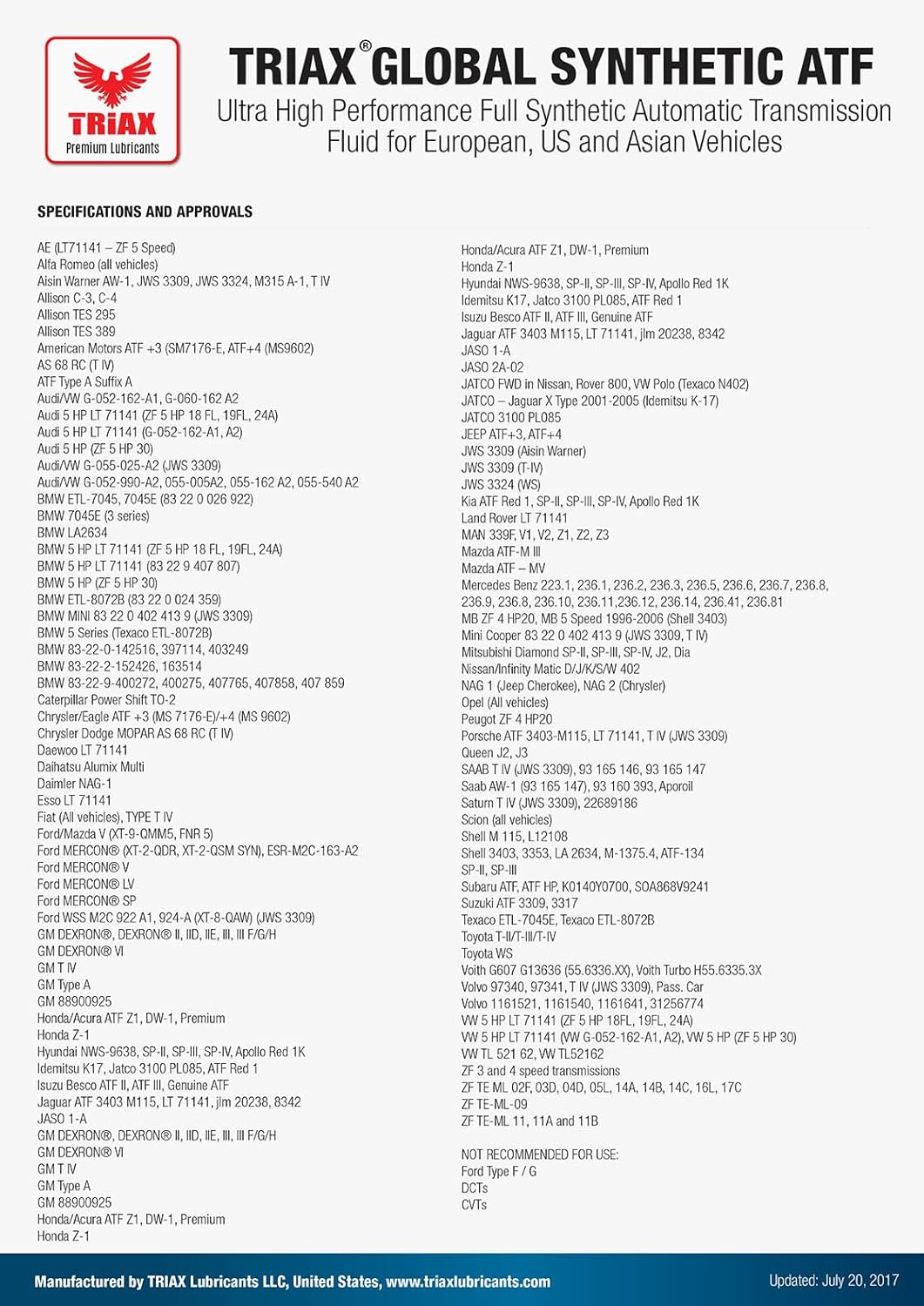

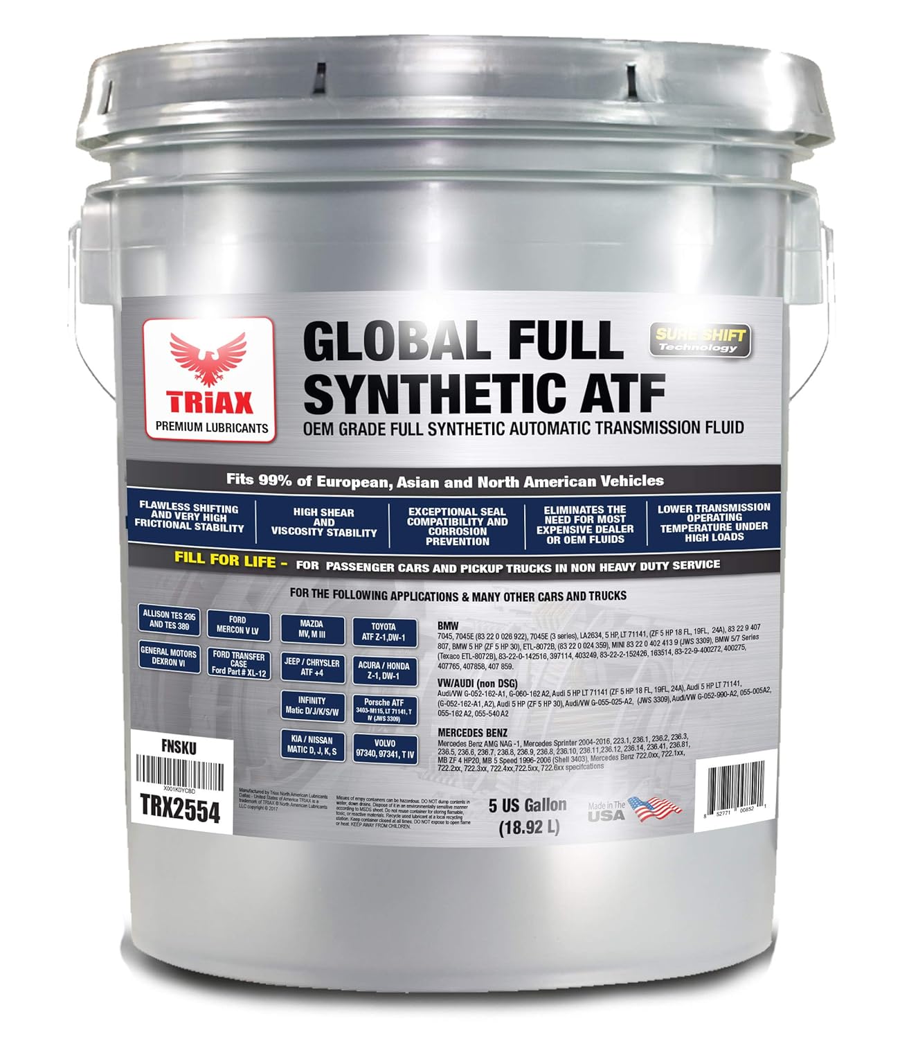

I am using this fluid    Triax Global Synthetic ATF - OEM Grade Compatible with Allison TES 295, BMW, Audi, Mercedes Benz, VW, Honda, Toyota, Nissan, Chrysler +4, Ford Mercon V/LV,...
for the third change  I will let every one know how this fluid holds up.
The temp of this Transmission is above 175 F all the time and that may make the fluid work hard. The temp of the L480E in My 3500 Chev express is around 140-160 F . I Report in 22000 miles
It looks like an interesting product.  I'm skeptical that they can blend an ATF to meet all of those specs from so many manufacturers.  Just for Ford, it says Mercon V, LV, & SP.  The bucket also says, "fill for life".  Almost too good to be true.  I get the feeling that this is about the same thing as what Jiffy Lube uses.  Looks like something that is sold to shops who don't want to carry 30 different fluids.  Let me know how it's working for you.  I worry about transmission slipping and shifting hard when you use "multi spec" ATF.  And if anyone is sending in their used transmission fluid for analysis, that data would be interesting also.

As for the Triax fluid that is impressive but probably not so much difference between different automatic transmissions.  Basic operating principles are the same and don't think the differences are that great so maybe a single fluid will work as they claim.  Biggest issues with transmission fluid is high temperatures causing a breakdown of the fluid.  G B L I'm curious as to how you are measuring the temperature?  Is it thru the OBD port interface?  I have the module and the software and might be interesting to look into.
From personal experience, multi-vehicle ATF never really works as well as when you use the OEM spec fluid.  I've tried spending more money on fancy brands, and all with mixed results.  Amsoil, Lucas Oil, RedLine, Amalie, Royal Purple......
With Honda, only Honda spec fluid works well.  With Ford, when the spec was Mercon & Mercon V, everybody I knew who used a multi-vehicle ATF from the auto parts chain store or chain lube shop, experienced hard shifting, slipping, and poor engagement.  I suspect that with the current spec for low viscosity fluid, it will be much the same.  I'm not particular with brand.  Some people swear that you must use Ford Motorcraft.  My feeling is that any brand will work, as long as it is actually LV fluid.  And there are several brands which sell fluid which is actually LV.  Not something that says "meets or exceeds", then goes on to list every vehicle on the road.  If 1 fluid could do it all, then all the manufacturers will just that 1 fluid.
I know there are people who insist on their boutique oil brand, and how they have a great ATF.  My personal choice is not to use any ATF which is not specific to your vehicle.  I will stick to whichever bottle actually says "LV"
When a lube shop or garage will only use their multi-vehicle ATF, then I will not allow them to service my car.  Same way I do not get oil changes with a coupon, where the coupon staes "4 quarts of 10W-40".  Weird how those shops will argue with you about how they will only use their fluid, instead of using the right fluid.  Notice how a dealership will never use "multi-vehicle" anything?
The Shift quality of my TC has been and remains very good .  I Think that the Oil companies that make the fluid are able to match the Oem speck very well.  I also suspect that they are already making the Oem fluid.
If the oil company wants to make a quality fluid they can.  The fill  for Life part is Crap.
The thermostat in this gear box holds the temp at about 175 for operational reasons.  This trans works the fluid hard and so do I. 6000 miles into the third flush, the vote is still out
