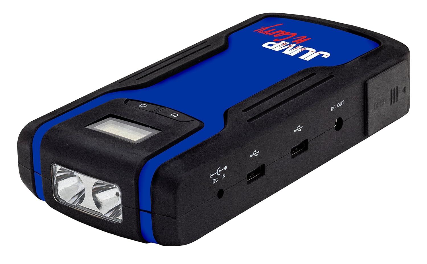

The Jump-N-Carry starters from Clore Industries look like decent products. They caught my eye earlier when searching around.
I think the JNC311 model (500amp) will be robust enough for my needs. It's still beefier in size compared to smaller foot print models like the DBPower 600A starter but closer to the Noco Genius Boost line (400amp). Also has longer cables at 17" compared to 4-6" for the other models. Noco has 14" cables.

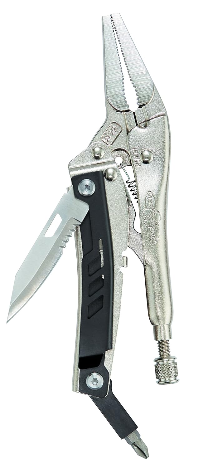

You don't want to have to carry a full set of tools in every car.  But that little Vise Grip tool does everything that I need to plug a tire, change a battery, and hopefully I will never need to find out how more more it can do.  I can only imagine how it could come in handy with things like hose clamps, and other odd sized bolts that I can lock the teeth onto.

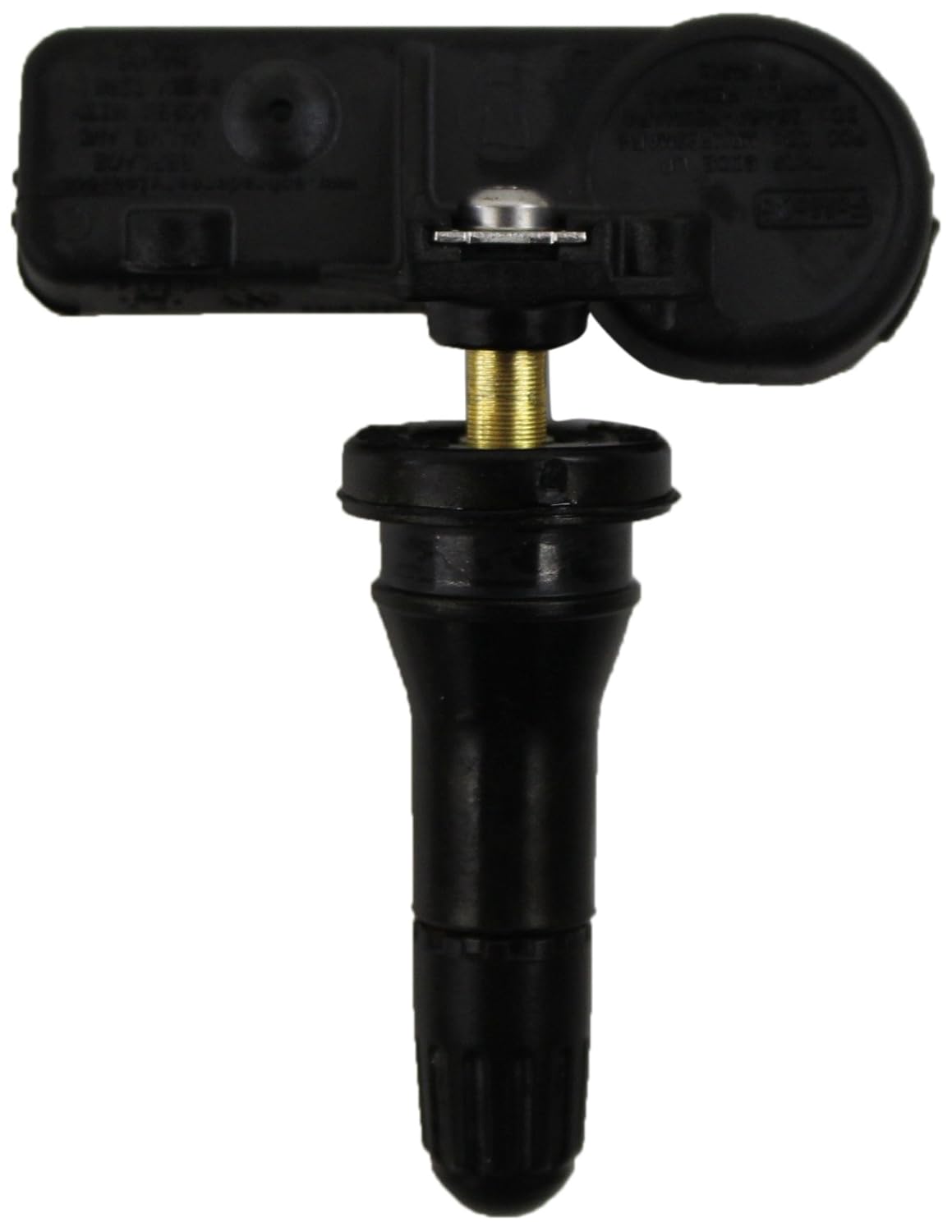

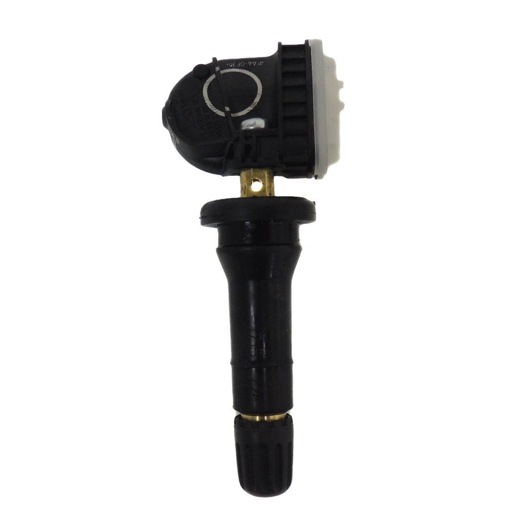

Don't want to slime up a TPMS sensor but those cord plugs work well.

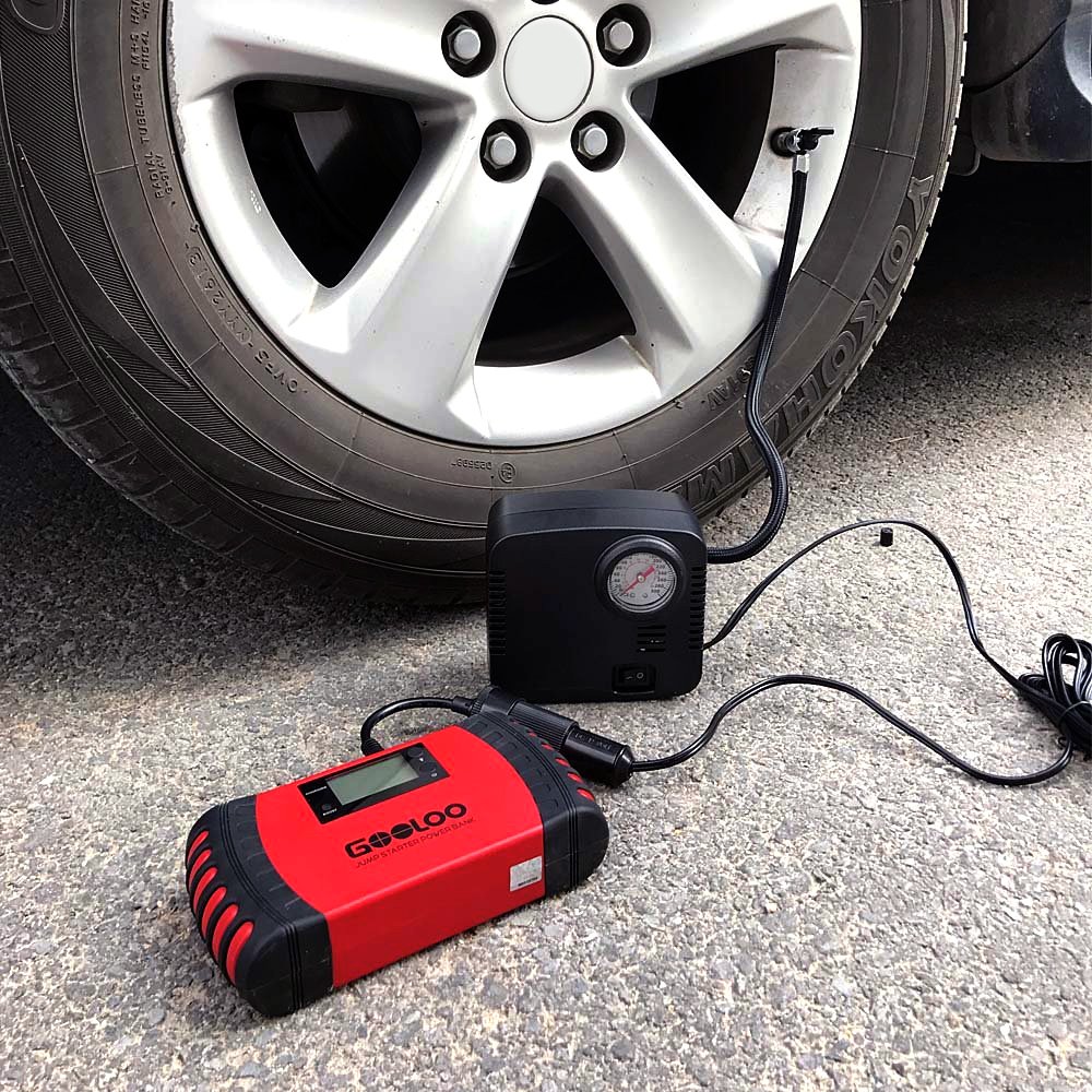

Getting back to battery jump starters, I got the GB40 and it looks like a decent unit. Well packaged and the actual brick isn't too big. The cables seem beefy enough.
I'm a bit confused about the 12V output port though. I also got an EC5 to cig adapter socket (link below) with the intent of being able to using the battery pack to run a tire inflator or other 12v devices remotely. I thought the EC5 connector was a standard on these jump starters. I was wrong. The adapter doesn't mate with the GB40. Anyone know what type of connector that is?
https://www.amazon.com/LOTUS-POWER-Cigarette-Lighter-Adaptor/dp/B019IFHLAE
Second question is can you even connect a 12V load, other than a battery, to this jump starter? I tried to connect a new LED light to test the intensity using the jump cables and it didn't work. Maybe I was doing something wrong or this jump starter has some sensing technology that prevents you from doing something like that. I had some other wiring between the LED and the jump starter so that could have been the problem. Didn't try it direct yet but scratching my head. Thanks!

Thanks Don for finding that out. Appreciate the help. I do remember reading that and I tried the button but was rushed in my attempt. I'll give it another try and go direct to the light this time. I'll report back on my results.
I think that NOCO engineered their jump starters to only work as a jump starter.  Otherwise, they would sell you all of those attachments and accessories.
Thanks for the info on the EC5 cigarette lighter adapter.  Now I will inflate my tires the old fashion way.

Pricing aside, anyone in the market for something like this should consider what their needs are.
Your car's battery could be 600A - 800A.  So something small, light, inexpensive, 400A & under may not work.
The Antigravity Micro Start is 600A.  The GB40 is 1000A.  The GB150 is 4000A.
Not to say that those small units don't have a purpose.  If you need to jump start a Barbie car or charge a cell phone........
Looking at the TPMS sensor/valve stem combinations, it looks like Fix-A-Flat would not be a good idea.  It would probably still work to plug a small leak and get you off the side of the road on a dark & stormy night.  But Fix-A-Flat & Slime would probably damage your sensors.  And let's just say it worked, and your sensors did not get fouled.  The tire tech will still insist on selling, installing, and reprogramming a new TPMS sensor because they can get more money out of you that way.
