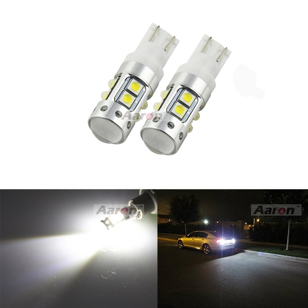

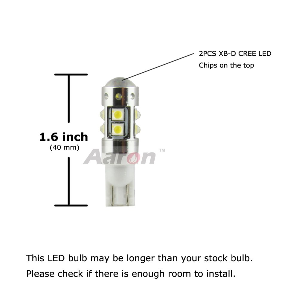

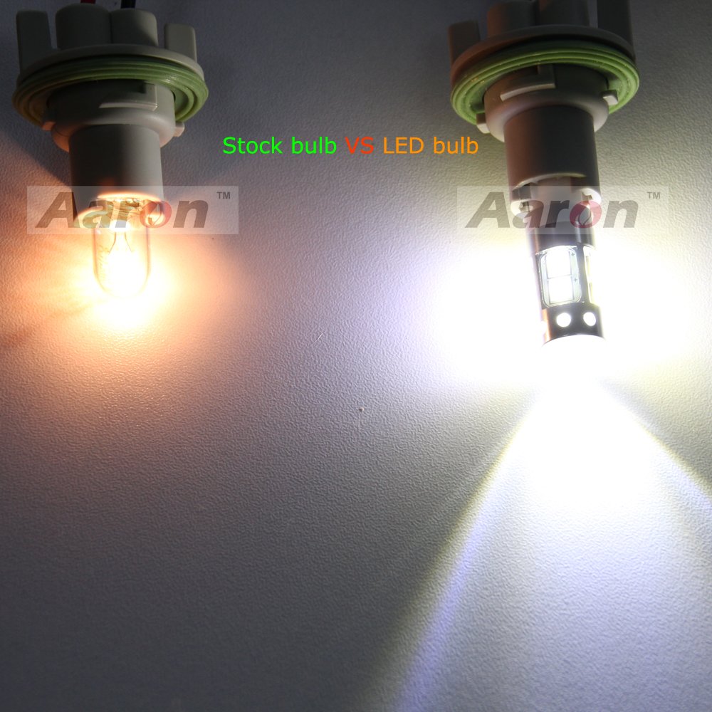

Fifty150 Posted October 4, 2016 Share Posted October 4, 2016 (edited) My solution was just to install an LED lamp. The OEM lamp uses 5 watts of electricity. Hardly enough to drain your battery. If that little lamp drains your electrical system, then you've got bigger problems than a lamp that stays on for 10 seconds. The LED replacement which I chose uses only 2 watts. 2PCS Aaron Pure White T10 T15 192 168 921 194 W5W 50W LED Bulbs Extremely Bright Great update for DRL Backup Reverse Side Marker Lights by Aaron 4.7 out of 5 stars 11 customer reviews Price: $18.99 | FREE One-Day Delivered tomorrow for FREE with qualifying orders over $35. Details In Stock. Want it tomorrow, Oct. 5? Order within 56 mins and choose One-Day Shipping at checkout. Details Sold by ARTR(AaronCarLED) and Fulfilled by Amazon. Package include: 2Pcs (1 Pair) Aaron T10 50W Pure White LED Bulbs Working Voltage: 12V-24V Length: 1.57 inch (40 mm) Maybe longer than stock bulbs. Application: Side Marker Reverse Back up light Lumen: 500 each bulb. Power consumption: 2W each bulb. Edited October 4, 2016 by Fifty150 Quote Link to comment Share on other sites More sharing options...
