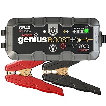

Fifty150 Posted May 14, 2018 Share Posted May 14, 2018 I have cables like that. Used them with my old Jeep. Left them on the Jeep when I sold it. 20/20 hindsight tells me I should have removed them and kept them for myself. Although I don't recall those cables being that expensive. I guess pricing and availability depends on where you source them from, and at what level of the food chain. I also used to carry a big jumpstart pack. Those worked real well. Now, I use a small lithium battery version which is just slightly bigger than a phone, and smaller than a tablet computer. Quote Link to comment Share on other sites More sharing options...
