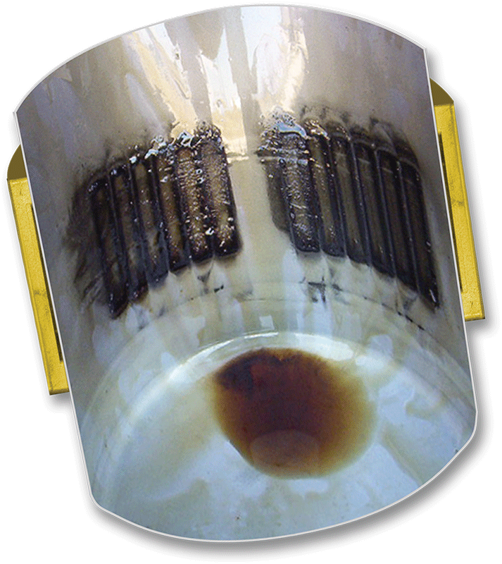

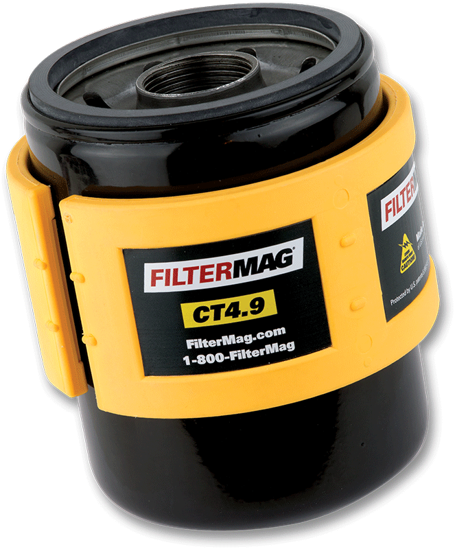

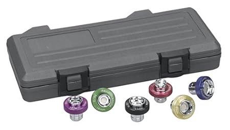

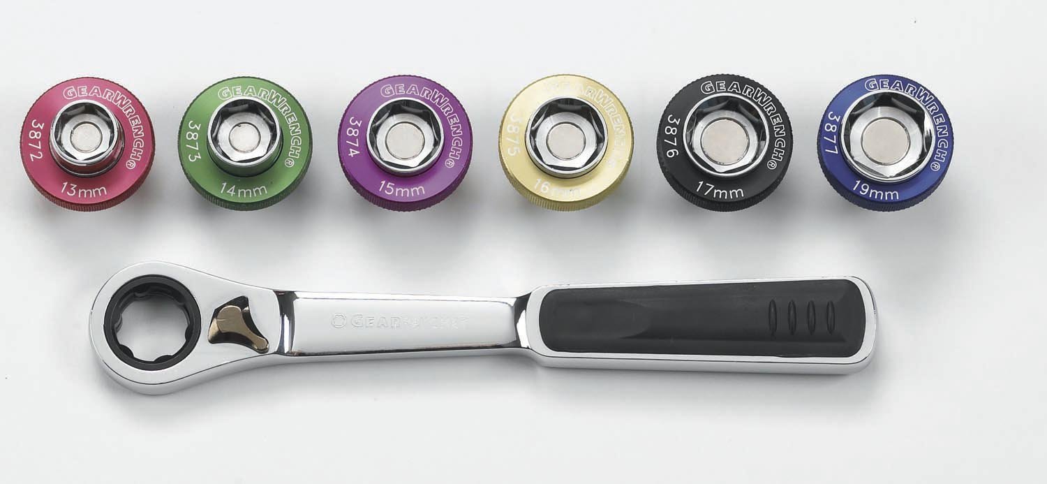

Prairie Pyro Posted September 15, 2016 Share Posted September 15, 2016 Gearwrench makes a nice ratchet. Have been using a donut magnet on filters for over thirtyfive years. Just stick it on the bottom and cut the filter open to see if any issues. Father was a oil rep for a very old company and liked sythetics when they started going for longer intervals. Is the oil change monitor like on some Chevys in that it measures cold starts more than miles? operating engineer O/O 1 Quote Link to comment Share on other sites More sharing options...
G B L Posted September 15, 2016 Share Posted September 15, 2016 The engine oil and filter debate has more than one acceptable answer. The one thing that is very clear, is the oil being used in the engine with the filter magnet is not good! Quote Link to comment Share on other sites More sharing options...

mrtn Posted September 16, 2016 Share Posted September 16, 2016 You don't want metal shavings fixed in the oil filter. A magnetic oil drain plug works just fine. It gathers the junk in the very bottom of the oil pan and draining the oil will remove all loose metal particles. You can just wipe the plug clean and refit. operating engineer O/O 1 Quote Link to comment Share on other sites More sharing options...
