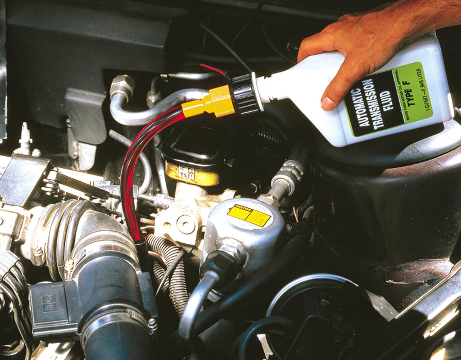

Beta Don Posted January 8, 2019 Share Posted January 8, 2019 15 hours ago, Fifty150 said: Drive until your transmission fluid is warmed up, then check the level with the fill plug. Add fluid until it starts coming out of the fill plug. "Fill plug"?? You fill it from the breather vent on the top of the trans It would be nigh on to impossible to add any fluid at that side port you're calling the 'fill plug' - The only function of that hole in the trans case is to check the fluid level - Make sure then engine is running, in Park and your van is level both fore and aft and side to side when checking the level It's not impossible to do a fairly complete flush - It just takes lots of fluid. I got about a 95% change using 16 quarts when I flushed mine using Castrol full synthetic at 25,000 miles. Now the plan is to drain and refill 4 quarts every oil change . . . . and check the level every time Don Quote Link to comment Share on other sites More sharing options...
Fifty150 Posted January 9, 2019 Share Posted January 9, 2019 Girlfriend has smaller hands. Make girlfriend crawl under ven, and insert tube into fill plug. I will turn the bottle upside down, until she screams that fluid is spilling out of hole. Quote Link to comment Share on other sites More sharing options...

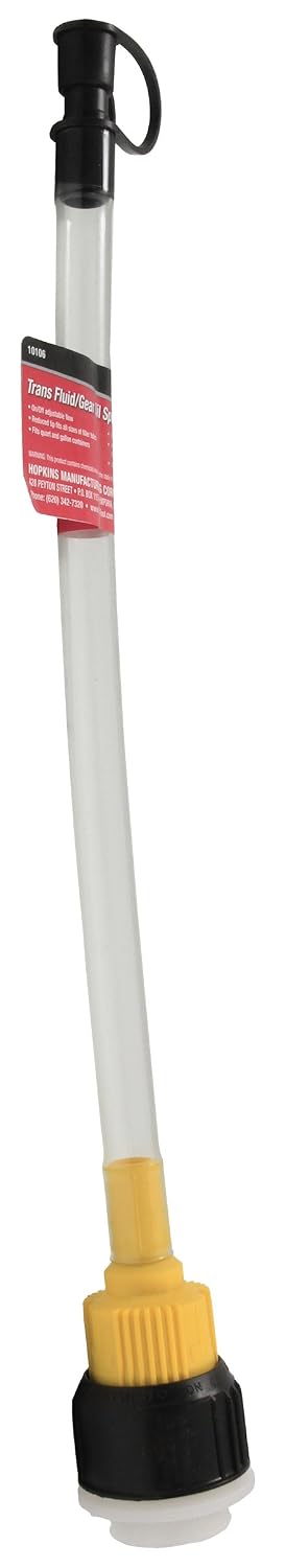

G B L Posted January 9, 2019 Share Posted January 9, 2019 Here again is the post I did on changing the Trans Fluid . I have done this 3 times so far. Posted September 25, 2016 Here is the post I did on the Transmission Change. The hardest part of this operation will be getting the TC Jacked up. Should be almost level . Remove the Under body dust shield . Look for the Drain Plug. 11 mm or 7/16 wrench. ] This style funnel will slide down into the Vent plug you just removed Put 3 quarts of fluid in [attacjpg] ] Run the TC for 5 to 10 minutes . Then drain the fluid again. Repeat this 2 more times You have Now used 9 quarts of fluid. Put the Drain plug back in make it snug this time. Add 3 quarts of fluid You have now used 12 quarts. Go under the car and Look for the indicator plug (14 mm wrench) Loosen the plug. Do not remove yet Start the engine with the engine running and the Car in park pull the plug and add fluid into the funnel until it just drips out the Indicator hole Replace plug put the Dust shield on , Pull the funnel and replace the vent cap. Total Fluid 13 Qts. With most of number 13 left There is no filter to change on this operation and the type of fluid is Mercon LV. Have fun! 4 herb, mrtn, T0ASTERvan and 1 other reacted to this Quote Link to comment Share on other sites More sharing options...
