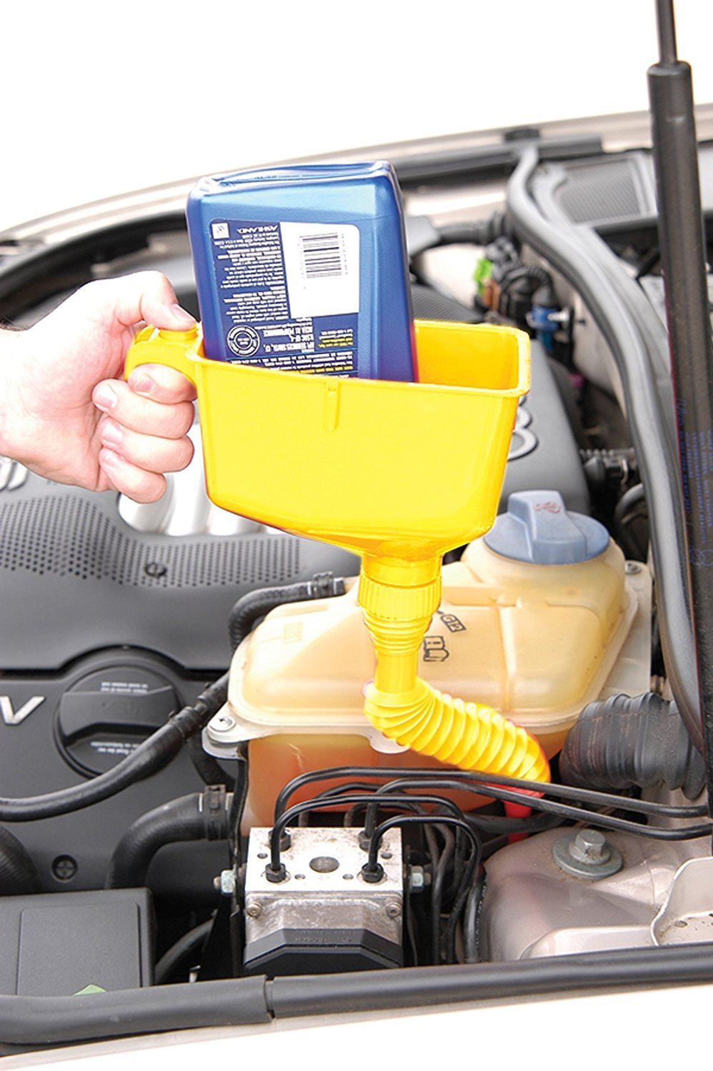

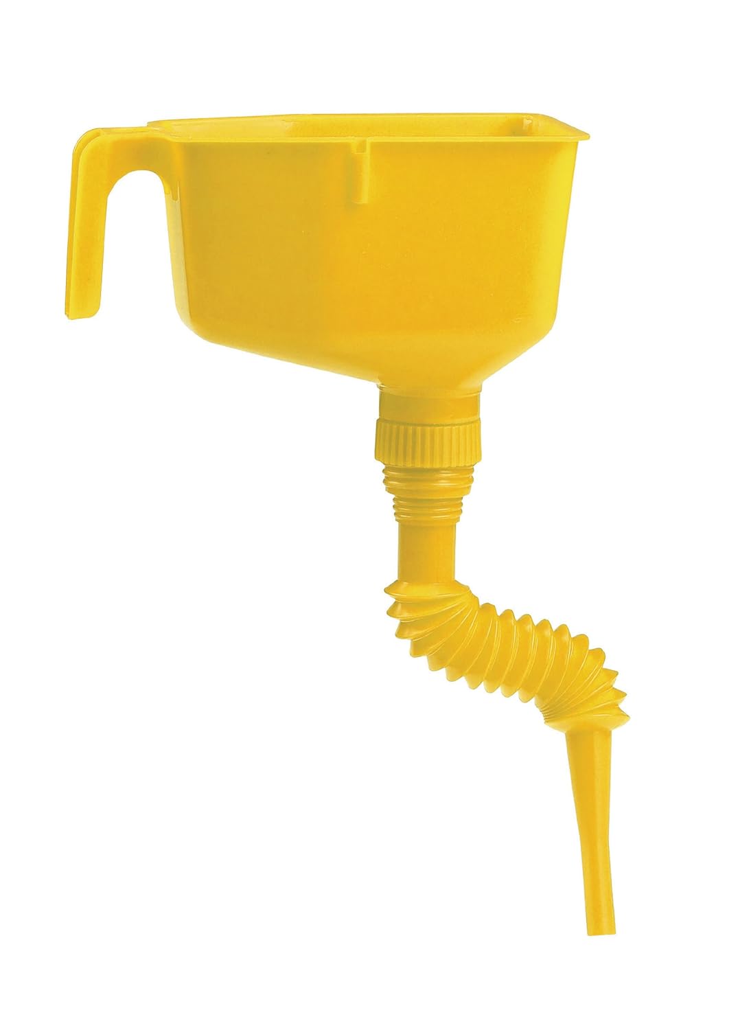

Fifty150 Posted June 25, 2018 Author Share Posted June 25, 2018 On 5/29/2018 at 12:57 AM, Fifty150 said: On 6/16/2017 at 3:29 PM, Beta Don said: Very first oil change! The oil fill cap on the 2.5 is in a bit of an odd place, to say the least. It's back under the lip of the vent system which means you'll need to custom cut a funnel so you can get it in there. Eureka! The right funnel for Transit Connect oil changes. Quote Link to comment Share on other sites More sharing options...
Fifty150 Posted June 25, 2018 Author Share Posted June 25, 2018 Quote Link to comment Share on other sites More sharing options...
