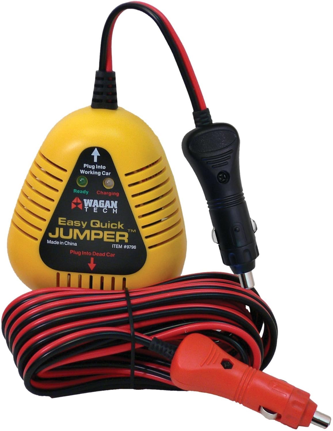

The 12 volt cigarette lighter style power outlet between the front seats is always hot on my Gen2.  Over the years, I've seen a lot of odd things in truck stops.  Not just Lot Lizards, but things you might actually want to buy.  I recall seeing devices which allowed you to plug into a cigarette lighter, which allowed for boosting the battery and/or jump starting the car.  I also recall seeing car-to-car cigarette lighter booster cables.
Read the reviews on that piece of junk  -  33% of them are 1 star.  It claims is puts 5 amps into the dead battery, which is just shy of what a typical 6 amp battery charger does.  I kinda doubt all 5 of those amps actually get there, considering the tiny wire gauge and the length of the wire
You're probably right.  I don't own one.  I just recall seeing those in truck stops as I traveled.  But there are probably similar devices.  I also recall that some of those lithium battery jump start packs have attachments which are suppose to feed power into the car via the cigarette lighter port.  I wonder how well those work.
