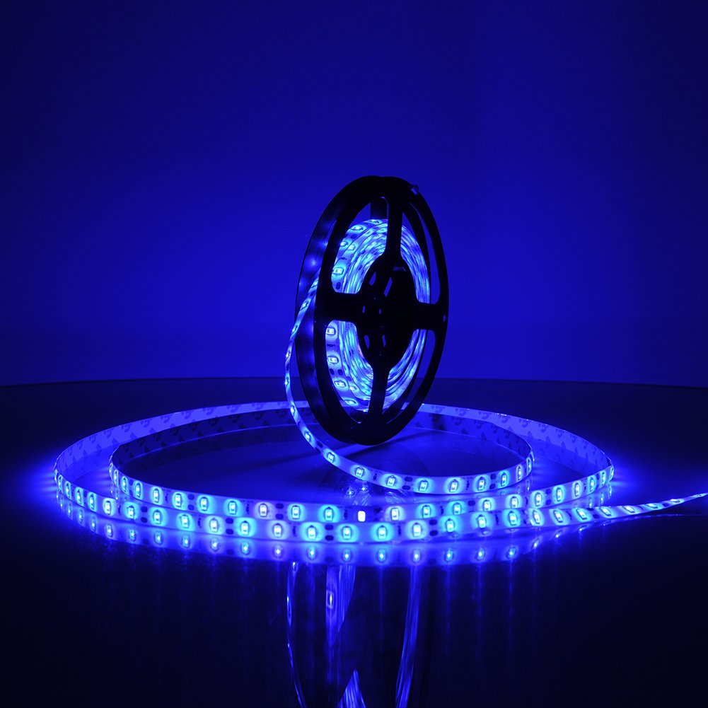

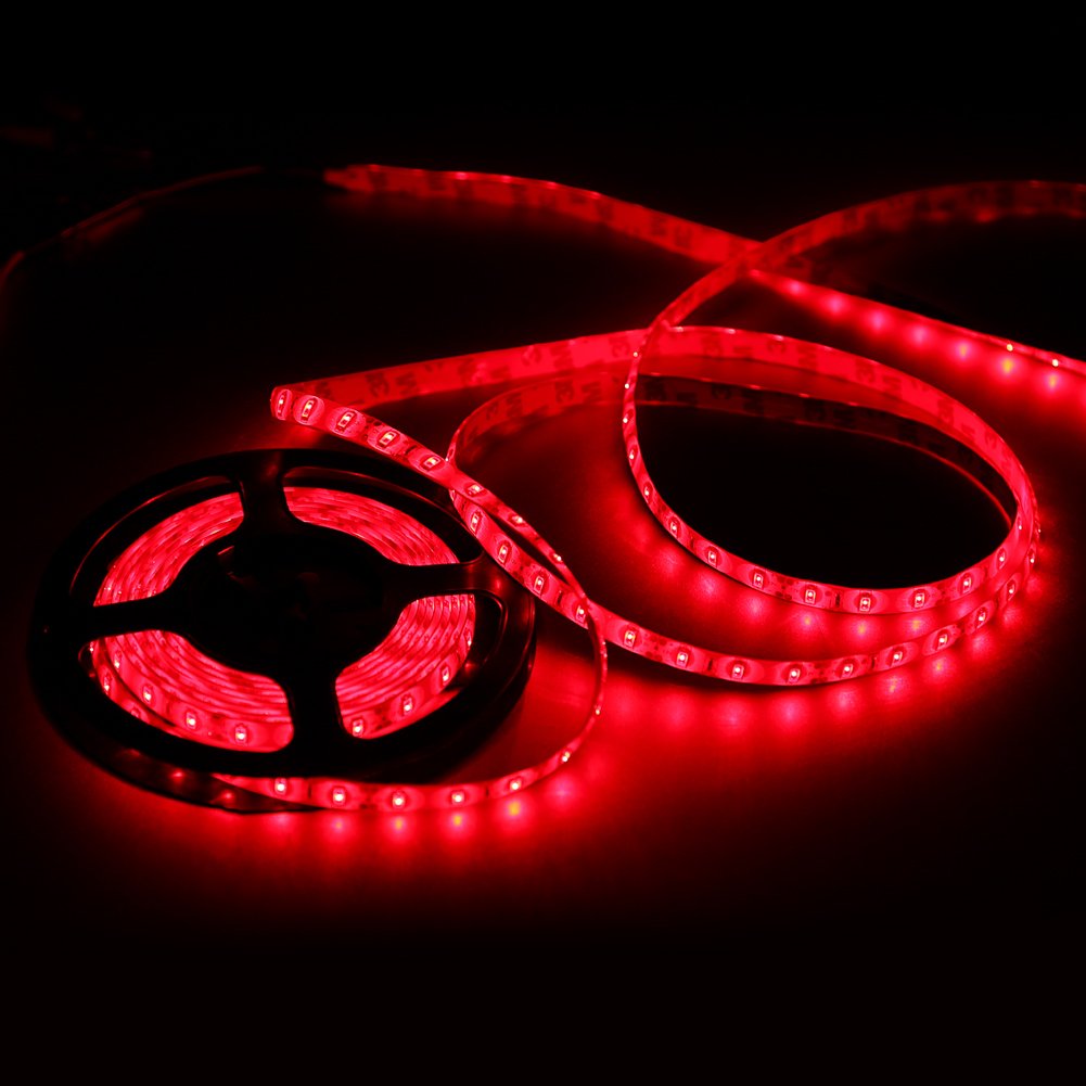

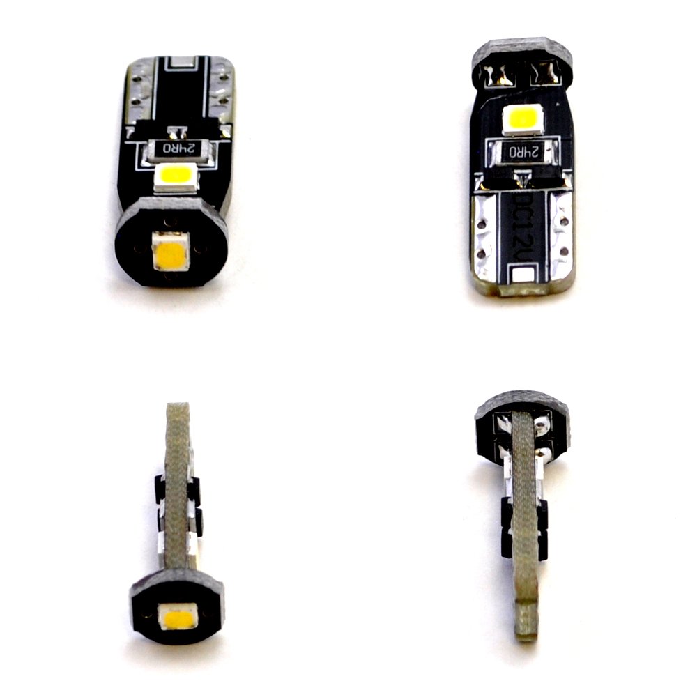

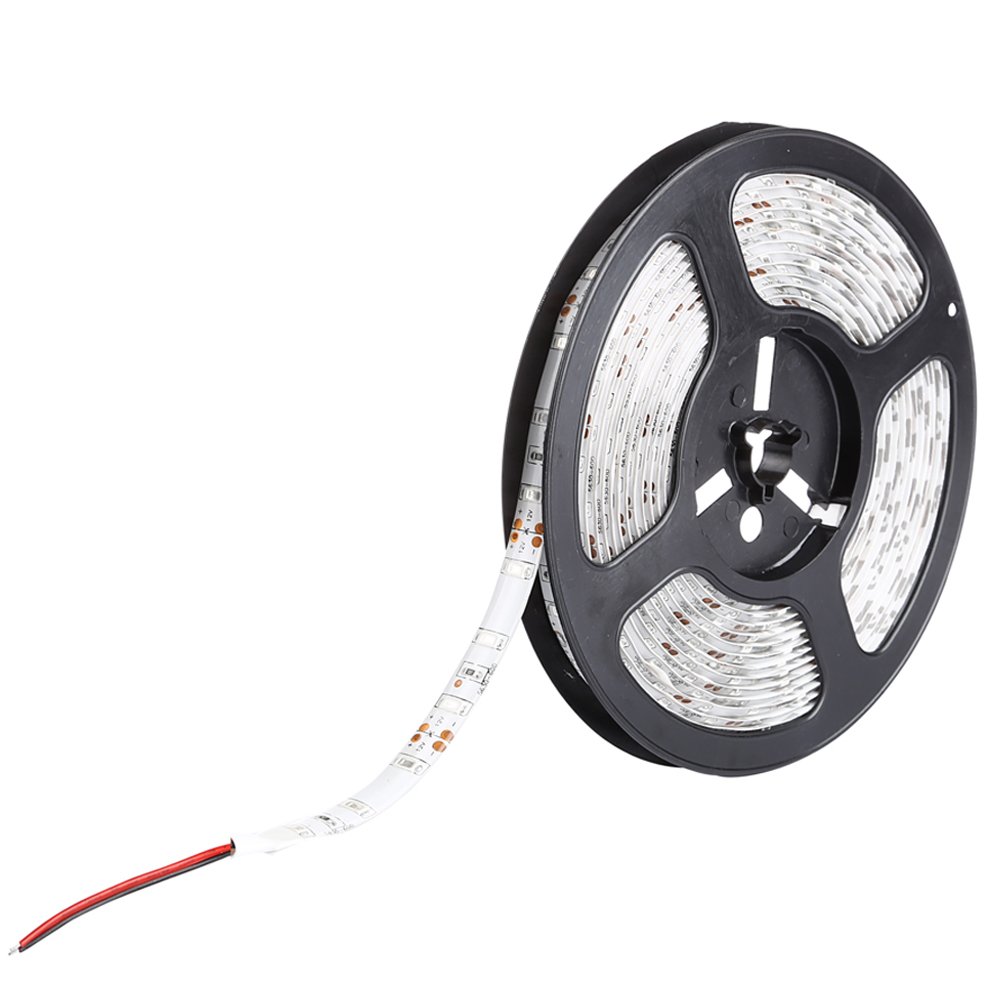

Fifty150 Posted September 25, 2017 Share Posted September 25, 2017 On 9/23/2017 at 10:18 AM, Tiller said: the stock interior lights pretty much suck. Replace them with LED lamps. It will make a big difference. I replaced all of mine with red LED, to preserve night vision, and gives the interior more of a 70's shagging wagon ambiance. You could also pick up a couple of 5 meter LED light strips in any color that you want, and just run them on the same circuit as your existing interior lamps. https://smile.amazon.com/gp/product/B0145YY9IU/ref=oh_aui_detailpage_o09_s02?ie=UTF8&th=1 Quote Link to comment Share on other sites More sharing options...
Fifty150 Posted September 25, 2017 Share Posted September 25, 2017 https://smile.amazon.com/SiriusLED-Extremely-Chipset-Interior-Courtesy/dp/B0186P1MUW/ref=sr_1_cc_1?s=aps&ie=UTF8&qid=1506313665&sr=1-1-catcorr&keywords=w5w+3030+led Quote Link to comment Share on other sites More sharing options...

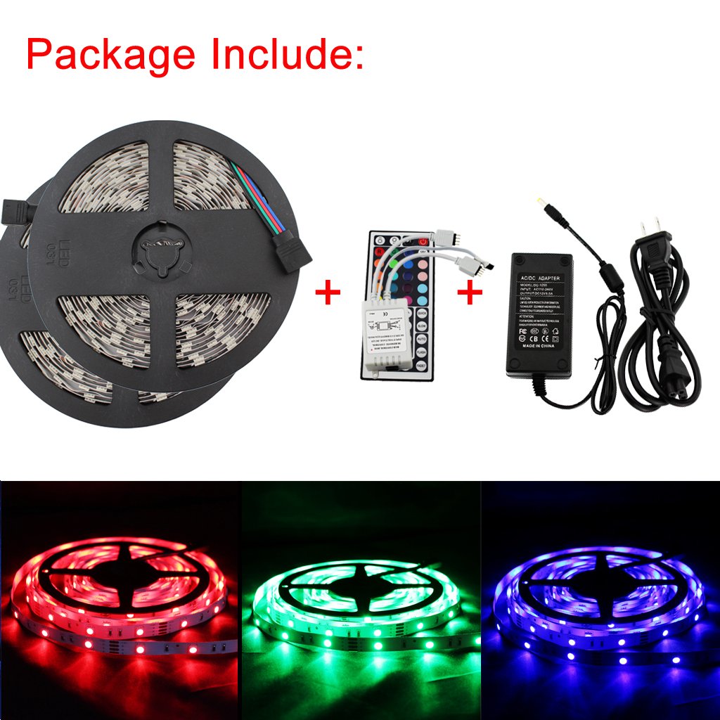

jrm223 Posted September 25, 2017 Share Posted September 25, 2017 ^ Even better for the LED rope lights is get the RGB ones so you can pick & choose your color randomly - or even strobe if you're at a party somewhere, haha. Quote Link to comment Share on other sites More sharing options...
Fifty150 Posted September 26, 2017 Share Posted September 26, 2017 A lot of those RGB sets come with a remote control for your "party in the back". Quote Link to comment Share on other sites More sharing options...
Tiller Posted September 30, 2017 Author Share Posted September 30, 2017 I've had the LED strip lights for months now, in both blue and white. I just haven't gotten them installed yet. Time.. time.. time... I probably won't screw with headlights at this time. No overpowering reason to spend the money right now. i will wait until a bulb blows out and it needs replacing. Unless for some reason I start having electrical issues and need to lower the overall draw on the system. But I'm not seeing any now. I'd rather spend the money on off-road lights to mount on the roof rack rail and mount the switches on that panel on the dash. I have pulled the panel and found that once it's removed, if I remove the two rear clips from the panel and reinstall it, it is much easier to remove. The fit still seems fine and I'm not getting any additional noise or vibration from having done so. I've got about 1000 miles on it now since I removed the rear two clips and no issues. Once I get the switches in and fully wired, and I don't see a future need to access the panel very often, I'll reinstall the rear clips again. Quote Link to comment Share on other sites More sharing options...

Fifty150 Posted October 5, 2017 Share Posted October 5, 2017 Those strip lights can also be wired up to strobe. Then you can mount them on the windshield and back window for warning lights. Quote Link to comment Share on other sites More sharing options...
Tiller Posted November 1, 2017 Author Share Posted November 1, 2017 On 10/3/2017 at 1:27 PM, FTCOne said: Tiller - Based on these posts, it sounds like you have the Panoramic glass. I have been considering putting the LED light strips on the black edges around the glass but above the shade. Then they are hidden from view, but could add some nice lighting at night, which is when i typically have the shade open. I keep it closed during the day, too much sun and heat... That's a good idea. I'll have to look at that. I never thought of that. It would be nice when sleeping in the TC to have overhead lights. I'll check that out. Thanks! Tiller Quote Link to comment Share on other sites More sharing options...
