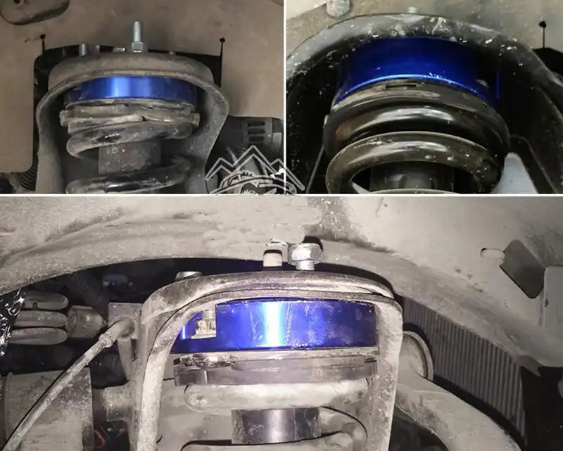

REI_Grande Posted January 24, 2020 Share Posted January 24, 2020 (edited) I messaged a company in Russia last year and they replied the other day that they completed their 2014+ Connect lift kit. It's up to 30mm in the front and 40mm in the rear. https://www.ebay.com/sch/m.html?_ssn=tema4x4&LH_PrefLoc=&_from=R40&_trksid=p2499338.m570.l1313.TR12.TRC2.A0.H0.Xtransit%20connet.TRS0&_nkw=transit%20connet&_sacat=0&fbclid=IwAR2tjdyyBHboHEuKqtCMZ12LXQ0SiG-Mg4mDRcUh68Z1CZK7dxm-ELk9y5I Edited January 24, 2020 by REI_Grande Quote Link to comment Share on other sites More sharing options...
JustinVP Posted February 2, 2020 Share Posted February 2, 2020 (edited) On 1/24/2020 at 8:21 AM, REI_Grande said: I messaged a company in Russia last year and they replied the other day that they completed their 2014+ Connect lift kit. It's up to 30mm in the front and 40mm in the rear. https://www.ebay.com/sch/m.html?_ssn=tema4x4&LH_PrefLoc=&_from=R40&_trksid=p2499338.m570.l1313.TR12.TRC2.A0.H0.Xtransit%20connet.TRS0&_nkw=transit%20connet&_sacat=0&fbclid=IwAR2tjdyyBHboHEuKqtCMZ12LXQ0SiG-Mg4mDRcUh68Z1CZK7dxm-ELk9y5I I just pulled the trigger on this. 30mm front and rear. Feels odd buying stuff from Russia, but it’s a known company, soooo.... Shipping is up to 2 months!?! Since I killed a tire on a forest road, I’m going with the bigger 215/65r16 Geolandars, going on this week (been on spare for a while). That gives me .8” extra clearance, plus the 1.2”/30mm from the spacers I get 2” more, which should be enough to feel confident on the cobble and crap that sometimes need to straddle on logging roads. I’ll post before and after pics... in a few months once the spacers actually arrive. On that note, any idea how the rear spacers go on? If I’m lucky, they’ll have install instructions in English. Front is easy, just drop the struts and sandwich the spacers in. I’ll probably also buy my own grade 10 bolts, don’t trust the Russia ones. Rear I’m hoping I don’t need a spring compressor. Edited February 3, 2020 by JustinVP Quote Link to comment Share on other sites More sharing options...

JustinVP Posted March 1, 2020 Share Posted March 1, 2020 (edited) I went for it, and got the front 30mm lift done, plus larger Geolandar 215 65/r16 tires. I haven't yet done the rear, my cheap 2-rod-style spring compressors couldn't do the job due to access. I might have the local shop do it when I get an alignment. It actually measures dead-nuts-level unloaded with just the front lift. I've got some stuff in the back in this pic, but only ~150 lbs including bike rack. I'll definitely do the rear lift one way or the other. Don't want it saggy when I have 3 MTBs on the back plus all my work event stuff inside. Here's the Russian Ebay kit I bought from Tema 4x4 (thanks REI_Grande!). Made of rubber, not plastic, so I hope the front spacers hold up over time. Getting the wiper arms off to access strut bolts is a PITA. Needed to clamp the puller together otherwise the dogs would pop off. The basic Amazon special puller sucks for the job, it really doesn't open far enough, I had to modd it plus used big C-clamp like below, so use something beefier. Removing the passenger side strut on this required a lot of force. The axle bottoms on a metal frame piece (where circled), and you have to push hard, which made me nervous. It eventually slid out of the steering knuckle (slid = hammering on it with 2x2 piece of lumber/2 lb hammer). Driver's side has a lot more room for the axle to move, and was 10x easier. I put the pinch bolts in through the "wrong side" (at end of yellow line) to squeeze open the joint since I didn't have the special tool for this. Worked great. Given the lack of room even stock, the only way to put struts back in with 30mm spacers was to compress the springs. Once I cut some pipe as spacers so the compressor rods wouldn't hit the top of the strut towers, it was relatively easy, though very tight. In hindsight, I'd probably compress the non-drive spring to get the stock strut off without levering so much force on the axle/CV joint. Went back together nicely. Even the brake lines and ABS wire mount went back in with enough room to bend at topout. A couple hundred miles and a bunch of logging roads later, I'm thrilled with the fronts and the awesome Yokohama tires. I'm not 100% sold on the spring spacers for the rear, possible spring bind at full compression? I come from the mountain bike world, so worry about stuff like that. I'd prefer an air assist shock or spring assist shock for the back, but haven't found any that are direct fit. We'll see how much the shop wants to install the rear spacers. Should be less than an hour of labor with a good one-sided commercial spring compressor - but we all know how these odd mods go, so we'll see. Edited March 1, 2020 by JustinVP Quote Link to comment Share on other sites More sharing options...
Fifty150 Posted March 2, 2020 Share Posted March 2, 2020 7 hours ago, JustinVP said: A couple hundred miles and a bunch of logging roads later, Any noticeable ride quality change? How does the handling feel? From personal experience, spring spacers like that are a little bumpier. While nothing is going to last forever, spring spacers tend to cause extra wear on related suspension and steering components. With trucks & Jeeps, the spacers tend to change the angles of fitment for other parts; which is why some people opt for suspension lifts. But as they say, if I have 20 years of experience, then I'm only relating to technology which is 20 years old. And there is no over-the-counter suspension lift available, so it's not a worthwhile speculation. With the rear end, do you think there's a way to incorporate air bags? Quote Link to comment Share on other sites More sharing options...

JustinVP Posted March 2, 2020 Share Posted March 2, 2020 10 hours ago, Fifty150 said: Any noticeable ride quality change? How does the handling feel? The 65 vs stock 55 series tires made it feel a lot less responsive cornering (loved the stock handling of this thing), quieter on insanely rough/loud Seattle freeways, much smoother over broken concrete (aka our streets), and way, way better on logging roads. Basically what you'd expect on a taller sidewall tire. I drove these for a few weeks before installing front spacers. I could tell no difference in handling once the 30mm spacers went in, though I'm sure you'd notice something if on stock tires. Quieter again, if anything, which could be the rubber spacer isolating the struts from the metal body of the van. I get that there will be increased wear on CV's, etc., but 30mm is pretty modest and the angles looked reasonable after install. The amount I pay in CV and front end work will be saved by not peeling open the underside like a popcan on those ridges of cobble that like to stick up from the center of logging roads. @jrm223 Good info on the wiper arms! I put them back on with anti-seize, which should also make it easier. I'm looking to keep this fairly low cost, so no welding or bags. I'll probably do the rear spacers, if the shop wants $$ I'm sure I can find better spring compressor to rent somewhere. jrm223 1 Quote Link to comment Share on other sites More sharing options...

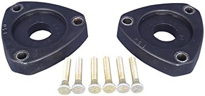

jrm223 Posted March 2, 2020 Share Posted March 2, 2020 4 hours ago, JustinVP said: could be the rubber spacer isolating the struts from the metal body of the van. I forgot to comment on that before - I see what look to be three steel sleeves in the front lift spacers, so they should hold up fine & not cause sloppy handling or anything like that. Quote Link to comment Share on other sites More sharing options...
JustinVP Posted March 16, 2020 Share Posted March 16, 2020 On 3/2/2020 at 2:20 PM, jrm223 said: I forgot to comment on that before - I see what look to be three steel sleeves in the front lift spacers, so they should hold up fine & not cause sloppy handling or anything like that. Negative, Captain. Looks like it, but they're just molding marks. jrm223 1 Quote Link to comment Share on other sites More sharing options...
