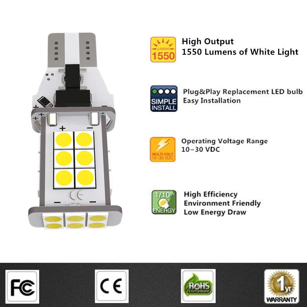

Fifty150 Posted November 24, 2017 Share Posted November 24, 2017 The Philips and the Sylvania are the best built, and have the best warranty. They are some of the most expensive. But that does not make them the brightest. The brighter lamps will be the ones sold by a Chinese company, and fulfilled by Amazon. https://www.amazon.com/LUYED-Extremely-Chipsets-Reverse-Brightest/dp/B01LX4FMD1/ref=sr_1_3?s=automotive&ie=UTF8&qid=1511500193&sr=1-3&keywords=w16w+3030 windguy 1 Quote Link to comment Share on other sites More sharing options...
Don Ridley Posted November 24, 2017 Share Posted November 24, 2017 Yes, those are the back-up bulbs. A note on LEDs: I have found the cheap Amazon/Chinese T10 LEDs have short lives when used frequently. The LED substrate in these products breaks down when heated. I have re-replaced almost all of the cheap ones in the interior with Phillips. Hopefully they last longer. The cheap ones lasted less than a year. At least the experiment only cost about $15. Quote Link to comment Share on other sites More sharing options...

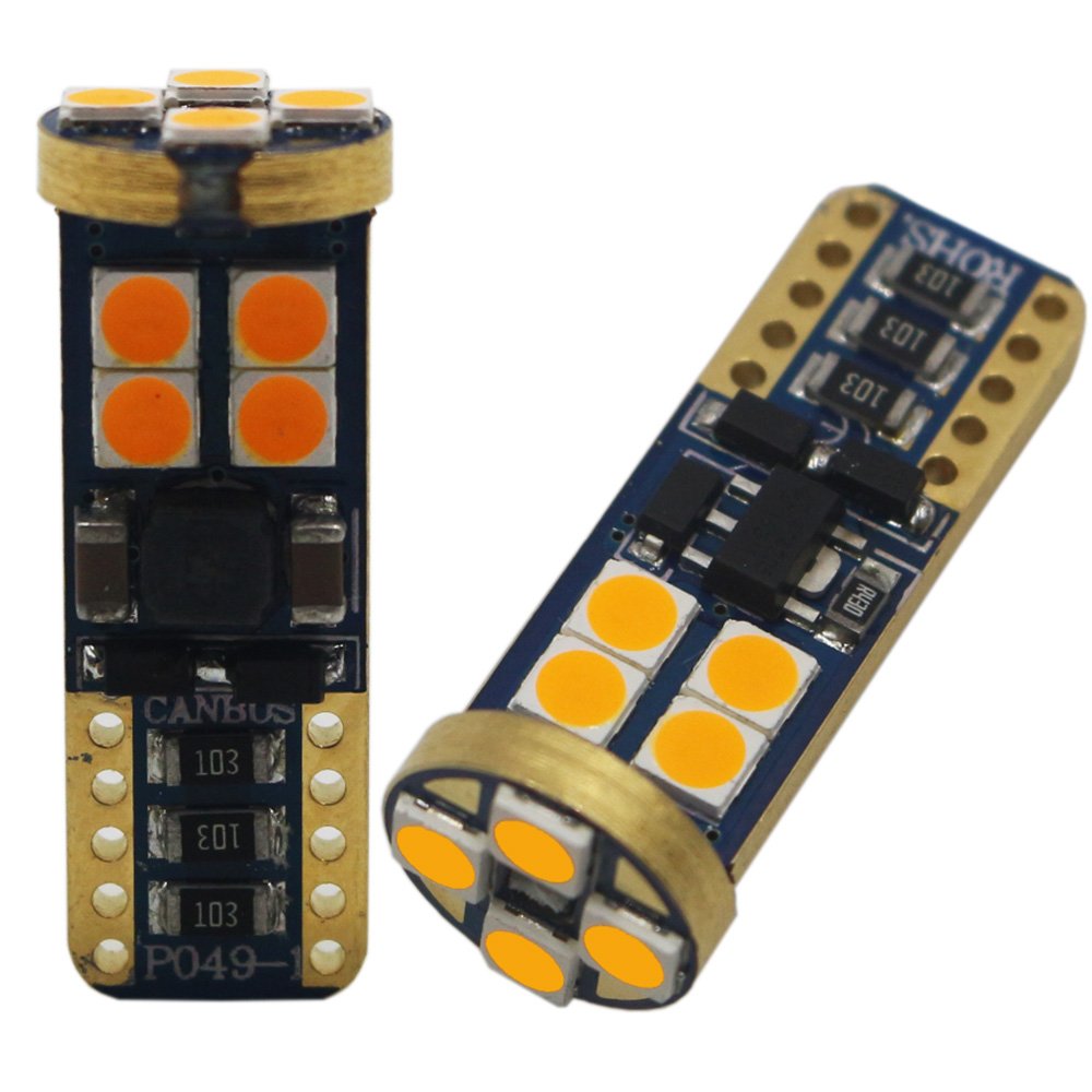

Fifty150 Posted November 24, 2017 Share Posted November 24, 2017 For the exterior parking lamps, that stay on all the time when the headlights are on, I like this style: Quote Link to comment Share on other sites More sharing options...
windguy Posted November 24, 2017 Author Share Posted November 24, 2017 Thanks for the input on the LED options. Good to know if I decide to replace other bulbs with LEDs in the future. For the backup light, it doesn't stay on very long so my preference is for max light output that's directed outward and not so much longevity. Quote Link to comment Share on other sites More sharing options...

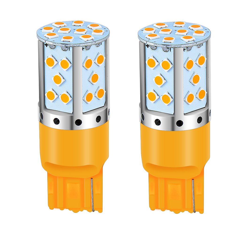

Fifty150 Posted November 25, 2017 Share Posted November 25, 2017 WindGuy, Once you go through the trouble of taking the rear lamp housing off, even though it''s only 2 screws, you might as well switch out all of the lights. These worked for my rear turn signals. No hyperflash. Plug and play. Quote Link to comment Share on other sites More sharing options...
windguy Posted November 25, 2017 Author Share Posted November 25, 2017 On 11/25/2017 at 2:43 AM, Fifty150 said: WindGuy, Once you go through the trouble of taking the rear lamp housing off, even though it''s only 2 screws, you might as well switch out all of the lights. These worked for my rear turn signals. No hyperflash. Plug and play. Expand Thanks Fifty150 - I'm guessing you don't have a model number but pic only as a a reference. I'd be concerned about startling other drivers with a bright turn signal cause so many drivers around here in SoCa aren't used to seeing them used I think in general the tail lighting is pretty decent on the TC with well positioned and illuminated lights. So many cars have anemic lights you can barely see, scary! Quote Link to comment Share on other sites More sharing options...
Fifty150 Posted November 28, 2017 Share Posted November 28, 2017 https://smile.amazon.com/SUGERYY-Yellow-Lumens-Chipset-blinker/dp/B071JBDTLG/ref=sr_1_22?ie=UTF8&qid=1511860112&sr=8-22&keywords=7440+amber+led Quote Link to comment Share on other sites More sharing options...

Fifty150 Posted November 29, 2017 Share Posted November 29, 2017 On 11/28/2017 at 8:43 PM, jrm223 said: I've also upgraded my rear lighting to all LED. The turn signal bulbs have hyperflash, but it doesn't bother me much since I usually do the "bump" triple-flash. Expand The amber turn signal lights which I use do not hyperflash. There are enough 3030 SMD to draw electricity equivalent to the halogen lamp load. Quote Link to comment Share on other sites More sharing options...
