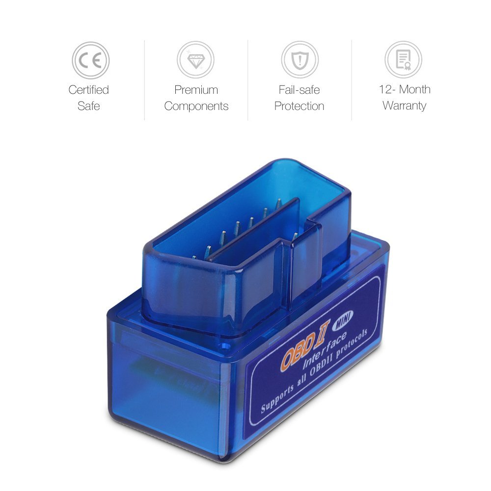

Fifty150 Posted September 23, 2016 Share Posted September 23, 2016 On 9/21/2016 at 3:04 PM, Prairie Pyro said: From looking at the filter and the transmission pan and its pretty simple affair to change on the Gen 1 and I got a Wix filter with gasket for under $18 ttd from Amazon. Only a 3 quart capacity so if the fluid is poor and dirty I can see things going bad pretty fast. If I were to do a change annually my outlay would be around $35+- using a Valvoline Maxlife full synthetic. I wonder if there is a transmission temp monitor that one can monitor via the OSB2 port? Will have to hook up the bluetooth OSB device to the torque app and see. Moving to south TX and heat could be a issue. https://smile.amazon.com/gp/product/B01FZ1JS5Q/ref=oh_aui_detailpage_o05_s00?ie=UTF8&psc=1 Quote Link to comment Share on other sites More sharing options...
Fifty150 Posted September 23, 2016 Share Posted September 23, 2016 On 9/21/2016 at 3:04 PM, Prairie Pyro said: I wonder if there is a transmission temp monitor that one can monitor via the OSB2 port? Will have to hook up the bluetooth OSB device to the torque app and see. mrtn 1 Quote Link to comment Share on other sites More sharing options...

Prairie Pyro Posted September 23, 2016 Share Posted September 23, 2016 (edited) I have a obd2 bluetooth unit and have the torque lite app loaded to a Samsung Tab. Just used it yesterday to clear a evap code after cleaning the fuel cap gasket on a Nissan. Thinking of buying the full version for $5. The picture you showed nothing on tranny? I can get a decent Hyden Harden? fined 15x5x1 cooler kit for $20 so will run with that and change fluids on a regular basis. Edited September 23, 2016 by Prairie Pyro spelling, additional info Quote Link to comment Share on other sites More sharing options...
Fifty150 Posted September 23, 2016 Share Posted September 23, 2016 I believe that the Transmission Temperature is available on the paid $5 version of Torque app. It's only $5. If you get it, keep us up to date on your results. Write a review of the app. Quote Link to comment Share on other sites More sharing options...
