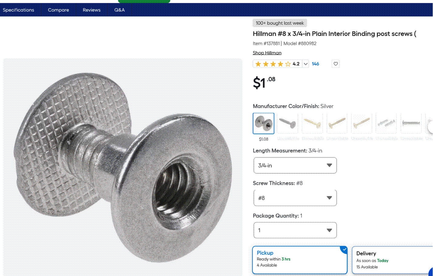

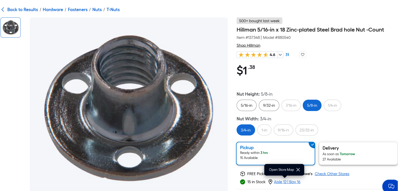

Fastener: What size? I checked Home Depot online but they mostly have tee nuts with teeth. Lowes has an option from Hillman.
Different Nut Heights and Nut widths. See screen shot below. Is this the type of tee nut I should use and what size?
@AdanA use tee nuts that don't have the mounting holes but I realize he had these on hand at work for another application.
@mculbert tee nut appears to have three holes but the pic isn't detailed enough for me to figure that out.

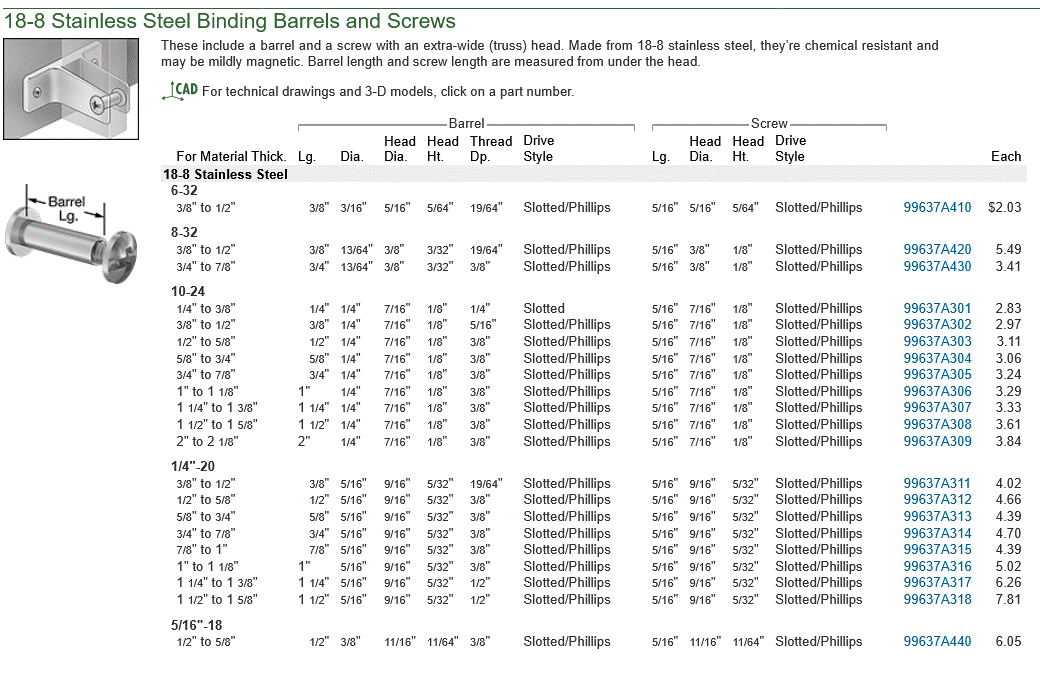

I reread @AdanApost a few times. He calls these fasteners a "BINDING BOLT".
Internet also calls them "BINDING POST & SCREW" and "BINDING BARRELS & SCREW".
The tee nut description from the other post threw me off a bit.
Below are some screen grabs from Lowes and McMaster as an example.
What's interesting is in the reviews of the Lowes option, someone used a pair of the fasteners to fix the visor in their Honda.
@AdanA also mentions the size range of the bolt: 3/4" to start, ending at 5/8" when cinched.
This gives me more info to source the hardware. Will report back.
