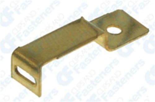

DonShockley 118 Posted Monday at 05:28 AM I'll have to figure out where I put them but I can send you a kit of parts you can use to make a free standing triple fuse block. Here's a photo of how I did mine on my old 2015. That setup sued three individual taps but you could just as easily use one tap for the supply, daisy chain it to all three fuses, use one output for the return line to the original fuse output and the other 2 for extra circuits. Share this post Link to post Share on other sites
