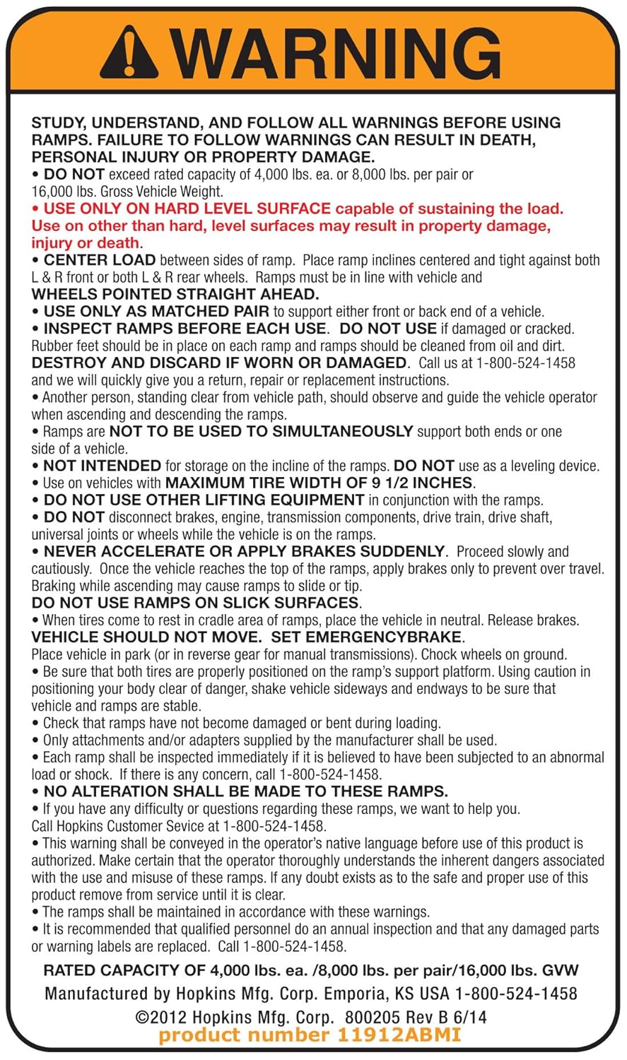

From my understanding, the weight rating is for 2 pairs.  So in theory, if you have four ramps, 1 under each tire, you can support up to the weight rating of 12,000 or 16,000 pounds.  Each ramp, by itself, is suppose to be good for 3,000 or 4,000 lbs.
What I'm thinking is with larger trucks and SUVs, it would be handier to have to ramps with higher weight rating.  I would rather have the heavier rated ramps, than to find myself wishing I did.  The total weight of a truck is a little bit more once you have it loaded, or you have your tools onboard.  Trucks tend to have most the weight in the front end.  Maybe I'm just overthinking or being too cautious.
Please quote a source for your 'understanding'
Why would something sold only in pairs have an actual weight rating of only half what's stamped on the product?  It's my 'understanding' that each ramp will safely support 6,000 pounds, 12,000 for the pair because . . . . that's what's stamped on them
Thanks for posting, Fifty.  It does look like their version of 12,000 pound capacity is . . . . one end of a 12,000 pound vehicle.  Pretty loose interpretation of the English language, IMO
At any rate, whatcha got that weighs in at more than 12K?
Sorry.  My mistake.  I actually did read it wrong.  Fuzzy brainwerks.  I'm punch drunk.  In my mind, I figured that with a 6,000 lb limit, I wouldn't be able to use it on the pickup truck.  Although, with reading and re-reading, I think that the physical difference between the 12,000 lb & 16,000 lb rating, is that one has a wider ramp.  Both appear to be the same height, and the same length, with the same climb angle.
