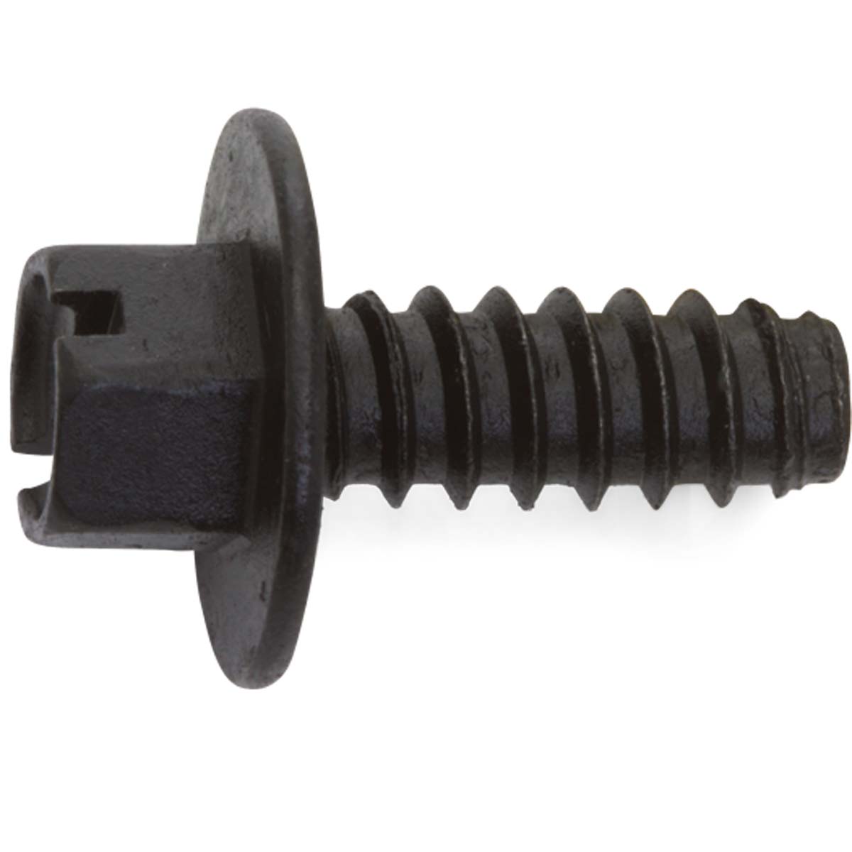

Some vans were delivered from the factory without the screws and bolts for the license plate.
Somebody goes to the parts area, grabs a little plastic packet of 2 screw marked "license bracket screw" and it's not the correct thread pitch.  Ford sells more than 1 part, little plastic packet with 2 screws, for mounting license plates.  Common mistake is that whomever does the new car prep at the dealership, used the wrong screws.    They all look the same.
ford-plate-screws.jpgRelated imageImage result for ford license plate screwsKIMG0041.JPGRelated image
The van door has a hexagon shaped hole, and a special 6 sided rivet nut is installed at the factory in Turkey.
Luckily, this can be corrected.  The parts are available.  It's the same part as HN1 with the red arrow in the below drawing.

Yep.  My plate is screwed to the back of the van using self-drilling sheet metal screws for exactly this reason.  The front plate is screwed on with the wrong screws forced into the plastic mounting bracket.  Neither is going anywhere, and fortunately, neither has to go anywhere until the van is sold sometime in the distant, I hope, future.
