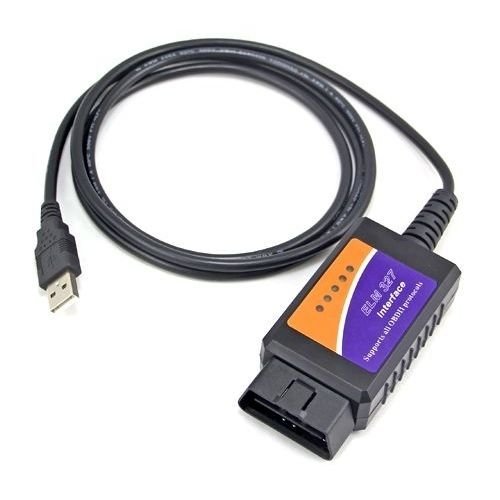

Fifty150 Posted October 7, 2016 Share Posted October 7, 2016 My, we have come a long way. I also have a dash mounted ScanGauge II. Did that about 10 years ago, when it seemed like only dealerships had access to real time information via proprietary software on laptops. Then I got my hands on a SCTFlash LiveWire. That mounted onto the dash of another car. Next thing you know, smaller laptops and netbooks were on the market, and at a much lower price point. Before you knew it, everyone was walking around with a laptop. I was driving around with a laptop mounted in my car. There was now a USB cable that connected to OBD II. Today, you can get cheap Android tablets, and download free apps. The OBD II can now be accessed via Bluetooth for less than $10. I just saw one on eBay for $3.58 USD. 31 viewed per day ELM327 OBD2 II Bluetooth Auto Car OBD2 Diagnostic Interface Scanner Tool DS Quantity: More than 10 available $3.58 + Free Shipping Buy It Now View Details Condition: New Popularity: 94 sold Sold by: shallwe-dream (11846) 99.1% Positive feedback Delivery: Estimated Oct. 26- Dec. 1 From:Hong Kong Returns: 30 days Covered by eBay Money Back Guarantee When you're going 80 MPH, and you take your foot off the pedal and/or step on the clutch and shift into neutral to drift downhill, you will see 99 MPG. Quote Link to comment Share on other sites More sharing options...
mrtn Posted October 7, 2016 Share Posted October 7, 2016 I have the same one, ELM327. The price is just ridiculous. It shouldn't be that cheap. Quote Link to comment Share on other sites More sharing options...
Fifty150 Posted October 7, 2016 Share Posted October 7, 2016 And your $3 reader works flawlessly? No issues? Every device pairs and you get what you need? Quote Link to comment Share on other sites More sharing options...
mrtn Posted October 7, 2016 Share Posted October 7, 2016 Mine was $10, I think, but it's the same one. I have only tried it with a Nexus phone and a tablet, both work. Quote Link to comment Share on other sites More sharing options...
Fifty150 Posted October 8, 2016 Share Posted October 8, 2016 It's amazing how far we have come in terms of effective technology and price point. It's now affordable. When wireless OBD II devices were first offered, the starting price was around $99 USD. Quote Link to comment Share on other sites More sharing options...
