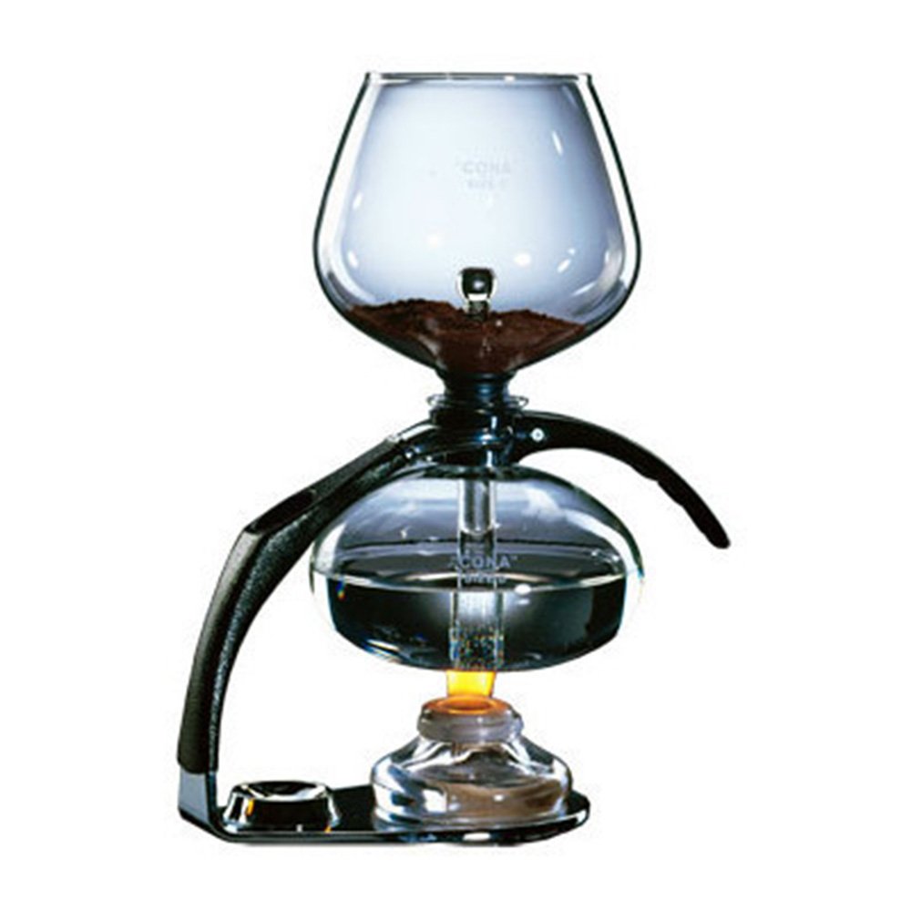

Fifty150 Posted January 11, 2017 Share Posted January 11, 2017 At home, I use a French Press. It just brews a better cup of coffee. When I'm outdoors, I've got the old fashion percolator. Those Mr. Coffee machines just don't make a good cup of coffee. What worked the best, was a coffee siphon. I had one until my ex-girlfriend got mad and threw it across the room at me. Although, she wasn't really mad at me. She was mad at someone else; my other girlfriend. Quote Link to comment Share on other sites More sharing options...
