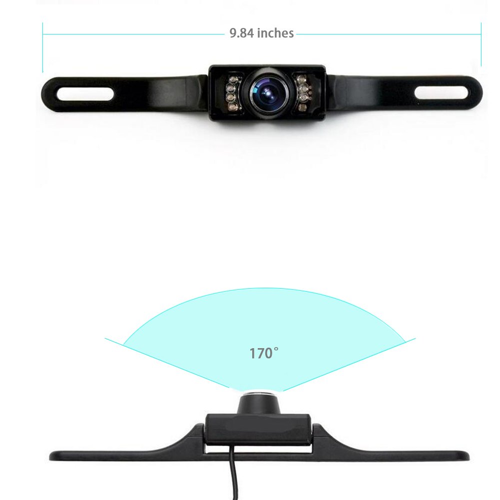

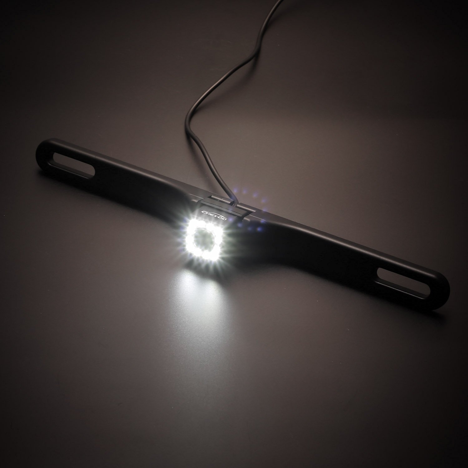

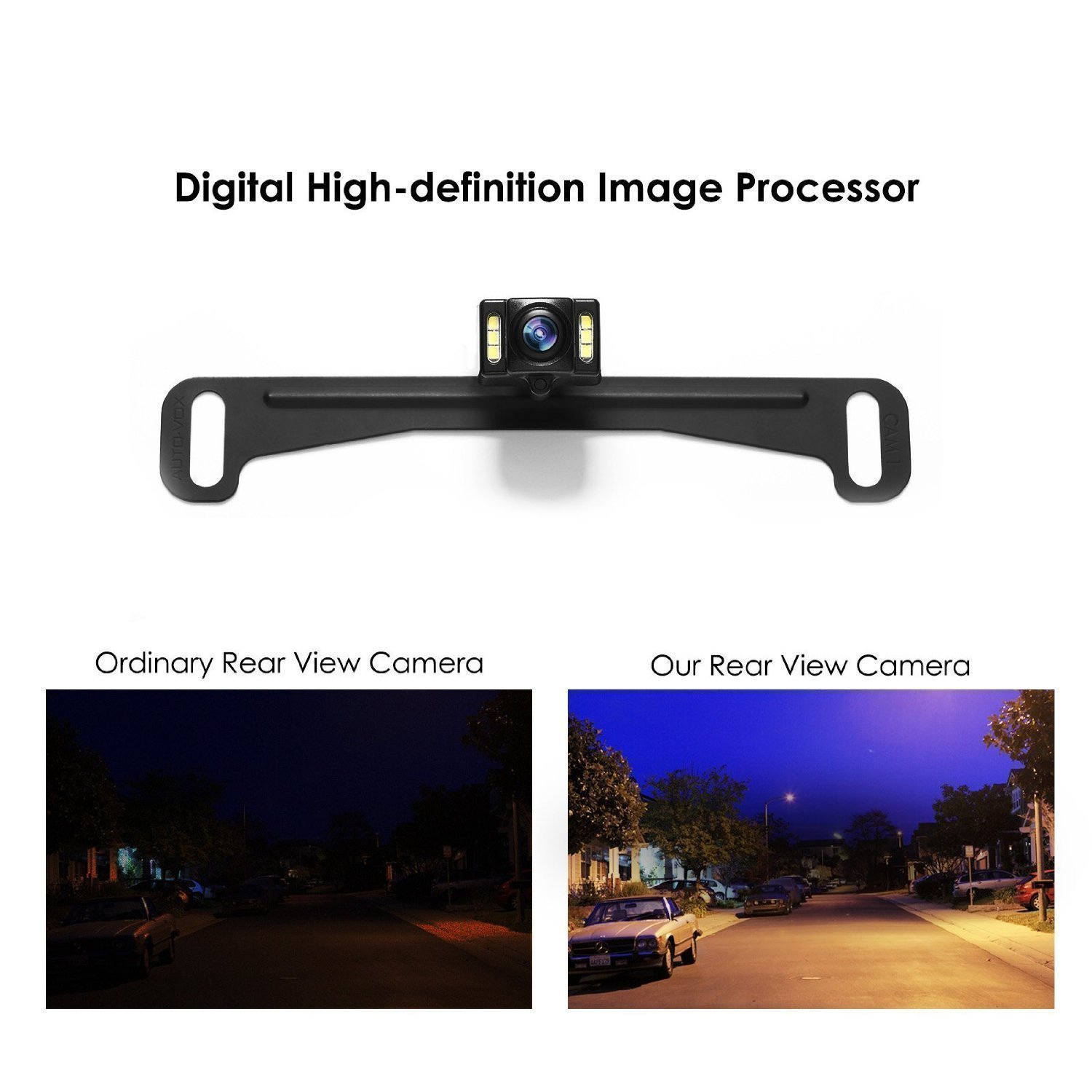

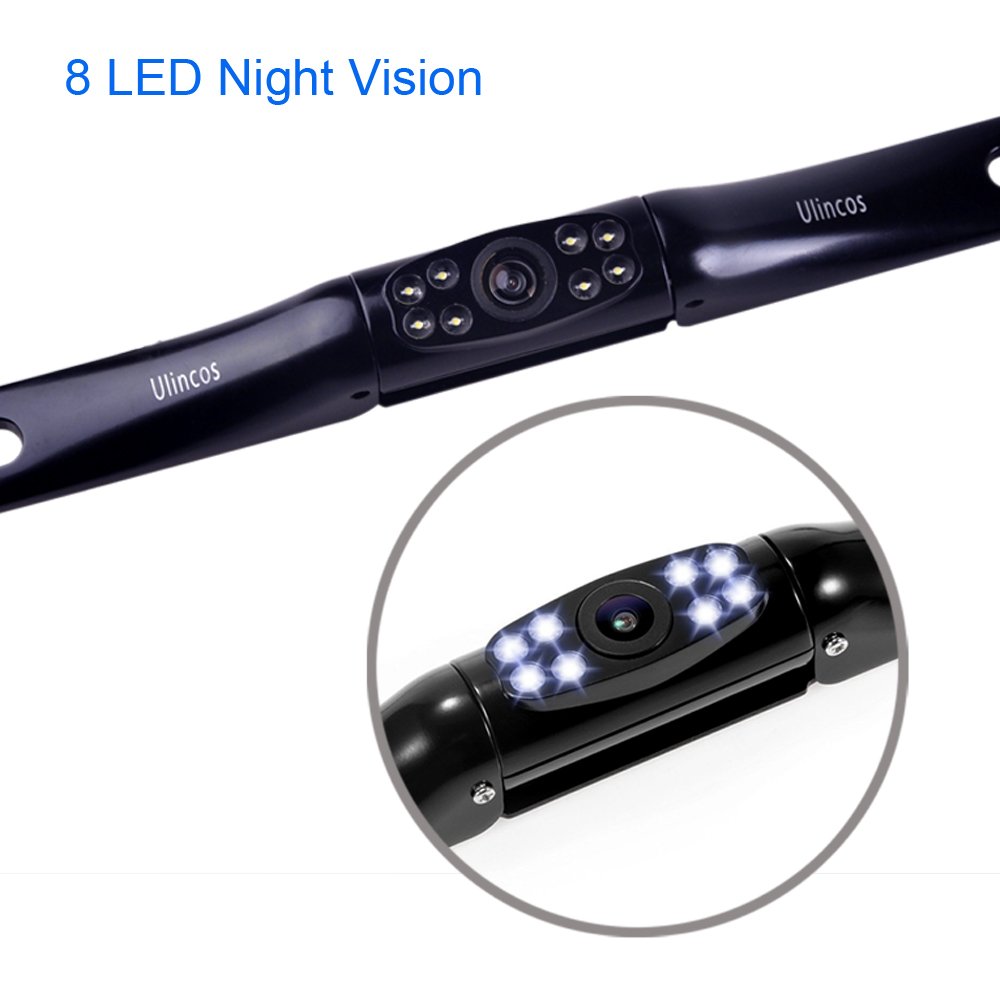

Fifty150 Posted December 7, 2016 Share Posted December 7, 2016 3 hours ago, Beta Don said: you end up installing a new $50 camera and route it direct to the Pioneer When I installed my camera, there were all sorts of backup cameras on Amazon.com for about $20 USD, or less. Quote Link to comment Share on other sites More sharing options...
mrtn Posted December 7, 2016 Share Posted December 7, 2016 Go for CCD camera, more expensive but relatively noise free. CMOS cameras are grainy in low light. Quote Link to comment Share on other sites More sharing options...
Fifty150 Posted December 7, 2016 Share Posted December 7, 2016 A lot of the lower price point cameras, most likely CMOS technology, have LED lighting built in. The alternative is to install LED lighting in tandem with the camera. I installed inexpensive cameras along with inexpensive LED lights. Night vision is great. Quote Link to comment Share on other sites More sharing options...
