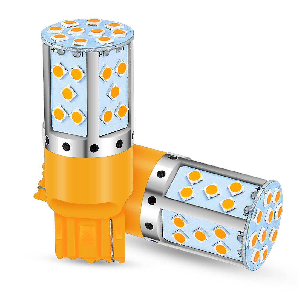

Fifty150 Posted October 29, 2017 Share Posted October 29, 2017 These worked on my Transit Connect. PNP - Plug N Play No hyperflash. https://smile.amazon.com/gp/product/B071JBDTLG/ref=oh_aui_search_detailpage?ie=UTF8&psc=1 Quote Link to comment Share on other sites More sharing options...
