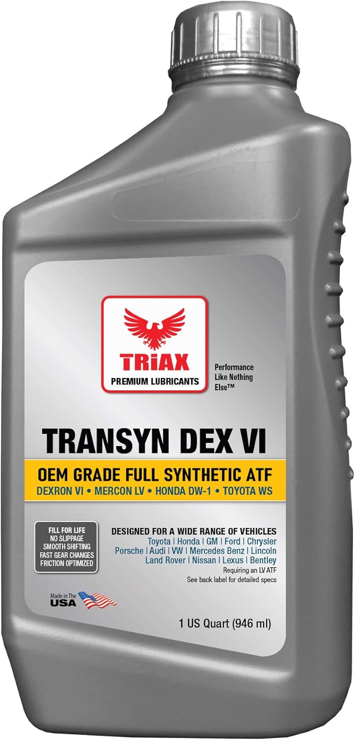

G B L Posted April 20, 2022 Share Posted April 20, 2022 If you use the Triax fluid the color won't darken like the motor-craft or Valvoline fluid. Quote Link to comment Share on other sites More sharing options...

Fifty150 Posted April 21, 2022 Share Posted April 21, 2022 4 hours ago, G B L said: If you use the Triax fluid the color won't darken like the motor-craft or Valvoline fluid. Triax now has a product labeled specifically for low viscosity. I would try it if the price goes down. Quote Link to comment Share on other sites More sharing options...
Willygee Posted April 21, 2022 Share Posted April 21, 2022 Designed, recommended not the same as licensed and approved by the OEM's correct? Quote Link to comment Share on other sites More sharing options...
Fifty150 Posted April 22, 2022 Share Posted April 22, 2022 (edited) 3 hours ago, Willygee said: Designed, recommended not the same as licensed and approved by the OEM's correct? Mercon LV is specification. Motorcraft, a brand of automotive parts, has a low viscosity, automatic transmission fluid, which meets the Mercon LV specification. It is also licensed by Ford. It's all in the wording. Approved? Recommended? By who? That's what you have to question. There have been marketing and sponsorship agreements. My fuel cap says BP. I would be screwed if I could only use BP gas. There are no BP stations in my area. Certain owners manuals were printed, stating that Ford recommends Castrol. In some markets, there is a Ford logo on bottles of Castrol. I wonder how many people question if that Castrol bottle of Ford oil can go into a Toyota. When you read the label on a bottle of ATF, you have to keep in mind that "recommended for" is marketing terminology. And unless it specifically says, "recommended by Ford", it is not recommended by Ford. On a bottle of Valvoline, where it says "recommended for"; it's Valvoline recommending that you use it. Valvoline is a product I use. It is the transmission fluid in my Transit Connect. It is a good example, of a bad example. Valvoline's literature clearly states: You can find this at: https://sharena21.springcm.com/Public/Document/18452/9e447451-fe75-e711-9c10-ac162d889bd3/5ca3517a-e29c-e711-9c10-ac162d889bd3 If you only want to use the actual factory fill fluid, you will buy Mercon LV. If you want a fluid to specification, you will buy a fluid of any brand, which meets the specification, and is licensed. Some fluids may claim to meet specification, but does not label as a licensed product. Edited April 22, 2022 by Fifty150 Quote Link to comment Share on other sites More sharing options...
G B L Posted April 22, 2022 Share Posted April 22, 2022 11 hours ago, Willygee said: Designed, recommended not the same as licensed and approved by the OEM's correct? What I can speak to is the quality of the fluid was better at the 25000 mile drain interval I used. The Mercon Lv and the Valvoline were definitely showing much more heat stress than the Triax. Quote Link to comment Share on other sites More sharing options...
