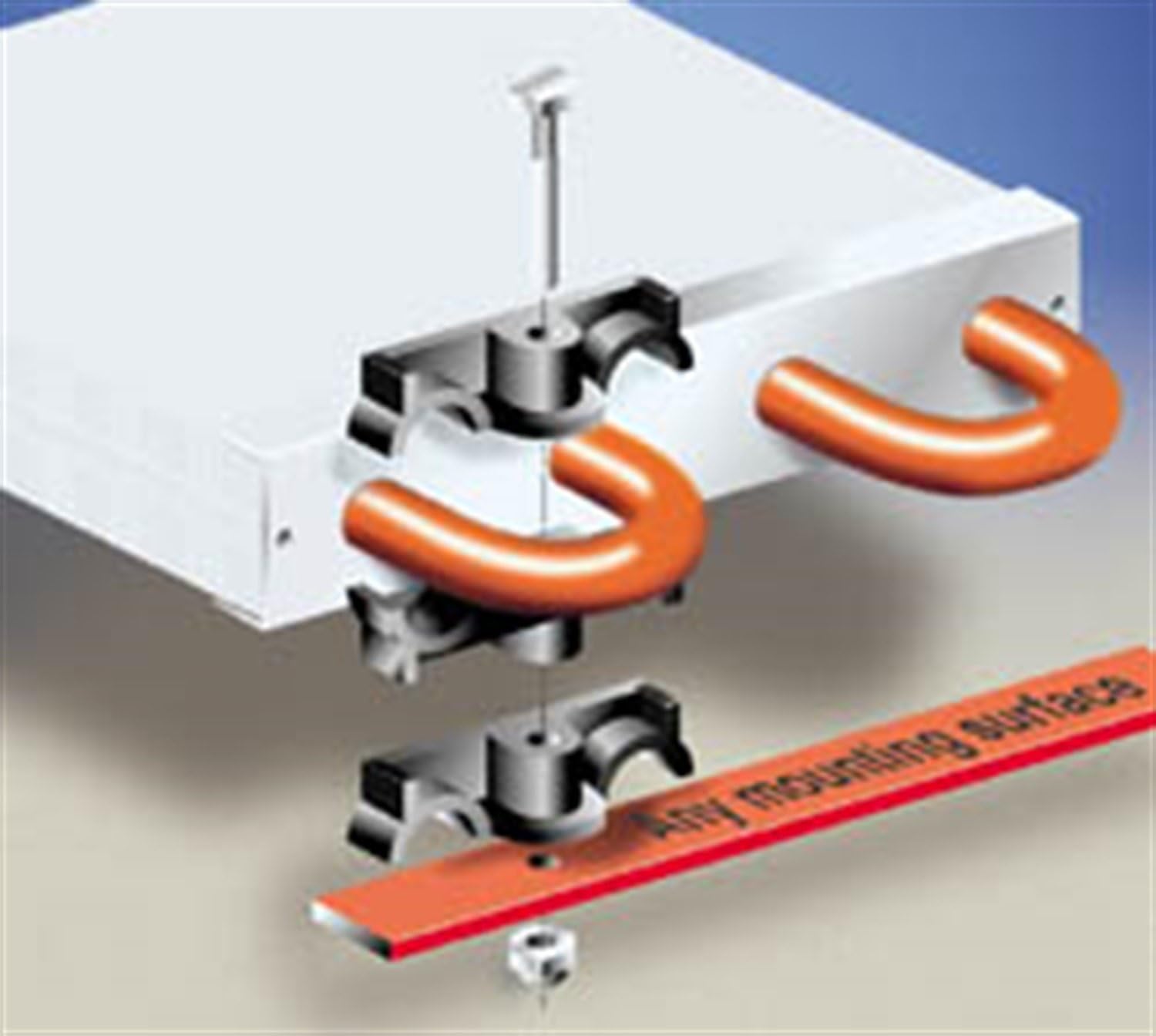

Fifty150 Posted March 27, 2024 Share Posted March 27, 2024 On 10/10/2020 at 3:48 PM, FTC Lover said: a oil and or transmission cooler There are coolers which can cool engine oil and transmission fluid. With the tube & fin style coolers, I use a special kit for mounting. For anyone who really wants to add a transmission cooler, you will need to splice into the fluid return line between the OEM cooler and the bypass valve. Number 3 on the diagram. El Zorgot 1 Quote Link to comment Share on other sites More sharing options...
