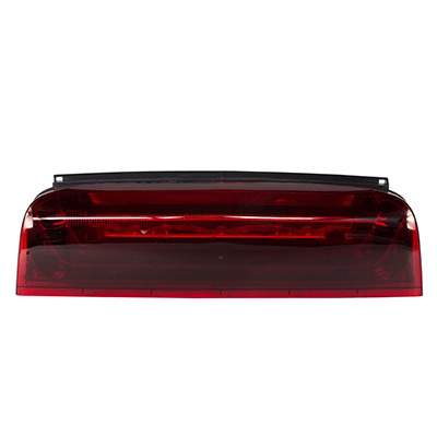

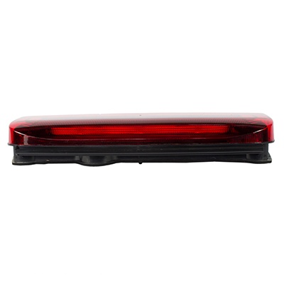

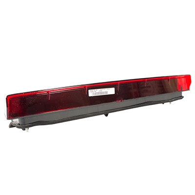

bu11frogg Posted January 13, 2021 Share Posted January 13, 2021 Wow @Fifty150, I don't know how you found that brake light photo and drawing! I searched a long time and only found them for older TC's and full-size Transits! I did tell the dealer it was a go, but the part hasn't come in yet. I'm wondering if they'll let me just buy the part and skip scheduling the job. Thanks @Fifty150 and @G B L! Quote Link to comment Share on other sites More sharing options...
Fifty150 Posted January 13, 2021 Share Posted January 13, 2021 You haven't paid them for anything yet. You don't have to let the dealer charge you for whatever parts and labor. Just cancel it. Order the part online. Do it yourself. 8 hours ago, bu11frogg said: don't know how you found that brake light photo and drawing! I don't know. You should get the same results with the search on your computer. Quote Link to comment Share on other sites More sharing options...
bu11frogg Posted January 14, 2021 Share Posted January 14, 2021 Well, I searched for "third brake light" whereas you searched for "high mount lamp". I didn't know Ford referred to it as that. Again, thank you! Quote Link to comment Share on other sites More sharing options...
