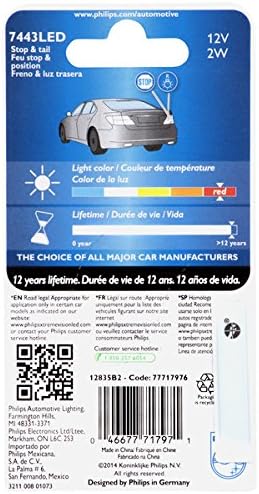

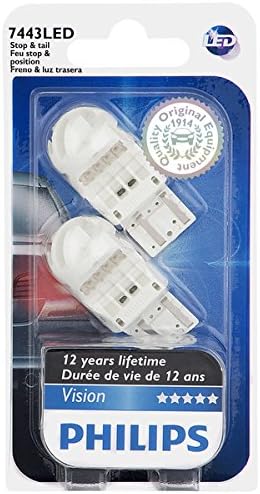

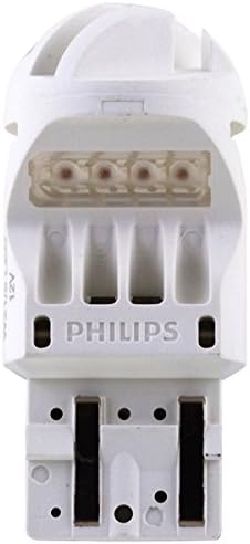

Fifty150 Posted November 10, 2019 Share Posted November 10, 2019 I installed Philips. I am satisfied. They appear to work very well. Quote Link to comment Share on other sites More sharing options...
