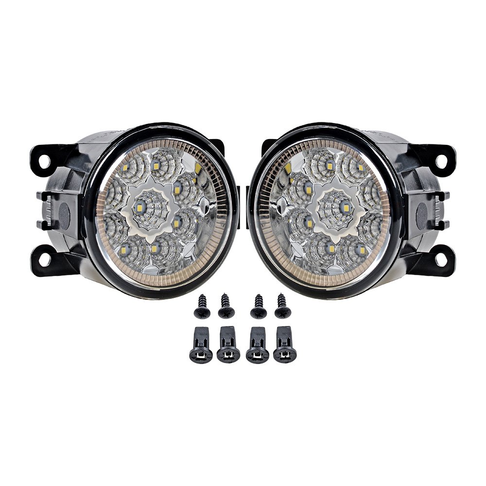

Fifty150 Posted October 13, 2018 Share Posted October 13, 2018 Flowerman, From looking at vehicle collision parts listing, it appears as if there are different plastic lower bumper covers. Just order the bumper cover with the foglights. You will get the holes already in place, along with the mounting tabs. Then buy the correct size fog light to mount in the OEM location. Set up a wire run from your battery, to a fuse, to a relay. You will be all set. 1 BUMPER ASY - FRONT. Bumper cover. w/fog lamps, primed. BT1Z17D957GA Left; OES Part #: 4F9Z15200AAOrRight; OES Part #: 4F9Z15200AA Quote Link to comment Share on other sites More sharing options...
