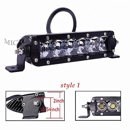

Fifty150 Posted September 27, 2016 Share Posted September 27, 2016 My brother in law and I are constantly having the discussion of LED vs stock halogen. The facts are there. When you plug a LED replacement bulb into a stock halogen housing, the reflectors do not work well enough with the LED light. The headlight housing was designed to "throw" the halogen light. Sure, everything in front of you is brighter with the LED, but the halogen goes farther down the road. If you get a LED spotlight or lightbar, your results will be significantly better. With that being said, I installed LED lamps in my truck, and I am satisfied with the results. However, your feelings may be different. Especially since LED in rain and snow is a lot different. I'm still debating whether I want to change the lights on the Transit Connect. Obviously, I was hoping that someone had already beat me to it, and that I could come on this forum and read their posts. I see that we have dust caps on the rear of the light housing unit. I get it. Older cars without dust caps tend to have more issues when it comes time to change the lamps. With any LED drop-in kit, I will need to run them without the dust caps. The dust caps, even if they fit, will interfere with the extra cooling that the LED lamps require. The other consideration would be what to do with the ballast. Ideally, you would want to mount the ballast and/or secure it so that it doesn't just bounce around. I may have to come up with a creative solution so that my ballast don't come loose and fall off. Then there is the question of the direction indicators. I may have to leave the front direction indicators in their OEM configuration. Either that, or slice into the OEM harness which connects to the entire headlight housing, and run really long wires to the load resistors because those should also be secured, and preferable to metal not plastic, since they get hot. I sure wish there was a Haynes Manual available. Quote Link to comment Share on other sites More sharing options...

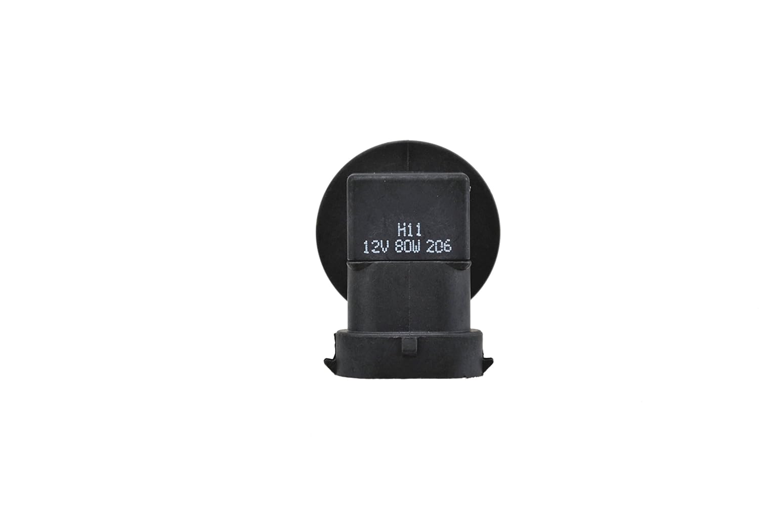

Fifty150 Posted September 28, 2016 Share Posted September 28, 2016 1 hour ago, Beta Don said: Osram bulbs are the way to go - Nothing else comes close. In the days of yore & yesteryear, prior to drop-in HID & LED kits, my buddies & I always got higher wattage lamps. Hella was the brand that we always went with. Nobody ever got caught, or had an issue. Of course, I would never recommend that anyone do something as outlandish as install an 80 watt lamp because the Department of Transportation specifies that you operate 55 watt lamps. Anything over 55 watts is labeled as "off road only". So remember that you should only install them once you're no longer on a public thoroughfare, and only use them on the farm, at the campground, or anywhere else where there just isn't any overhead municipal supplied illumination. Never forget to change them out and drive around all over town, and across the country, with illegal lighting. Quote Link to comment Share on other sites More sharing options...

mrtn Posted September 28, 2016 Share Posted September 28, 2016 5 hours ago, Fifty150 said: In the days of yore & yesteryear, prior to drop-in HID & LED kits, my buddies & I always got higher wattage lamps. Hella was the brand that we always went with. Nobody ever got caught, or had an issue. Of course, I would never recommend that anyone do something as outlandish as install an 80 watt lamp because the Department of Transportation specifies that you operate 55 watt lamps. Not only that. The higher wattage bulbs had some more disadvantages: hard on wiring/plugs (my Taurus melted contacts and switches even at legal wattage) heat damage to plastic lenses, developed haze over time nordic climate only problem: thermal shock damage to lenses/clusters when plowing into a snow bank Quote Link to comment Share on other sites More sharing options...
Beta Don Posted September 28, 2016 Share Posted September 28, 2016 LOVE all your pictures, Fifty150 (you must have a real name, no?) and I agree that whatever bulb you go with, it's very wise to go with the recommended wattage. Factory engineers always seem to go with very minimal wire gauges and the voltage drop with stock wattage bulbs is often higher than recommended by the bulb manufacturers - With the 500 or more miles of wire in an average car these days, going one wire size under the recommended gauge saves them tons of expensive copper every year and don't think they're not aware of the money that saves them I love LED's and 95% of the lighting in my home is LED and I really wish there was an LED headlight that would make an improvement in the lighting of the van using the stock headlights, but I know better. I will eventually upgrade most of the other bulbs on the van to LED's, but for now Osram halogens will have to suffice for an upgrade to the stock head and fog lights I too have used my share of Haynes manuals over the years, but with this van the OEM book of Wiring Diagrams is much thicker than any Haynes manual I've ever seen. It's got to be 300+ pages . . . . hard to tell exactly because of the way they are numbered, but it was only $16 brand new when I found it on eBay and it's nearly Impossible to do any electrical mods without that book Don Quote Link to comment Share on other sites More sharing options...

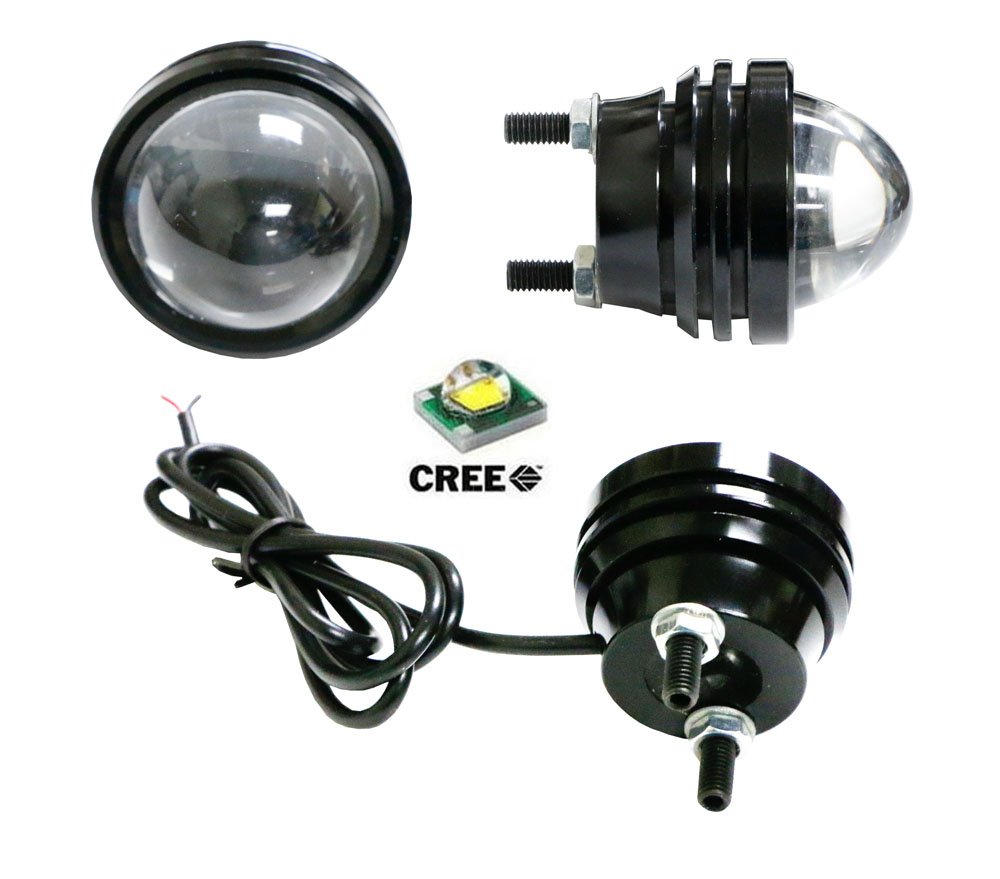

Fifty150 Posted September 28, 2016 Share Posted September 28, 2016 And what is with that battery box configuration under the hood? I can already see how much of a pain it's going to be when it's time to change the battery. I suppose if I did things the old fashion way, simply wire my aftermarket accessories to the battery terminals and use a system of circuit breakers, inline fuses, relays, and switches, I could bolt everything right onto the top of the battery box cover. Has anyone added off-road lights instead of trying to mod the OEM lighting system? Modern LED lightbars can probably supply a better lightsource than any drop-in lamp or projector module. Quote Link to comment Share on other sites More sharing options...

Fifty150 Posted October 5, 2016 Share Posted October 5, 2016 I moved the smaller lamp behind the yellow lens used as a side marker, and replaced it with a different lamp with more LED pieces. Quote Link to comment Share on other sites More sharing options...
