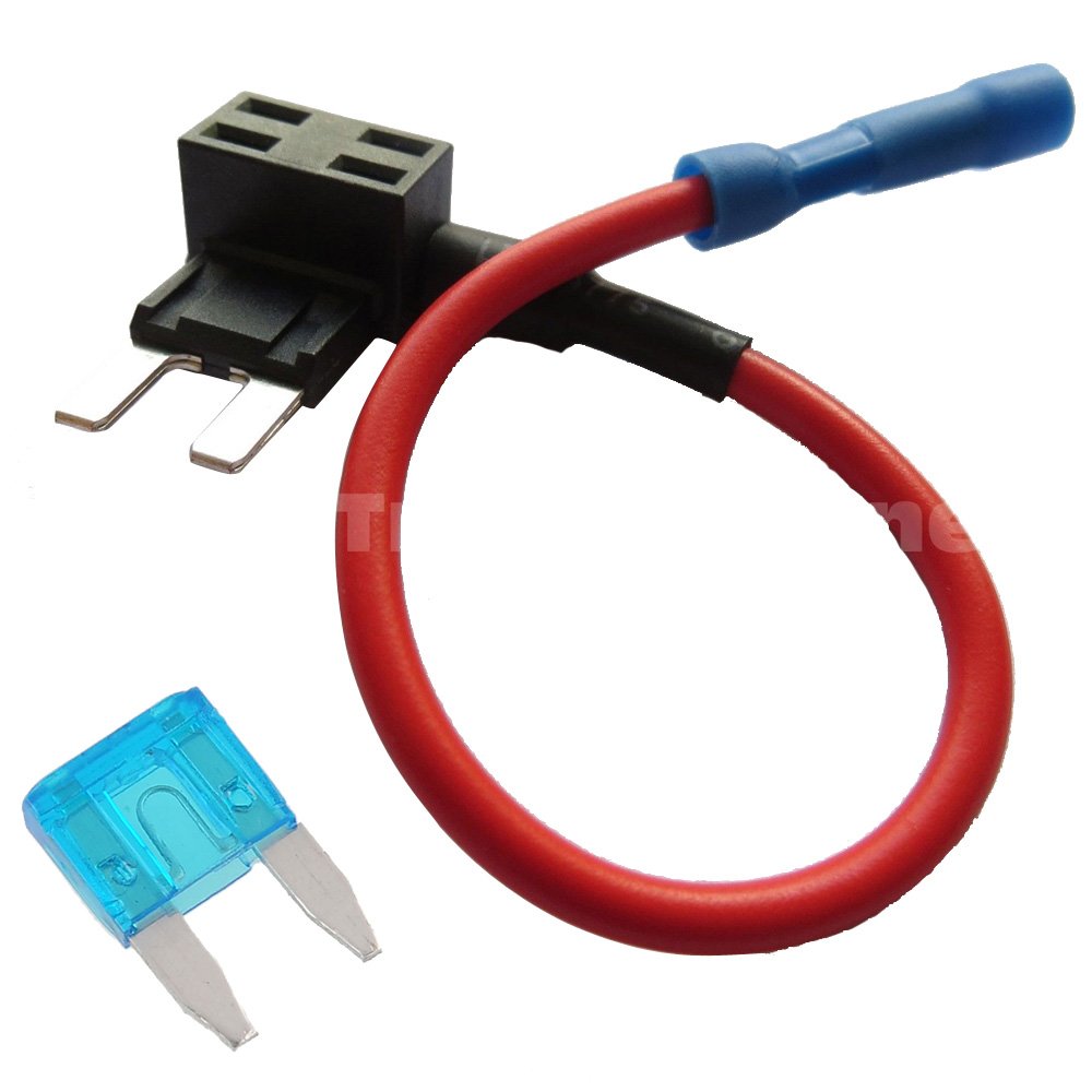

Fifty150 Posted September 27, 2016 Share Posted September 27, 2016 My original strategy was to install fuse taps. Quote Link to comment Share on other sites More sharing options...

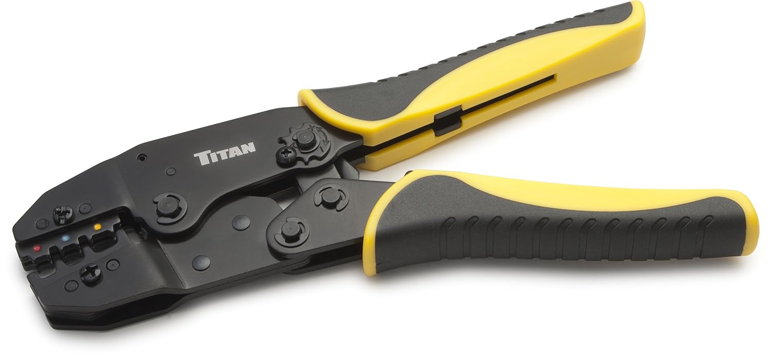

Fifty150 Posted October 1, 2016 Share Posted October 1, 2016 On 9/27/2016 at 4:20 PM, Don Ridley said: You need a crimp tool like this. Shop around for a better deal. https://www.amazon.com/gp/aw/d/B00SZL59NY/ref=pd_aw_sbs_60_of_12?ie=UTF8&psc=1&refRID=ZT3T3N4DQNBJDMN6RP87 Expand Thanks Don, ........and since I am an amatuer, I had to search online to learn what to do. This should help someone like me, who has never done it before. Quote Link to comment Share on other sites More sharing options...

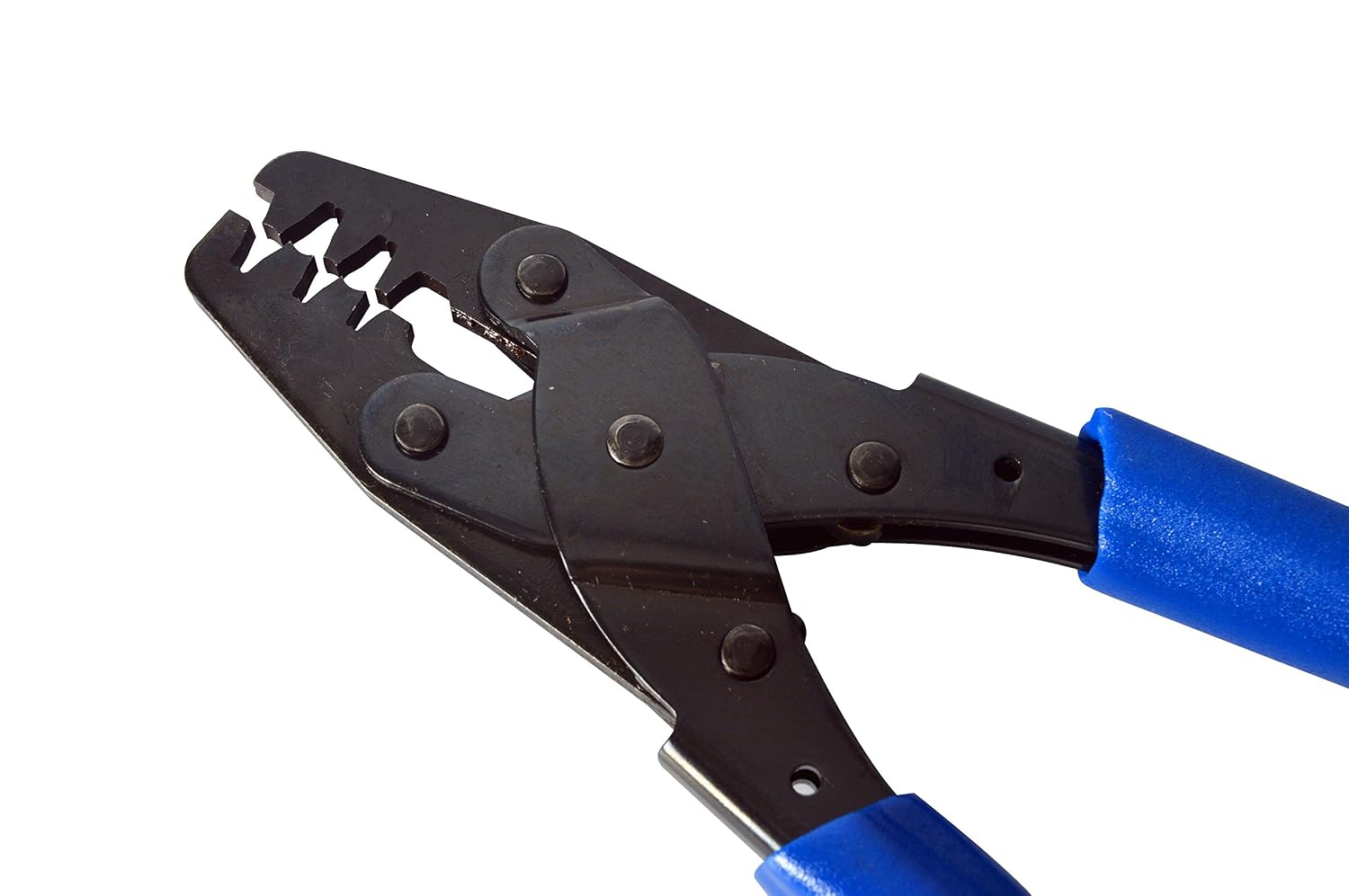

Fifty150 Posted October 1, 2016 Share Posted October 1, 2016 Does the head on this tool look like it will work for crimping these connectors? Sorry for lacking knowledge. Quote Link to comment Share on other sites More sharing options...
Fifty150 Posted October 1, 2016 Share Posted October 1, 2016 Or how about this one? Quote Link to comment Share on other sites More sharing options...
Fifty150 Posted October 1, 2016 Share Posted October 1, 2016 Or maybe this? Quote Link to comment Share on other sites More sharing options...
Fifty150 Posted October 1, 2016 Share Posted October 1, 2016 On 9/27/2016 at 4:20 PM, Don Ridley said: https://www.amazon.com/gp/aw/d/B00SZL59NY/ref=pd_aw_sbs_60_of_12?ie=UTF8&psc=1&refRID=ZT3T3N4DQNBJDMN6RP87 Expand Okay, so this is the tool that you recommend? Quote Link to comment Share on other sites More sharing options...
Don Ridley Posted October 1, 2016 Author Share Posted October 1, 2016 Yes, the last tool will work. Removing the fuse block is easy. Insert the terminal crimped onto a length of wire paying attention to the direction of the contact slot so a fuse can be inserted. This is almost as easy as changing a light bulb. Use the smallest amp fuse you need. 5 amp works for all LED lights. 20 and 30 amp are only for large loads. I use 14awg wire minimum for everything, plus I have a big spool of it (MTW type, not THHN). Quote Link to comment Share on other sites More sharing options...
