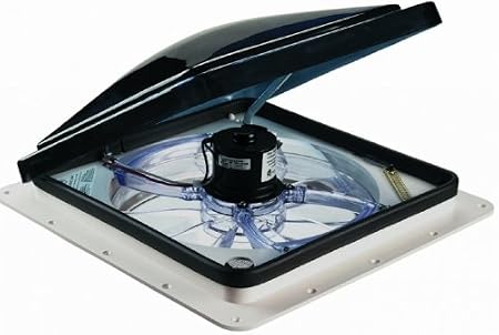

Fifty150 Posted March 7, 2017 Share Posted March 7, 2017 First thing to consider is airflow. For paint fumes, you need a fan. Adrian Steel makes a really nice partition. The vans at work all have Adrian Steel dividers. I would imagine that once installed, it shouldn't be that hard for you to seal up any remaining holes. But you will never build something to keep funes out of the passenger area. You will still need a fan. https://www.adriansteel.com/item/cargo-vans/2016/PARTC-NW Composite Partition, no window, Transit Connect Home >> Cargo Van Equipment >> Partitions >> PARTC-NW Item #PARTC-NW Composite Partition, no window Fits Ford Transit Connect Introducing the partition that is all about driver comfort! There is a trend happening with cargo van owners in the market. They want a product that offers more value than the traditional steel partition provides. Something that quiets the cab area, provides more leg room and provides better climate control. Drivers that spend 8-12 hours a day working out of their mobile office want a more comfortable experience. Adrian Steel’s new line of composite partitions offers unparalleled comfort for the driver. Climate Control – Quickly cool down or heat up the cab area of the cargo van, reduce idle time doing so and save fuel! Sound Deadening – Reduce the harshness of the cargo noise entering the cab area. This reduces driver distractions and makes for a quieter environment to communicate when driving. Leg Room – Full seat travel and a comfortable recline angle makes the composite partition our most comfortable line of partitions we sell. Organize – Partitions are great location to hang your cargo. Easily add safety items like fire extinguishers and first aid kits, or hooks to hang your extension cords or hoses. Additional accessory kits are available to customize your Adrian Steel composite partition even more. Quote Link to comment Share on other sites More sharing options...

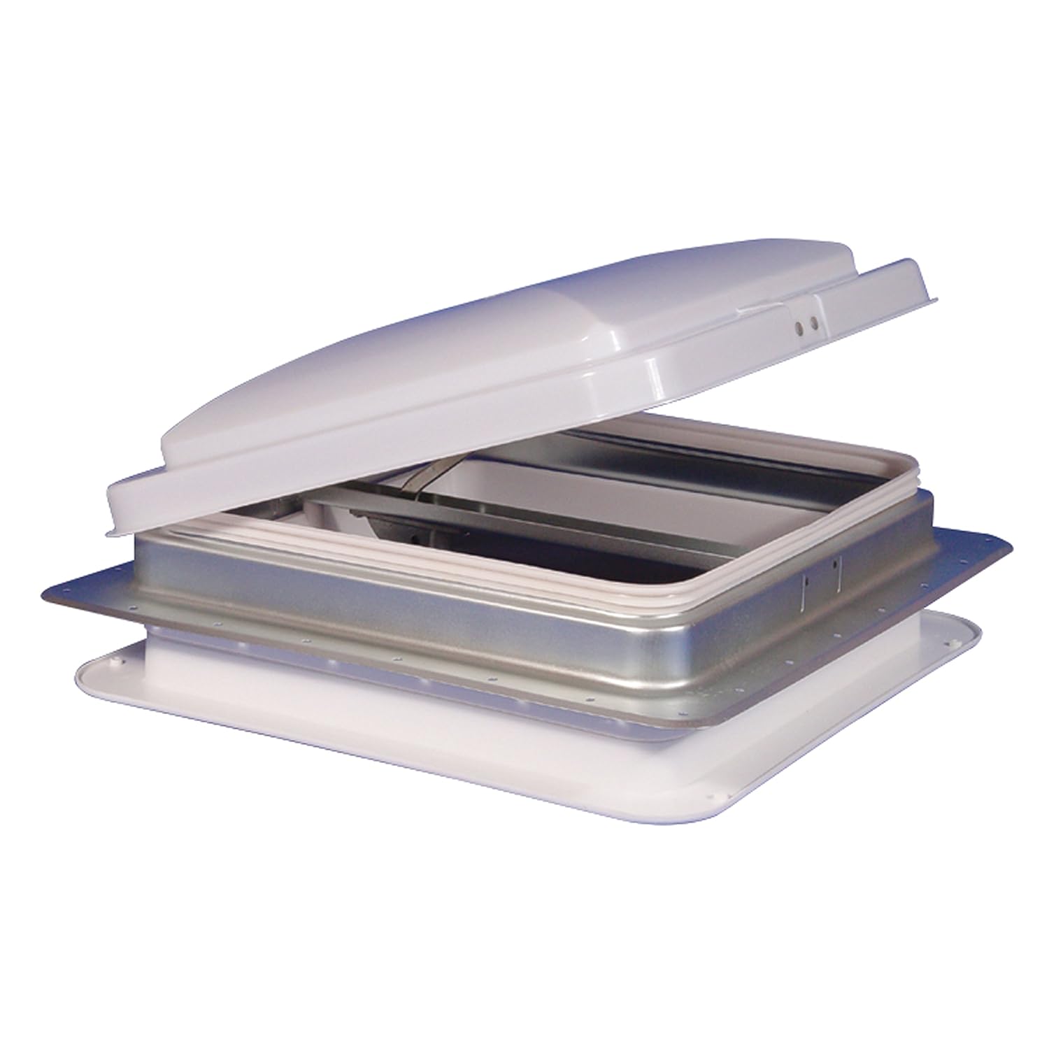

Fifty150 Posted March 7, 2017 Share Posted March 7, 2017 If the fan is too expensive, or too much of a hassle to run wiring for the installation, then consider at least installing a vent. These are simple. Just cut, apply weather sealant, and bolt together. Quote Link to comment Share on other sites More sharing options...
