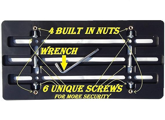

Here in AZ we don't have front plates so I have no holes or bracket in the front bumper. My last car, a Totota, came with the front plate bracket and screws in a bag by the spare tire. This one came with nothing else - at least I haven't found anything else - maybe it's with the spare tire which I should drop and inspect.
A couple weeks ago I ordered the following $10 front plate holder and used it to move my rear plate up closer to the lights. It worked perfect - used the factory screws to mount it to the vehicle and then used the included Torx screws to mount my plate.
https://www.amazon.com/gp/product/B00RIVG814/ref=oh_aui_detailpage_o03_s00?ie=UTF8&psc=1
Trunknets Inc Universal Front Bumper License Plate Bracket + 6 Unique Screws and Wrench Kit
