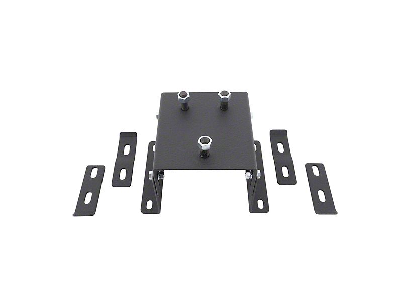

Double Nickels Posted October 12, 2019 Share Posted October 12, 2019 You won't be able to mount a 2nd spare under the van. You will either carry it inside, or mount it on the roof. It's too much weight on the rear door hinges. Look for something like this. Make sure that it will accept the bolt pattern. eggman14 1 Quote Link to comment Share on other sites More sharing options...
