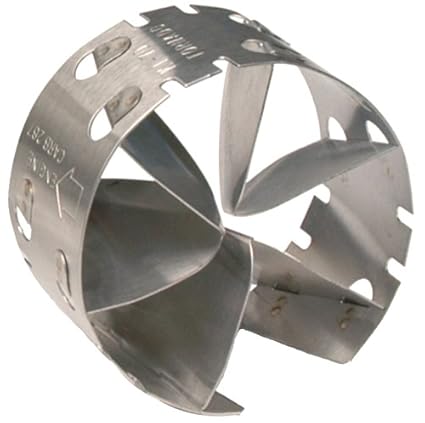

Fifty150 Posted February 16, 2019 Share Posted February 16, 2019 Engines can be pretty durable. Your's is still working. If any harm was done, it's already done. Can't worry about that now. Look ahead. Remove your Intake from the air box to the throttle body. Clean everything as best as you can. Also, clean the Mass Air Flow sensor. Re-Assemble with Tornado thomaslove 1 Quote Link to comment Share on other sites More sharing options...
thomaslove Posted February 16, 2019 Author Share Posted February 16, 2019 On 2/16/2019 at 2:11 AM, Fifty150 said: Engines can be pretty durable. Your's is still working. If any harm was done, it's already done. Can't worry about that now. Look ahead. Remove your Intake from the air box to the throttle body. Clean everything as best as you can. Also, clean the Mass Air Flow sensor. Expand Brilliant! Thanks for the info. I will get onto this right away. The Tornado looks a bit pricey with some mixed reviews - does it make a noticeable difference? Quote Link to comment Share on other sites More sharing options...
mrtn Posted February 16, 2019 Share Posted February 16, 2019 The Tornado is a joke like a fuel magnet or playing classical music to your drinking water. Do not buy one, ever. thomaslove 1 Quote Link to comment Share on other sites More sharing options...
Fifty150 Posted February 16, 2019 Share Posted February 16, 2019 I thought that everyone knew that the Tornado is a joke. I'm surprised that is still on the market. It's still being sold? Quote Link to comment Share on other sites More sharing options...
mrtn Posted February 17, 2019 Share Posted February 17, 2019 You must have thought we had ran out of stupidity in the world by now? Quote Link to comment Share on other sites More sharing options...
