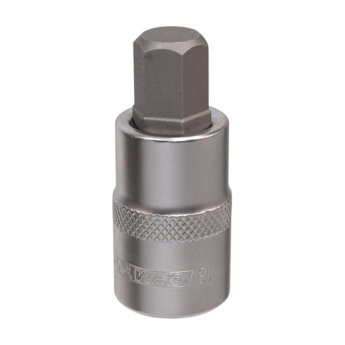

Fifty150 Posted July 31, 2018 Share Posted July 31, 2018 Does anyone know the size of the hex bit I will need to insert into the guide hole? Just in case I lose the OEM lug wrench. And just in case anyone needs to know, the OEM torque spec is 100 lb-ft. With an 18" breaker bar, and a 3/4" socket, the lug nuts came off with ease. Quote Link to comment Share on other sites More sharing options...
Dandytc Posted July 31, 2018 Share Posted July 31, 2018 The hex bit on the lug wrench is 13 mm, with a loose fit, but a 14 mm bit doesn't fit. It looks like a 1/2" bit would work as well. Did you need an excuse to visit your nearest HF? Quote Link to comment Share on other sites More sharing options...

zalienz Posted August 1, 2018 Share Posted August 1, 2018 This worked for me. https://www.amazon.com/gp/product/B004W80MPE/ref=oh_aui_detailpage_o00_s00?ie=UTF8&psc=1 Quote Link to comment Share on other sites More sharing options...
Fifty150 Posted August 1, 2018 Author Share Posted August 1, 2018 Okay. 13 mm is slightly more than 1/2". 14 mm is equal to 9/16". 7 hours ago, Dandytc said: The hex bit on the lug wrench is 13 mm, with a loose fit, but a 14 mm bit doesn't fit. It looks like a 1/2" bit would work as well. zalienz, Was your 13 mm a loose fit also? Quote Link to comment Share on other sites More sharing options...
mrtn Posted August 1, 2018 Share Posted August 1, 2018 Loose fit is intentional. You should be able to rotate it comfortably. Quote Link to comment Share on other sites More sharing options...

Fifty150 Posted August 4, 2018 Author Share Posted August 4, 2018 On 7/31/2018 at 8:38 PM, zalienz said: This worked for me. https://www.amazon.com/gp/product/B004W80MPE/ref=oh_aui_detailpage_o00_s00?ie=UTF8&psc=1 Thanks for the tip. I bought this one. It works. OEMTOOLSOEMTOOLS 22841 13mm Metric Drive Hex Bit Socket Click image to open expanded view OEMTOOLS OEMTOOLS 22841 13mm Metric Drive Hex Bit Socket Be the first to review this item Price: $4.49 Free Shipping for Prime Members Quote Link to comment Share on other sites More sharing options...
