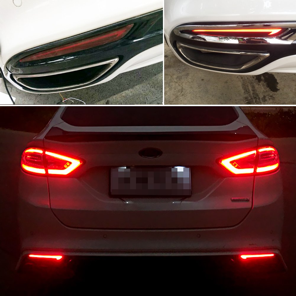

Fifty150 Posted October 1, 2018 Share Posted October 1, 2018 LED lamp installed in upper trim piece. Reflectors on bumper replaced with LED lamp which are paired to operate with matching amber LED lamp on side trim piece between mirror and windshield. Reflectors came right out as I pinched lock tabs with fingers and pushed. Both are operated by a remote control, so no wiring into the cabin or drilling the dashboard for a toggle switch. Lamps can be upper trim ON, bumper ON, both ON, or warning strobe. Quote Link to comment Share on other sites More sharing options...
Don Ridley Posted October 1, 2018 Share Posted October 1, 2018 Fifty, Did you install the led into the existing bumper mounted reflectors? Or is the LED a replacement for the reflectors? Quote Link to comment Share on other sites More sharing options...
Fifty150 Posted October 2, 2018 Share Posted October 2, 2018 I removed the reflectors. Just pinch the mounting tabs and push out. I did it with my fingers. Needle nose pliers would work too. Once the reflectors were out, I used the existing OEM holes that the reflector tabs inserted into. No extra cutting or drilling. Quote Link to comment Share on other sites More sharing options...
Fifty150 Posted October 2, 2018 Share Posted October 2, 2018 From what I could remember, all of those LED lamps also come in blue, in case anyone wants to install blue lights. Quote Link to comment Share on other sites More sharing options...

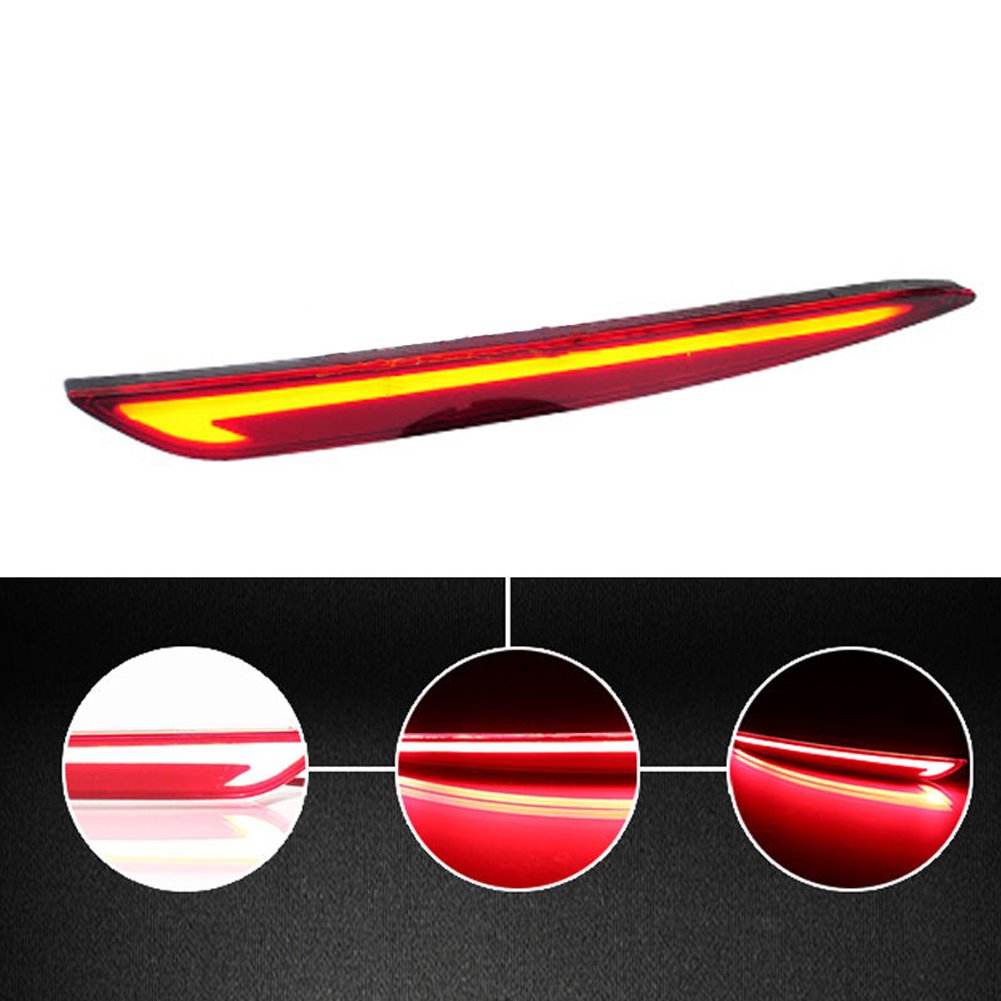

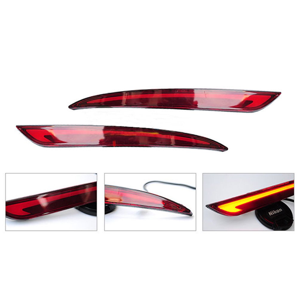

Fifty150 Posted October 2, 2018 Share Posted October 2, 2018 There are more options out there. Just keep looking. With this piece, you can measure and drill the holes yourself - right into the plastic bumper or the plastic upper trim piece. Or if you are thinking outside the box, cut off the mounting tabs and affix with epoxy. There is even special epoxy for "plastic to plastic". https://smile.amazon.com/dp/B074W9RV82/ref=gbps_tit_s-5_aa19_9e865817?pf_rd_p=e1da54c7-110f-4046-97da-aa11c13eaa19&pf_rd_s=slot-5&pf_rd_t=701&pf_rd_i=gb_main&pf_rd_m=ATVPDKIKX0DER&pf_rd_r=EW9E6VXQ0CZ6BBAWX46Z 3D Optic Red LED Rear Bumper Reflector Turn Signal Brake Tail Lights Lamps For 2014 2015 2016 Ford Fusion Mondeo jrm223 1 Quote Link to comment Share on other sites More sharing options...
