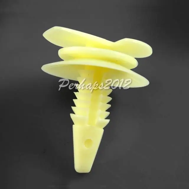

jrm223 Posted July 6, 2017 Share Posted July 6, 2017 On 6/30/2017 at 8:40 AM, MLB said: The tool is nice but you don't need it to take the clips out. The round center needs to get pulled UP, out of the round whole piece. There is a hole "drilled" through the center of that center piece, stick a small screwdriver or pick into one end of the hole, push it in a bit and then pull up gently, once the center piece slides up, the whole clip is loose and easily removed. To replace set it in and push the center round piece down to expand and lock the clip in place. Works like a wall anchor in drywall basically, expanding and locking as the center is pushed down. Nobody needs to break these. We're all talking about the "Christmas trees" on the inside of the side panels, not the push-clips on the door cards. Like these things... Quote Link to comment Share on other sites More sharing options...
