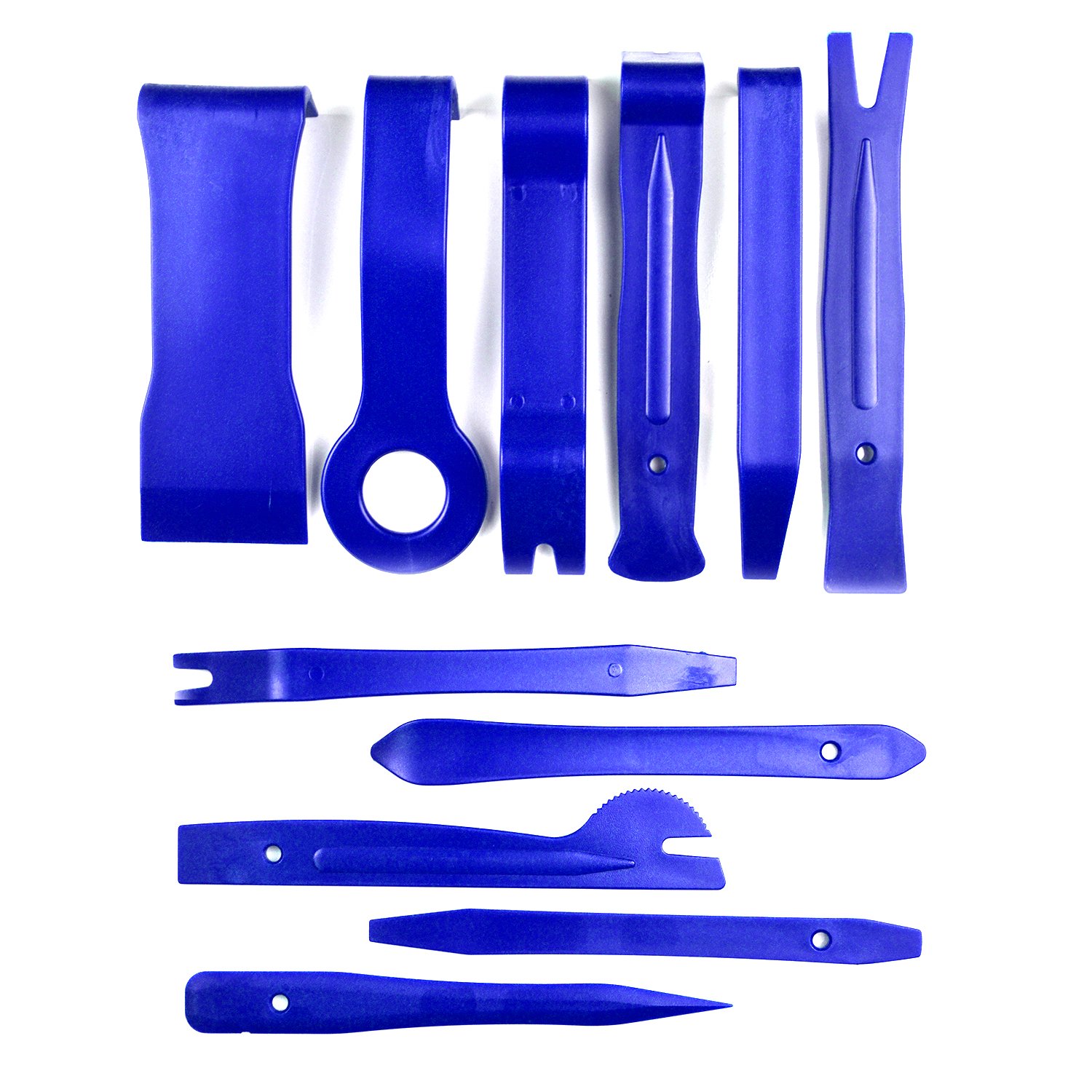

Fifty150 Posted September 24, 2016 Share Posted September 24, 2016 You will probably want a set of these tools. Quote Link to comment Share on other sites More sharing options...

DonShockley Posted September 24, 2016 Share Posted September 24, 2016 On 9/24/2016 at 1:27 PM, Tiller said: ....Where to you get those? Do you have a link to them? ....... Expand Harbor Freight has some almost identical tools. Not as extensive a set but only about 1/4 the price. I've used them a lot. http://www.harborfreight.com/automotive-motorcycle/trim-moulding.html Quote Link to comment Share on other sites More sharing options...
Fifty150 Posted September 24, 2016 Share Posted September 24, 2016 You can buy them from Amazon.com or eBay. The Harbor Freight version is okay. You will be able to use it for a couple times before you wear them out and break them. I have a set where some of the ends started to bend because the low cost plastic was not strong enough for the job. Quote Link to comment Share on other sites More sharing options...
Don Ridley Posted September 25, 2016 Share Posted September 25, 2016 Buy the tool or tools. I don't know why I waited so long. Here is what I am using: https://www.amazon.com/Lisle-35260-Plastic-Fastener-Remover/dp/B0002SRCMO/ref=sr_1_14?ie=UTF8&qid=1474823907&sr=8-14&keywords=panel+removal+tool It seems like every interior and exterior panel on the van is secured by plastic fasteners. Quote Link to comment Share on other sites More sharing options...
Fifty150 Posted September 27, 2016 Share Posted September 27, 2016 I've seen that one. Wasn't sure on buying it. As you said, almost everything is secured with plastic. I thought the plastic tools might be better. I was afraid of a metal tool being too rough. Quote Link to comment Share on other sites More sharing options...
Fifty150 Posted September 29, 2016 Share Posted September 29, 2016 On 9/25/2016 at 5:21 PM, Don Ridley said: I don't know why I waited so long. Expand You were right. I just clicked on one also. It's better to have that tool in your arsenal, than to improvise and possibly damage something. Quote Link to comment Share on other sites More sharing options...
