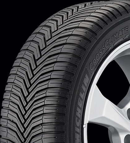

Summer tires are bald, hit the wear marks and hydroplaned a bit on Tuesday seeing the first serious rainfall while driving this year. Just ordered a new set of Michelin Cross Climates:
\When you add snow and Ice and Mud to the mix it changes the engineering requirements.  How many miles? The propane being under pressure would  definitely point out any leaks in the system. What gets serviced in the injectors?                                                                                                                                                                                                                                                                                                                                                                                                     Those look like good tires, Let us know how they ride and hold up.
I have 81Mm (50K miles) on the odo. So 30K on the OEM Continentals. My tire guy said these Michelins have a ridiculous treadwear warranty and are very quiet, especially for snow rated ones.
