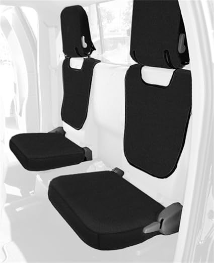

Fifty150 Posted October 15, 2019 Share Posted October 15, 2019 10 hours ago, Marquizzo said: - How do you install reliable seatbelts? 10 hours ago, Marquizzo said: - What kind of seats will you buy and do they have headrests? There are aftermarket seats and jump seats which have built in seat belts and headrest. A lot of options. But you will have to decide for yourself if it is safe. Your state's vehicle code may have something to say about it also. But as for function, they will all be functional once you have measured and factored in your available space. Camperconnect 1 Quote Link to comment Share on other sites More sharing options...

Marquizzo Posted October 15, 2019 Share Posted October 15, 2019 @Fifty150 All those seats are really good options! Are these side-facing seats? 12 hours ago, Fifty150 said: Hard to tell what I'm looking at (that looks like the cargo door in the back), but if they're side-facing seats I'd recommend against them. They provide zero neck support in case of a frontal or rear collision. The spinal damage caused by lateral whiplash would be devastating. Quote Link to comment Share on other sites More sharing options...
Double Nickels Posted October 15, 2019 Share Posted October 15, 2019 Those look like generic jumpseats that you can install any way you want. A Google search for "jumpseats" will give you more options. I recall seeing a thread where a guy installed a single seat behind the passenger seat. I think he also cut a hole in the floor board. Quote Link to comment Share on other sites More sharing options...

KevinRollin Posted October 20, 2019 Share Posted October 20, 2019 On 10/15/2019 at 3:46 PM, Marquizzo said: @Fifty150 All those seats are really good options! Are these side-facing seats? Hard to tell what I'm looking at (that looks like the cargo door in the back), but if they're side-facing seats I'd recommend against them. They provide zero neck support in case of a frontal or rear collision. The spinal damage caused by lateral whiplash would be devastating. That might be looking laterally through a pickup truck extended cab, with suicide rear doors. Quote Link to comment Share on other sites More sharing options...
