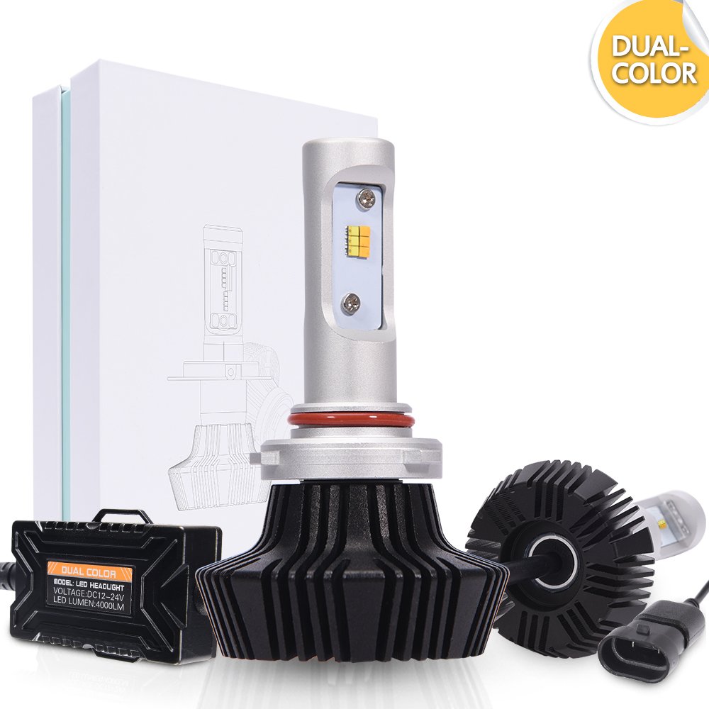

Fifty150 Posted June 2, 2018 Share Posted June 2, 2018 H13 LED are typically more difficult to install. If you get low beam on one side, with high beam on opposite side, the final installed position is with the low beam on top. If the L ED has high and low beams on both sides, the final installed position is with the LED chips facing sideways @ 3&9. Some units are adjustable. But if the LED are not in the correct position, then your lights will not properly illuminate the road. I'm currently using dual color LED in H13. Low beam is daylight white. High beams are amber. When driving in snow or fog, the amber color headlights are unbelievable. Also highly effective when used with wig wag flashers. Quote Link to comment Share on other sites More sharing options...
sKiZo Posted June 3, 2018 Author Share Posted June 3, 2018 Something to look out for, but wondering how it would be possible to install them backwards, as the socket is offset ... Which bulbs did you use that are bi-color? Sounds like an interesting way to go. Quote Link to comment Share on other sites More sharing options...

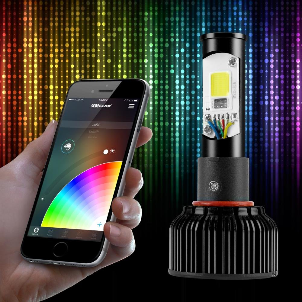

Fifty150 Posted June 5, 2018 Share Posted June 5, 2018 You are not installing them backwards. What happens is when they leave the factory, the lamps were never designed for your vehicle. So when you line up the notches and turn the lamp into it's final position, it is a little bit different in every vehicle. If you're not lucky, you will get an LED meant for low beam driving facing 7-8 o'clock position. This will point your low beam off the reflector, and into the sky to your left. Then your high beam LED will be the exact opposite, aimed at the ground, and to the right. So H13 are adjustable, and that is what you want. You need the low beam LED to point up at 12, so that the reflector directs the light evenly towards the road. Google "dual color led H13" and you should get all sorts of results. Here is a headlight which allows you to use a smart phone app to control the color temperature. I use something similar to these. Different brand sellers. But all from the same factory. Quote Link to comment Share on other sites More sharing options...
