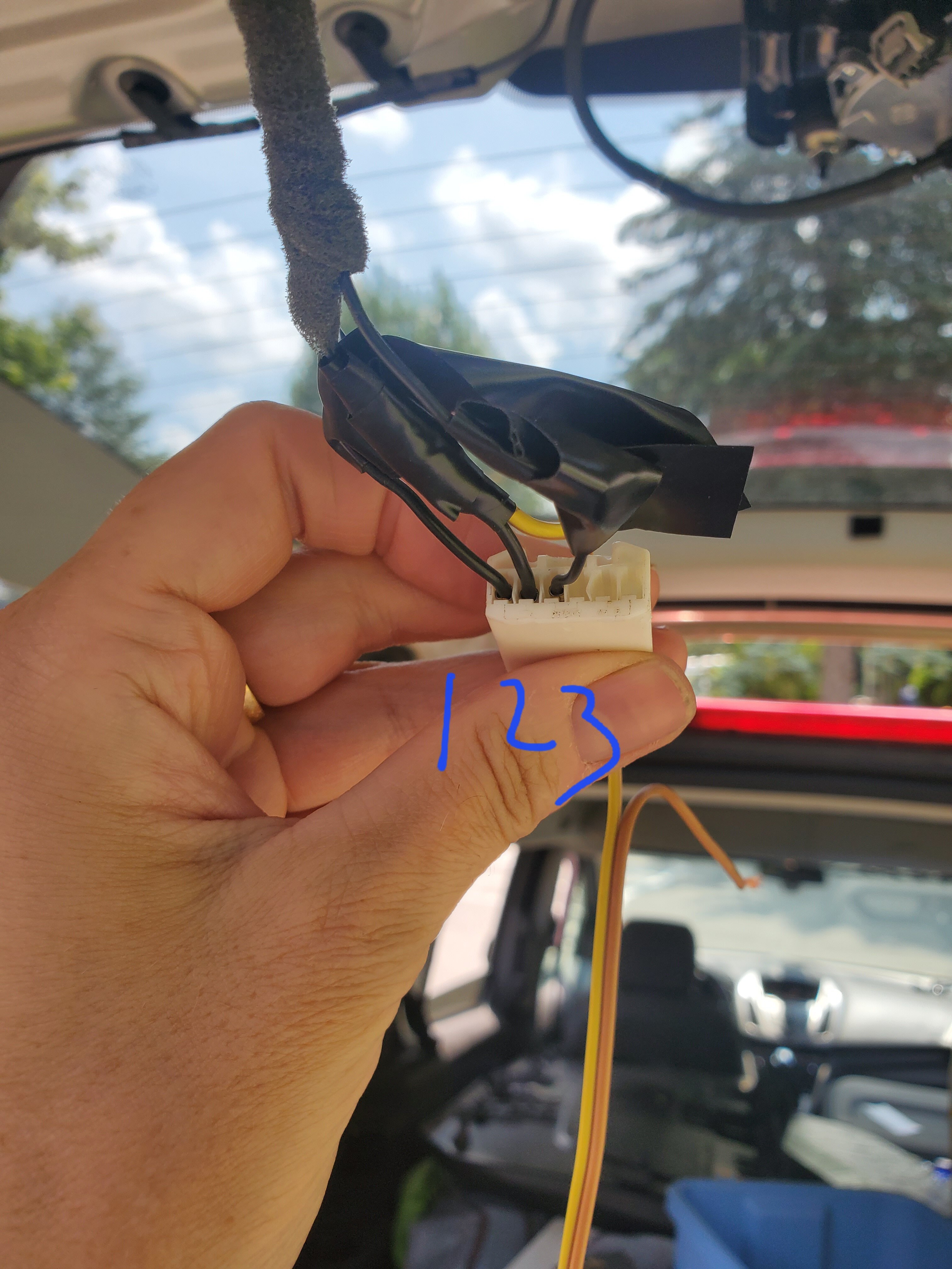

Chip Posted October 24, 2024 Share Posted October 24, 2024 I'm trying to install a switch on the inside of the lift gate of my '21, so I can open it from inside. I just want a switch on the inside of the door itself. My black/red connector box looks the same as pws'. The two Don's and OP (too hard to type pws-autocorrect doesn't like it) had to spend a lot of time figuring this thing out. But the solution is simple, correct? Install a switch between the wires using pin 7 & 10, and that's all, correct? Don R notes a 5.7 volt power source (pin 7?). I'll confirm that's what I have, too. A question about that switch--triggering the momentary switch connects, momentarily, the wires at 7 & 10, correct. That breaks the logic state... then what happens? The BCM tells the latch to open? And what happens to the diverted power--does it just run to ground? That's not normally good, is it? What does "jump pins" and install a "jumper" mean in the context of this thread? Quote Link to comment Share on other sites More sharing options...
Chip Posted October 31, 2024 Share Posted October 31, 2024 I compared the black/red connector in my '21 to the schematic from Don S. I may not be reading the schematic correctly, but it appears I have no wire at pin 10. So, I'm in search of guidance on what wire opens the lift gate latch. Quote Link to comment Share on other sites More sharing options...
Don Ridley Posted November 8, 2024 Share Posted November 8, 2024 Pressing the switch on the tailgate sends a GND signal to the BCM to tell the BCM to open the tailgate. If your connectors are differnt from the 2016 wiring diagram you will have to do some testing to find the right wires. First, find the wire going to the BCM from the tailgate switch. Measure each wire with a voltmeter. Find the one that goes from 12V to 0V when the switch is pressed. Next, find a ground wire. Use the resistance setting on your voltmeter to measure 0 ohms between a metal ground point and the wire. If you are not sure of the proper ground wire then you can connect to any piece of metal on the tailgate for a ground. Connect one terminal on your new switch to the GND point (or wire) and the other terminal to the BCM wire you found in the fist step. When you press the new switch the BCM wire should go from 12V to 0V and the tailgate latch should activate (tailgate has to be closed to activate). Quote Link to comment Share on other sites More sharing options...
