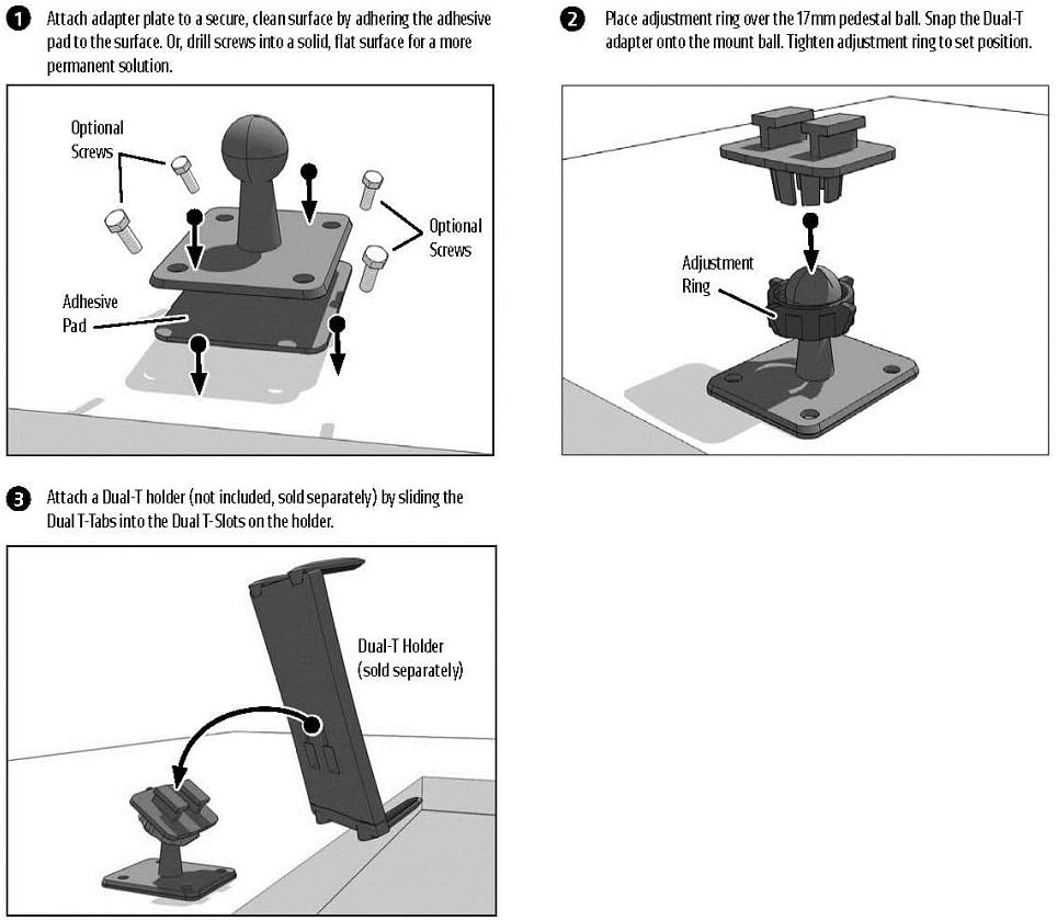

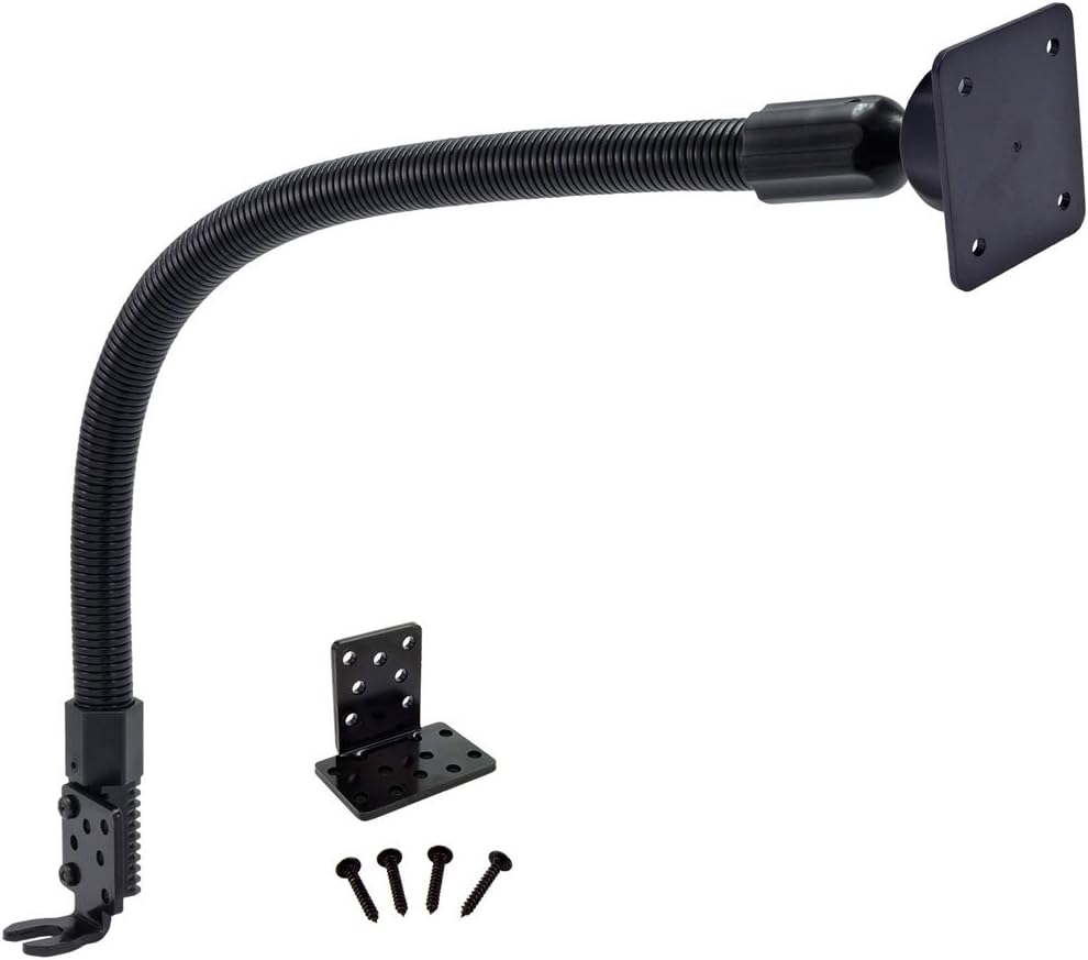

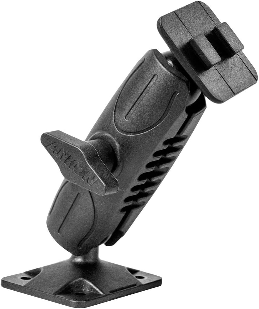

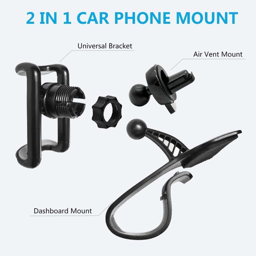

Fifty150 Posted April 2, 2021 Share Posted April 2, 2021 On 3/26/2021 at 3:32 PM, Tile Guy said: vent mounted phone holder/charger I tried a few of those. I just wan't impressed. They wobbled. Scratched into the vent piece. And just didn't feel sturdy and well made. Maybe the ones I bought were junk because I picked a low price model. I didn't like those mounts that stuck into the CD slot either. I tried using the magnetic holders. An even worse idea. The worst I tried was this one. It fit perfectly on the Transit Connect dash. Clips right on. But doesn't stay. A little road vibration, hang a corner, and the phone goes flying. The vent clip has a little spring, which pops out and the clip falls apart. I get that most people don't want to drill into their cars. The most common mount systems us dual tabs, a 17mm ball mount, or AMPS hole pattern. There are options. Obviously, if you screw it into your dashboard, it's a little more stable. I still have a few Garmin GPS units which I actually like using. So the ball mount is something I like to have. Quote Link to comment Share on other sites More sharing options...

Fifty150 Posted April 3, 2021 Share Posted April 3, 2021 11 hours ago, DonShockley said: drawback was the need to slide the passenger seat fully forward I looked at that. Not a great idea if somebody wants to fold down the passenger seat. I don't see a reason not to mount it on the driver side. 11 hours ago, DonShockley said: bending the pole to reach where I wanted it worked well I see those gooseneck extensions in use on fleet vehicles. Some models are strong enough to hold laptop computers in place. I suspect that each brand is a little different, and that some are stronger than others. Quote Link to comment Share on other sites More sharing options...
