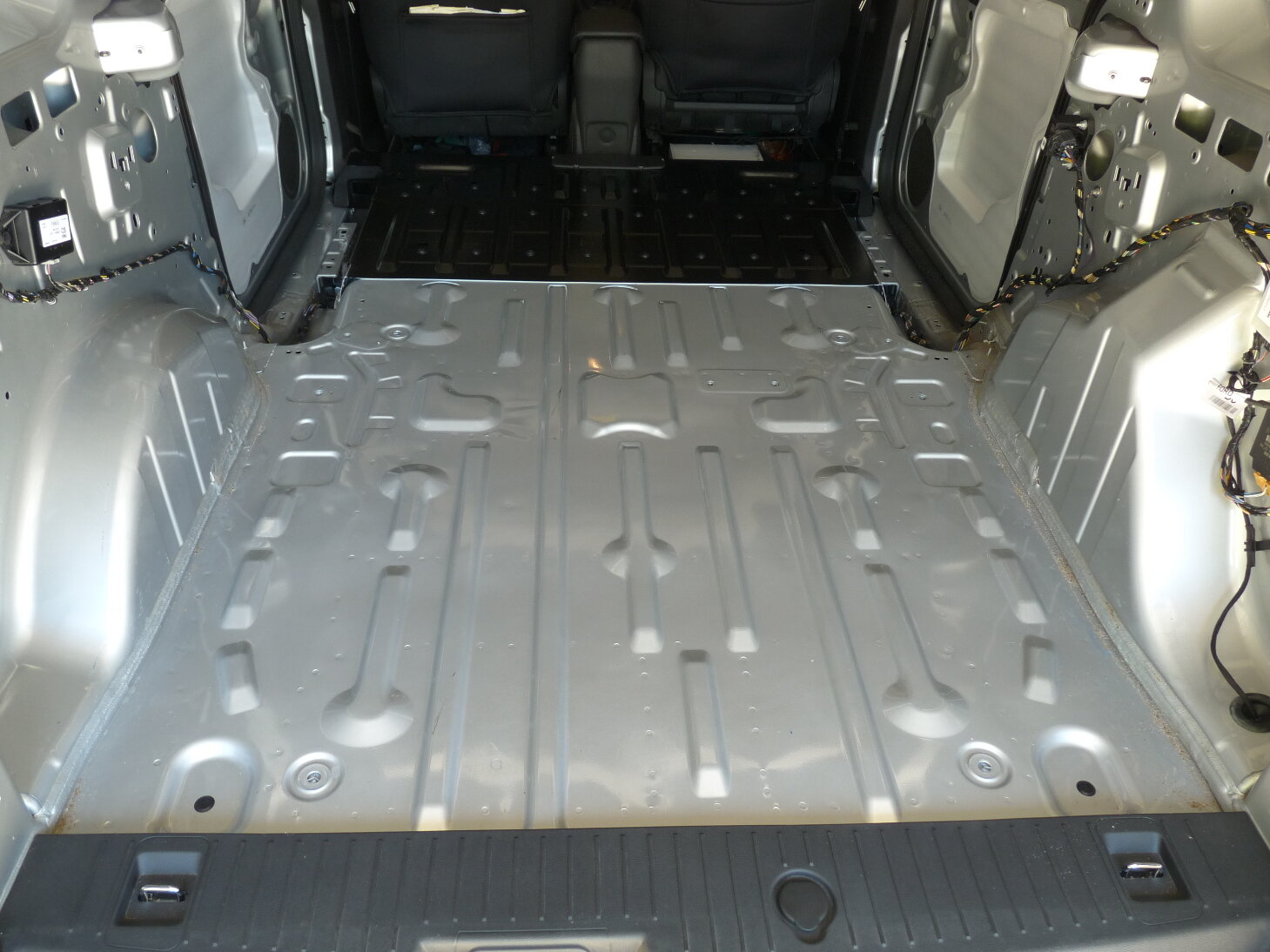

SavvyQueen Posted June 2, 2022 Share Posted June 2, 2022 Hi! My 2016 transit connect with LWB doesn’t have a 3rd row seat. Can used ones be added to make it a 7-passenger van? The pics below are the area I want to add seats. Thanks in advance! Quote Link to comment Share on other sites More sharing options...

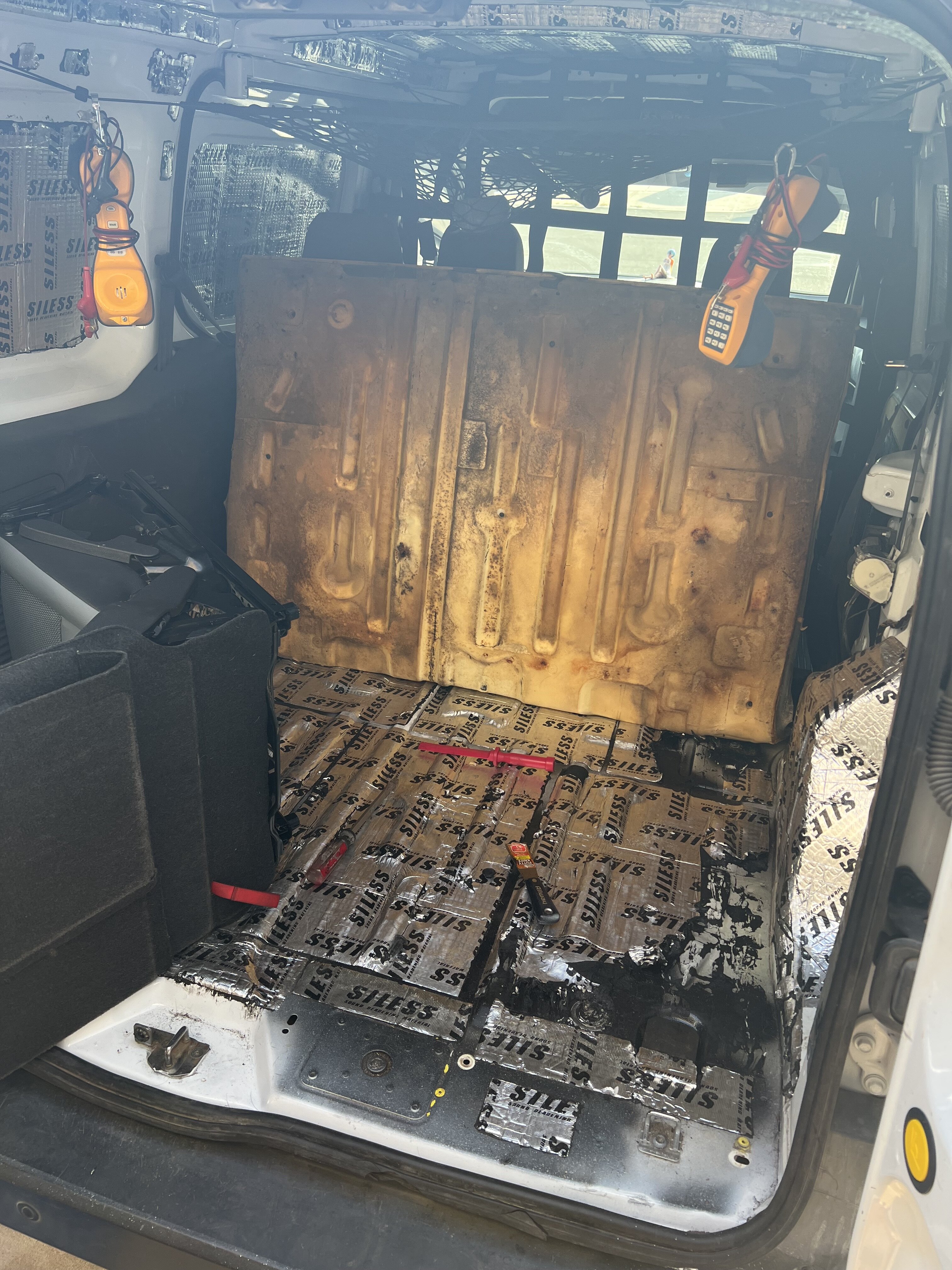

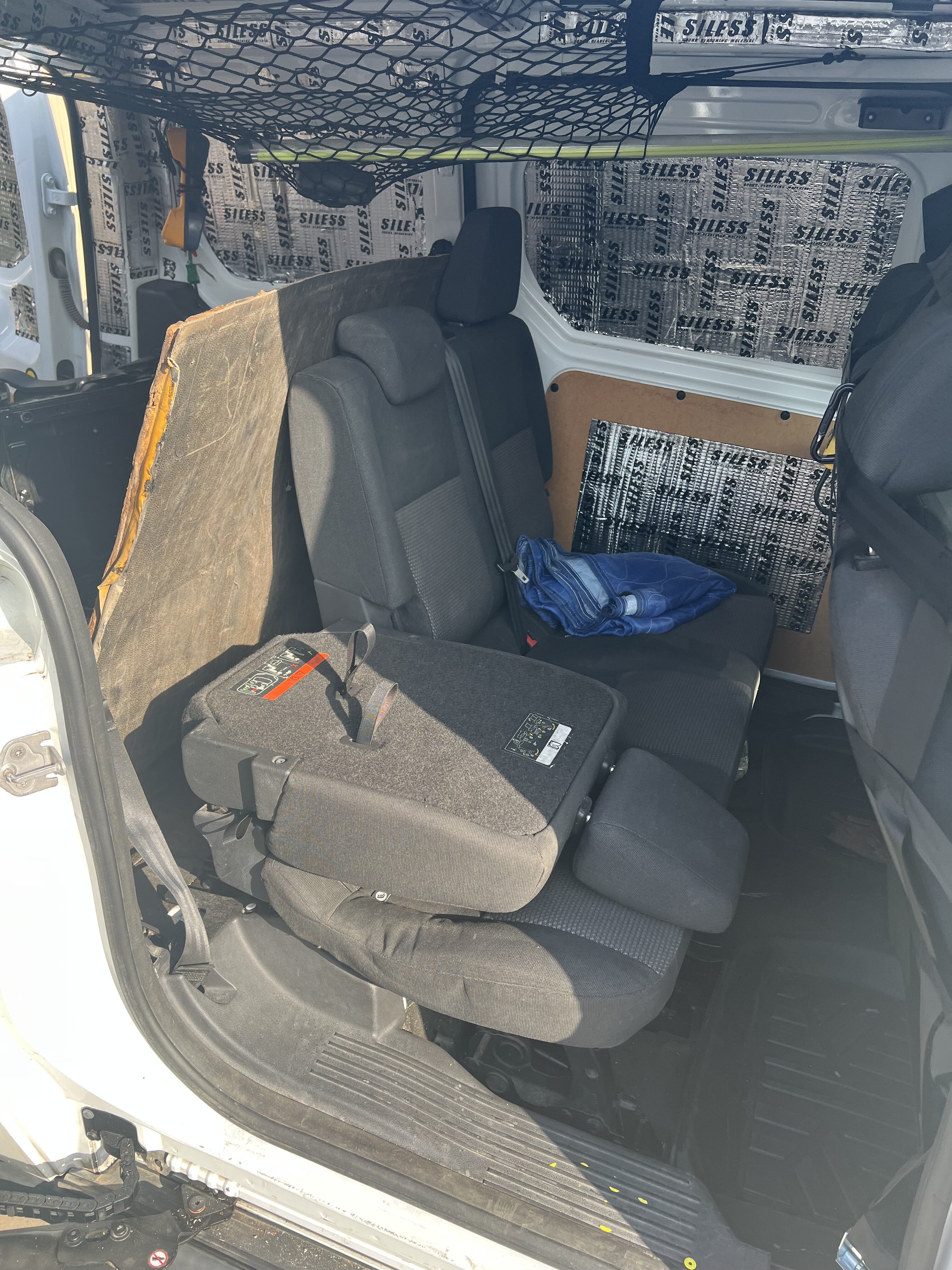

NastyNate338 Posted Thursday at 12:45 AM Share Posted Thursday at 12:45 AM Hi - FNG here. 16 TC LWB Cargo, got a 2nd row in and now trying to add 3rd row. Do the cargo versions come with 3rd row threaded, seat mounting holes? I’ve got the deck lined w sound deadening material and trying to minimize the rework. Do thesevans have the holes and if so, anyone got pics of location and reference point? Quote Link to comment Share on other sites More sharing options...
windguy Posted Thursday at 03:51 PM Share Posted Thursday at 03:51 PM 14 hours ago, NastyNate338 said: Hi - FNG here. 16 TC LWB Cargo, got a 2nd row in and now trying to add 3rd row. Do the cargo versions come with 3rd row threaded, seat mounting holes? I’ve got the deck lined w sound deadening material and trying to minimize the rework. Do thesevans have the holes and if so, anyone got pics of location and reference point? Welcome to the forum. I don't ever recall anyone adding a 3rd row seat to a cargo van. Just 2nd row. I don't think the holes exist. The reason the 2nd row holes were there plus seat belt provisions was the vans were imported with 2nd row seats to get around the chicken tax. Seats and belts, windows, etc were then stripped out to make it a cargo van. I too added sound proofing but I have a pic with the cargo mat removed if that helps. Good luck! Quote Link to comment Share on other sites More sharing options...
NastyNate338 Posted Thursday at 04:43 PM Share Posted Thursday at 04:43 PM 47 minutes ago, windguy said: Welcome to the forum. I don't ever recall anyone adding a 3rd row seat to a cargo van. Just 2nd row. I don't think the holes exist. The reason the 2nd row holes were there plus seat belt provisions was the vans were imported with 2nd row seats to get around the chicken tax. Seats and belts, windows, etc were then stripped out to make it a cargo van. I too added sound proofing but I have a pic with the cargo mat removed if that helps. Good luck! I think you’re right. I placed the seats where it would make sense and then scraped up all the sound deadening material in the surrounding area and didn’t find mounting holes. I’m gonna go to Ford and print a diagram that details the difference between the two vans. It should just be a threaded nut that’s machined into the body. Dependent upon what I find out, I might fan some brackets and drill some holes but we’ll see. Thanks for the reply🤙🏽 Quote Link to comment Share on other sites More sharing options...
