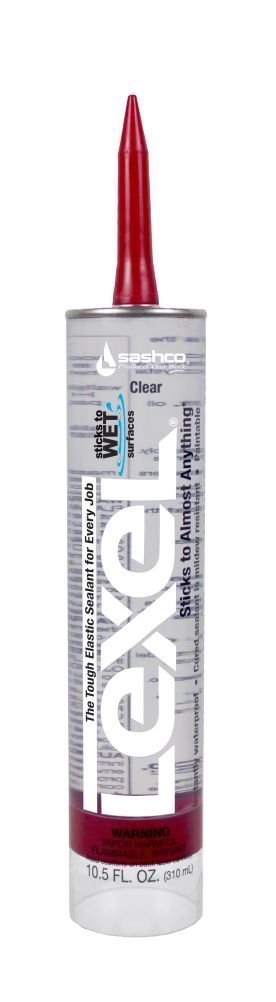

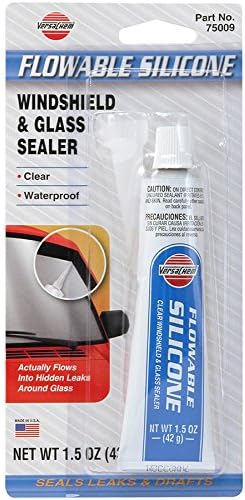

As for the windshield...... the best thing to do is remove the windshield, then reinstall with a new gasket.  Some shops use a generic gasket seal maker.
412mhkKsnKL._SL1002_.jpgVersachem 75009 Flowable Windshield Silicone - 1.5 oz.71fX-7A7eVL._AC_SL1500_.jpg
