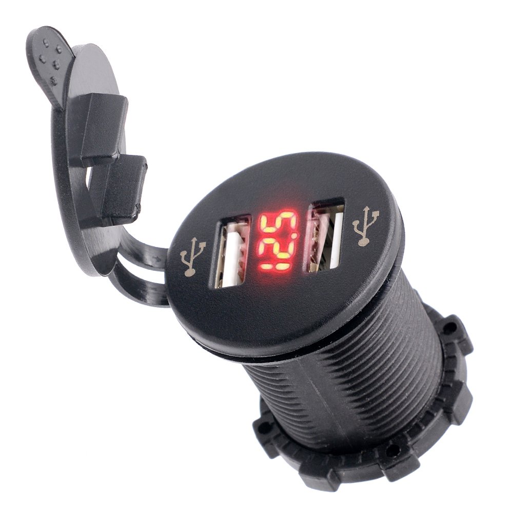

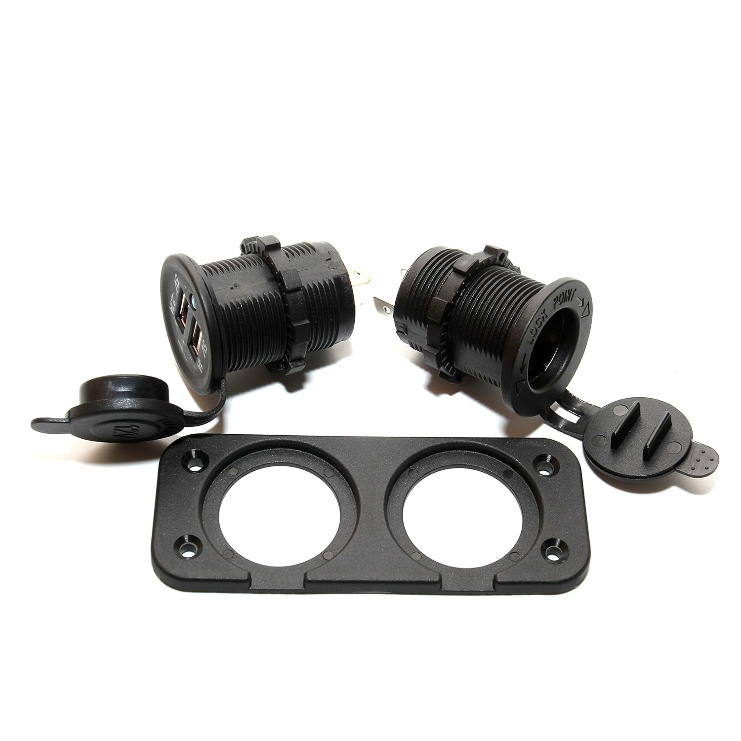

Fifty150 Posted October 14, 2016 Share Posted October 14, 2016 A couple of these power ports would have made your installation a lot more worthwhile. I installed my extra power in the OEM location, using the OEM wiring harness. Quote Link to comment Share on other sites More sharing options...

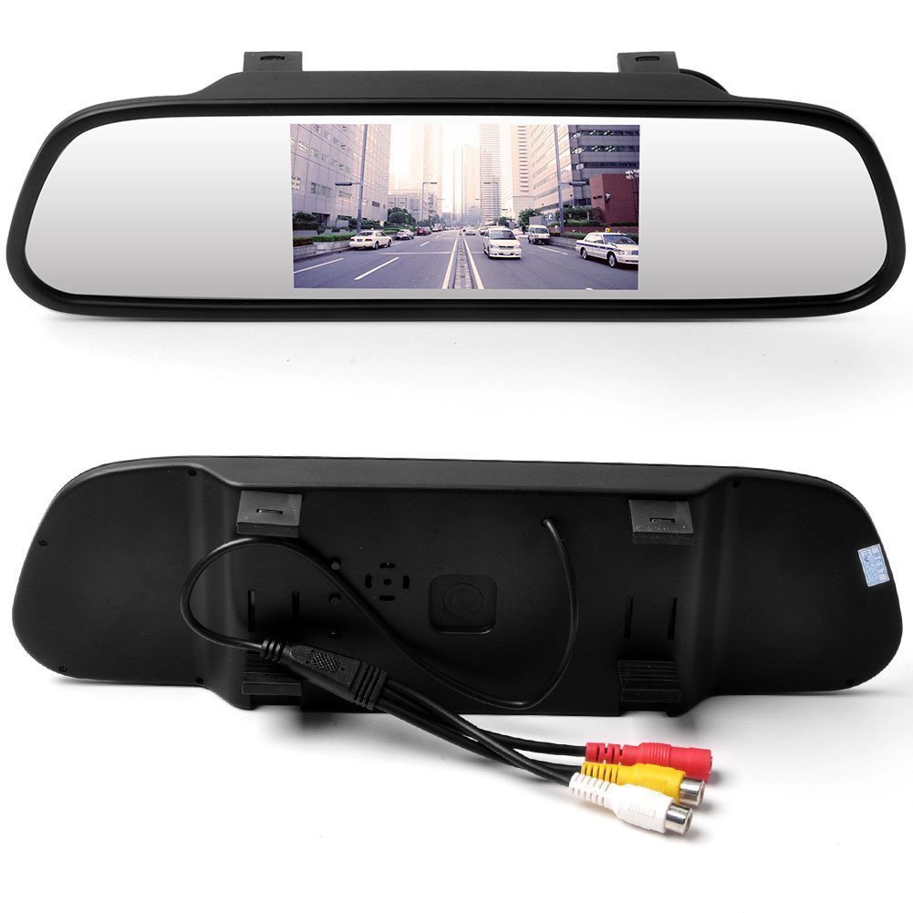

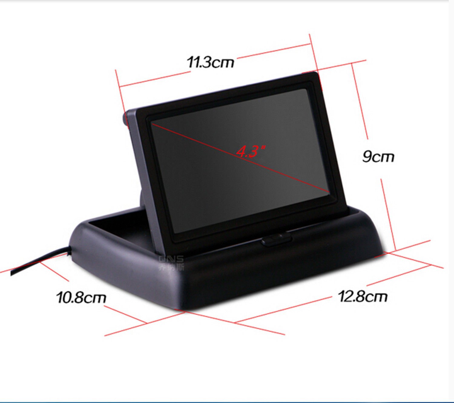

Fifty150 Posted October 14, 2016 Share Posted October 14, 2016 You didn't have to fabricate that 2X2 block with velcro. There are other options. This folding monitor would sit nicely with a little velcro. This could also velcro onto your dash. Or the rearview mirror monitor could have worked. Quote Link to comment Share on other sites More sharing options...

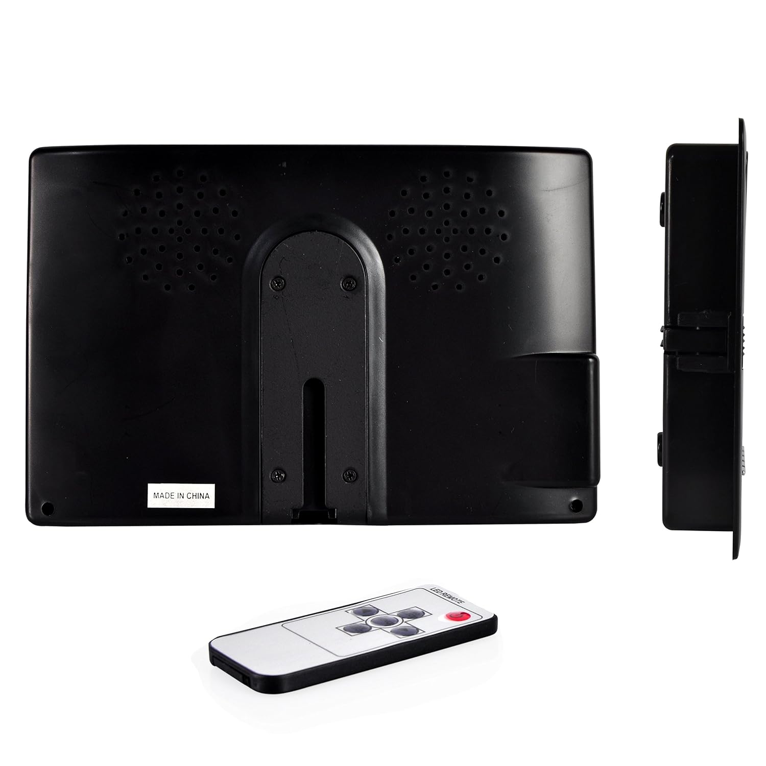

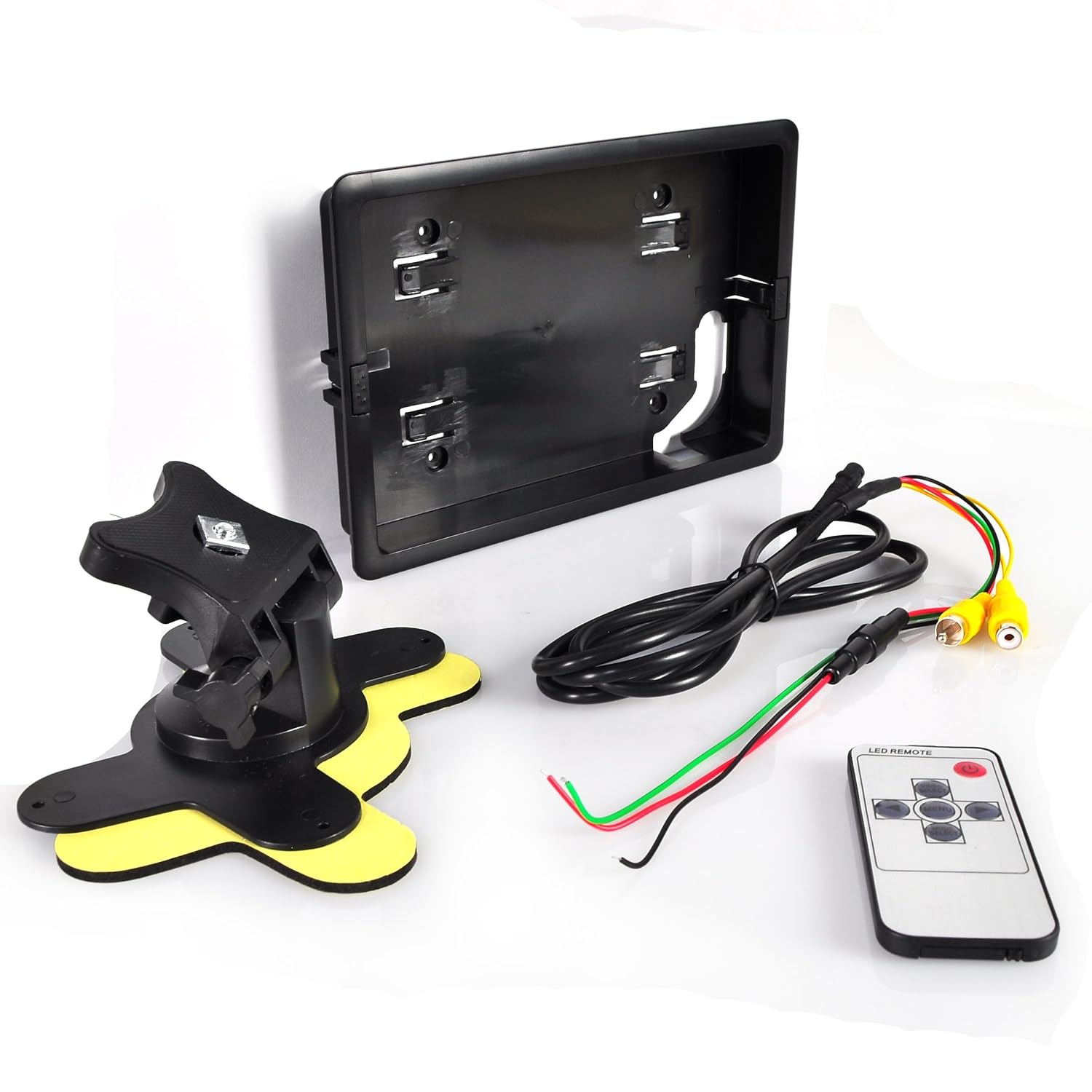

Fifty150 Posted October 14, 2016 Share Posted October 14, 2016 Go for broke. Install this unit into your sun visor, then all you would need to do is flip the visor down to see it, With the visor up, nobody will even know that you have it, and you won't have to worry about someone breaking into your car to steal it. Quote Link to comment Share on other sites More sharing options...
