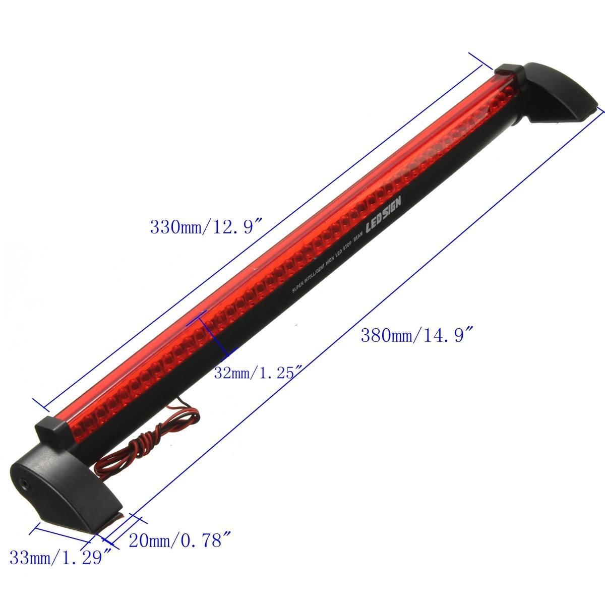

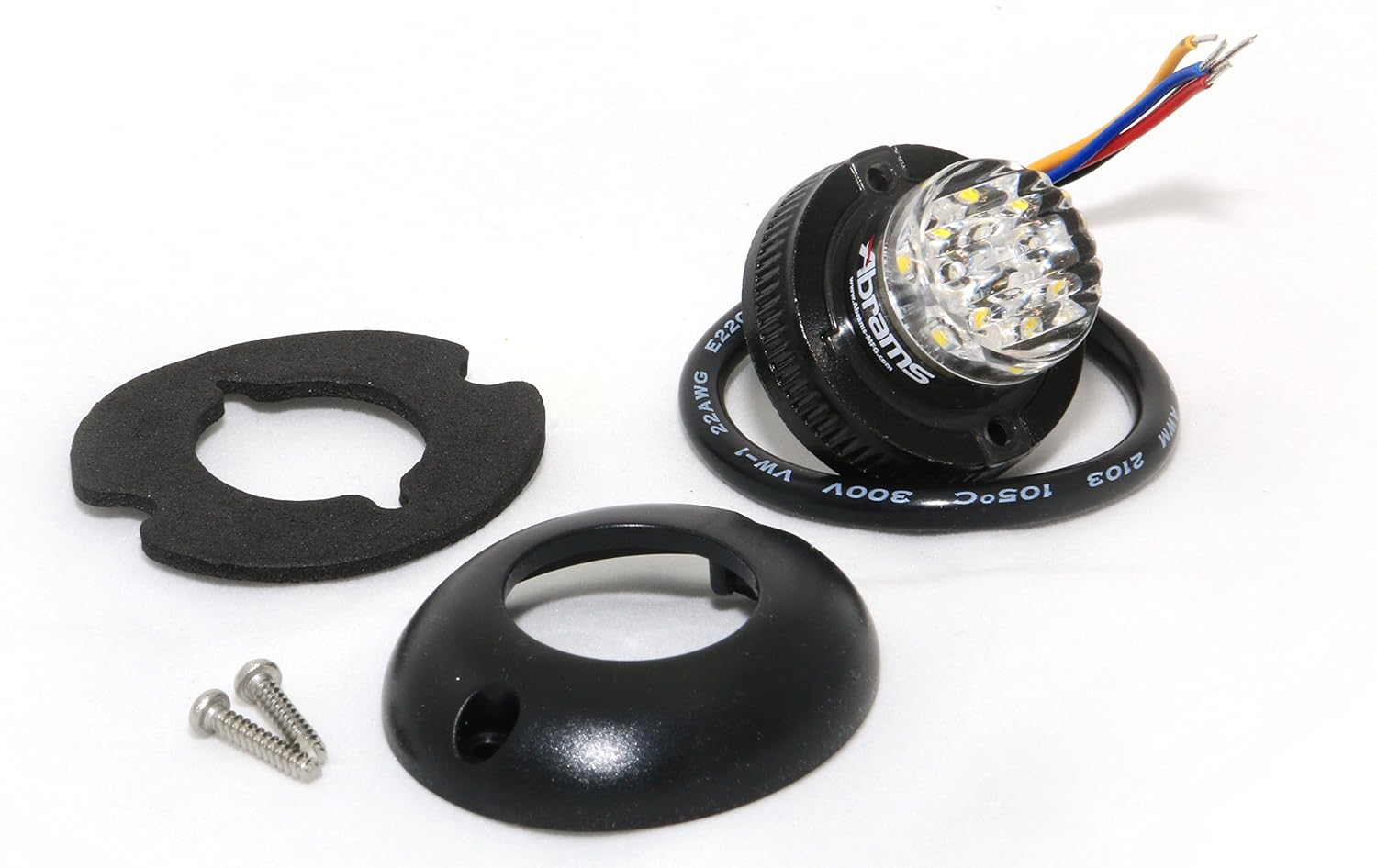

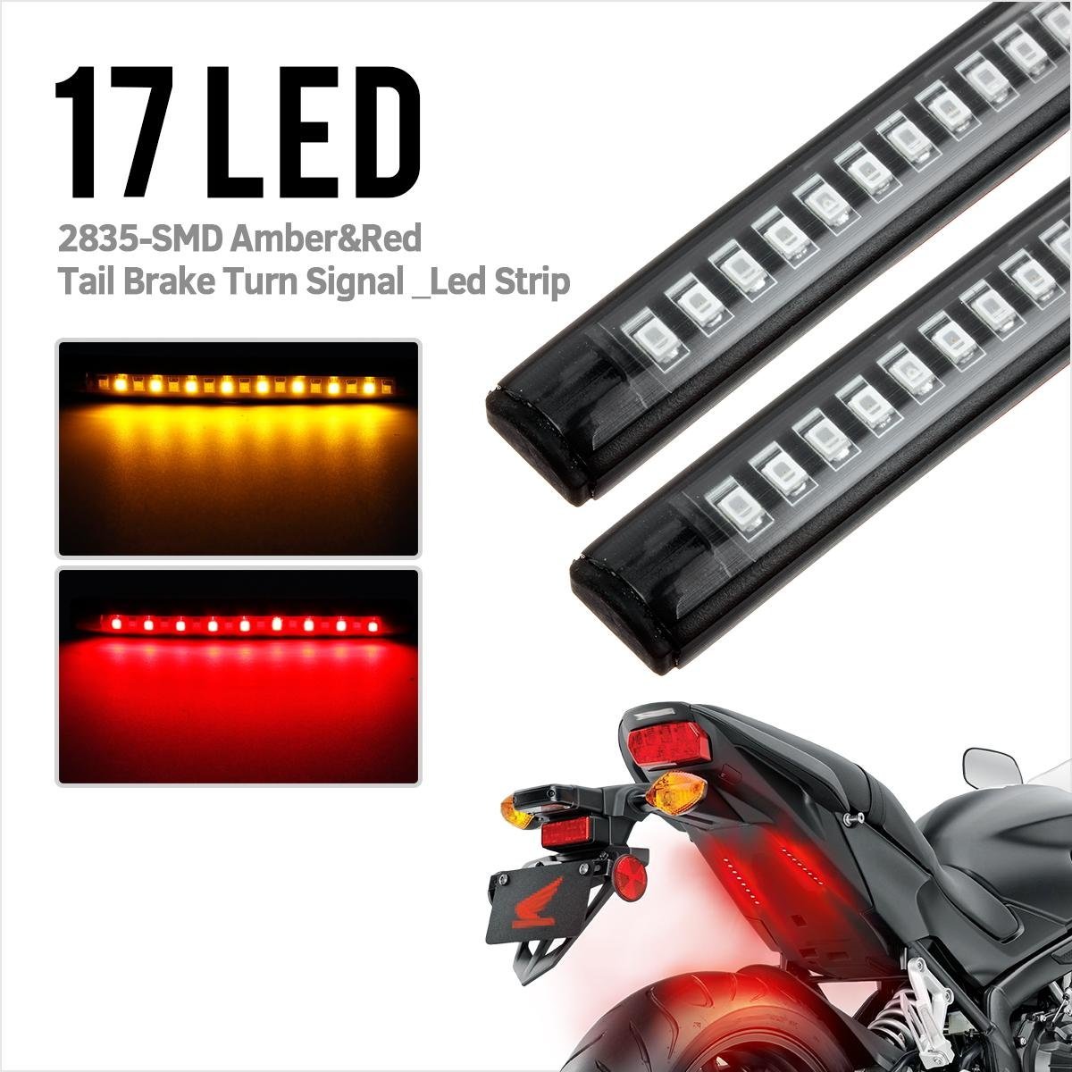

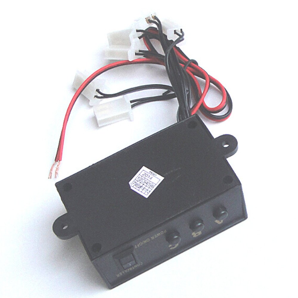

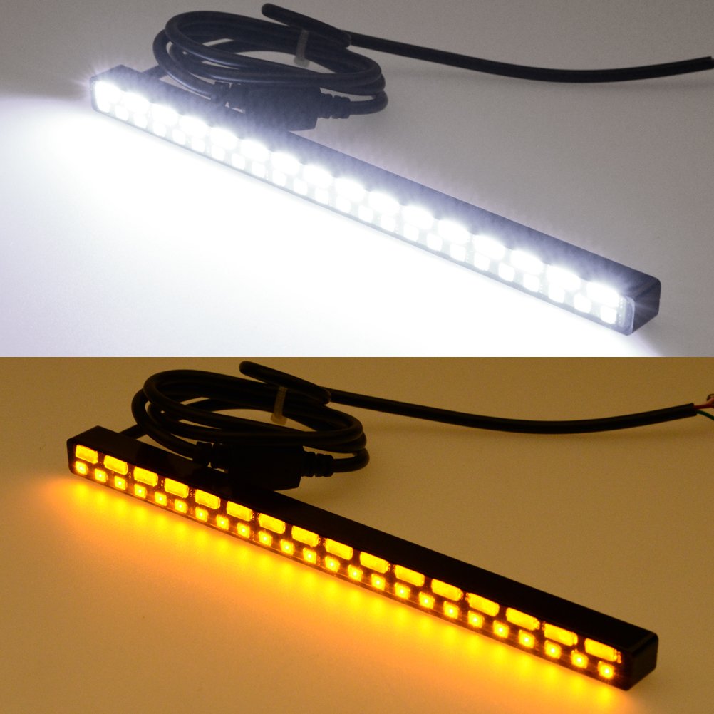

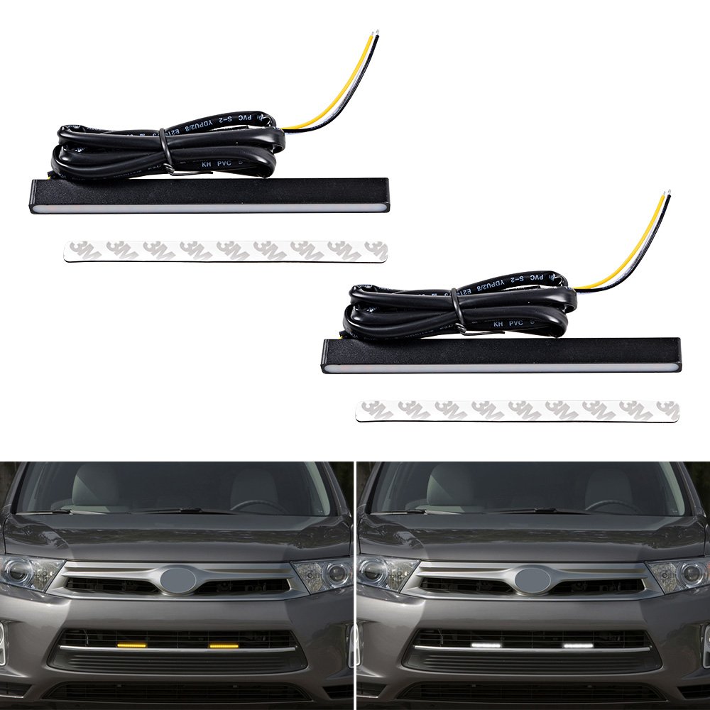

Fifty150 Posted September 9, 2016 Share Posted September 9, 2016 Lots of options out there. I always advise against visor lights, dash lights, or any lights that are mounted in the vehicle interior. Why? They tend to reflect lighting into the vehicle's interior. At night, it's more of an issue. How discreet do you need your vehicle to be? Grill lights are simple. You can easily acquire "switchback lights" and have the option of running them as daytime running lights, and LED flashers when needed. Rear mounted switchback lights could also be wired for rear facing work lights, auxiliary turn signals, and "excuse me" flashers when you cut people off as you're responding "code 3". Switchback LED lights are easily found on Amazon dot com, along with the simple flasher units to make them wig wag. I personally prefer that my unmarked vehicle stay unmarked. Strobe flashers can be hidden within OEM light housings. Low profile speakers can be tucked behind the grill and bumpers. On my pickup truck, I used the high mount stop light's clear bed lights. Disconnected the OEM lights and taped over the unused wires. Installed LED lights in red and blue. Then wired them to a simple alternating flasher. Of course, with a pickup, there is a lot of room for improvising. Simple wig-wags wired into the high beams were good enough. My siren speaker is tucked behind the grill so that nobody sees it. But it's okay, since I will not be conducting traffic stops in my personal vehicle, on my own time. Quote Link to comment Share on other sites More sharing options...

Tiller Posted September 12, 2016 Author Share Posted September 12, 2016 Thank you both for replying! Sorry it took so long for me to get back. Crazy weekend. Anyway. I'm trying to decide on exactly what lights and system I want to put in. I have two objectives. Lighting up areas around the vehicle to use as work areas is probably the primary one. But I don't want to go crazy and I don't want to look like some nutty lights crazed guy. Right now I'm actually toying with the idea of only putting some work lights on the cross bars of the roof rack. The cross bars look pretty easy to add and remove and I would simply install them before I left on a call. The second is a few blue lights. I don't need to use them very often. A few times a year maybe. Max once a month. I'm planning on hidden grill strobes for sure. Then maybe visor area lights. Fifty150 - thanks for the posting and lights. I really like the switchbacks!!! Might try to use something like that. I appreciate the concern on the interior lights. My problem is two fold though. One, I'm not crazy about mounting roof lights or roof bar. I could possibly add a light to the cross bar of the roof rack. Secondly, I live within 10-60 minutes of 3 different states besides mine. I'm often out-of-state, almost on a daily basis. I can get in trouble in other states for just having the blue lights on the car. Most of the time the officers don't hassle the out-of-state FF'ers unless they have reason. But why push it? So I'd like the blue lights to be very discreet. Don: Do you know what switches or item mounted in the overhead storage system that you did your wiring through? I'm wondering if there are any switches specifically built for that area? I included a picture of my overhead. You can see the oval cover just above the mirror. That's where I'd like to put some work switches. Thanks! Craig Quote Link to comment Share on other sites More sharing options...

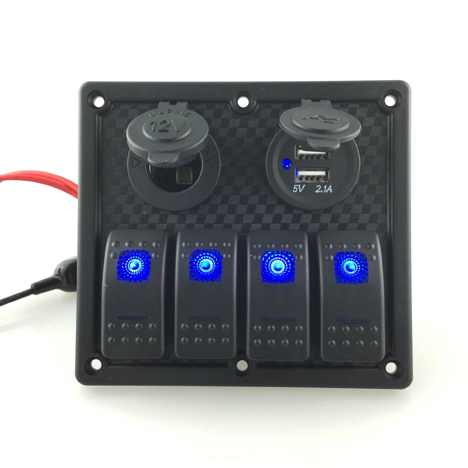

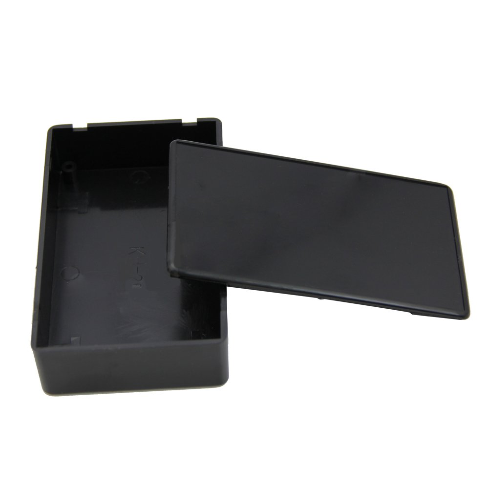

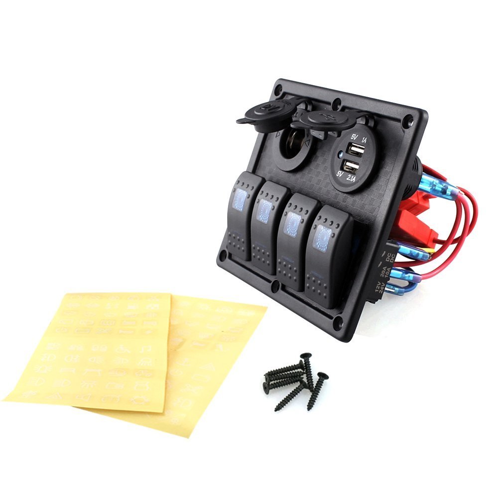

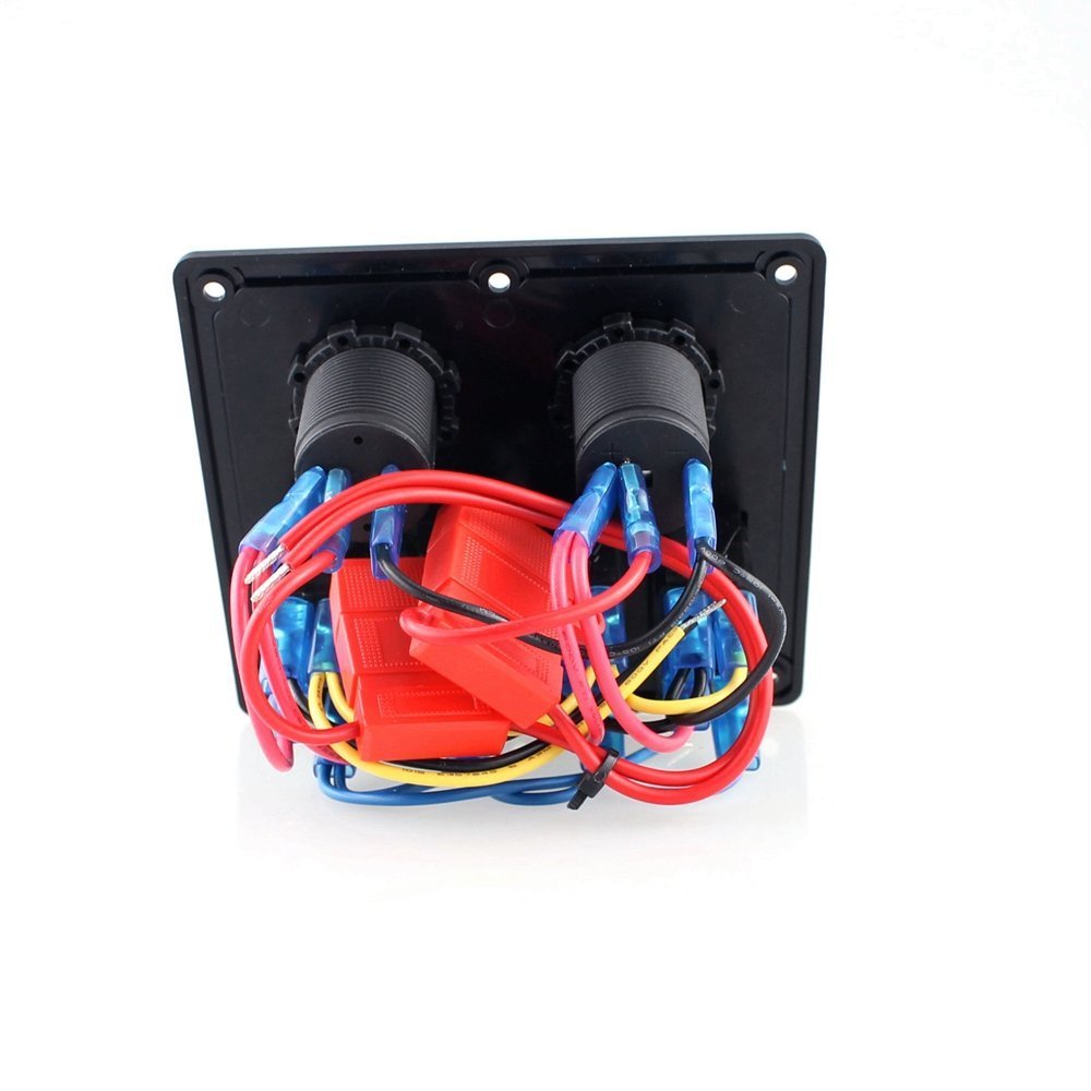

Fifty150 Posted September 15, 2016 Share Posted September 15, 2016 Go old school. Get a project box, some switches, and build your own switch panel. Quote Link to comment Share on other sites More sharing options...
Tiller Posted September 15, 2016 Author Share Posted September 15, 2016 I'm actually thinking of doing that. What I'll probably do is take the pop on panel cover in that head liner which I think is for optional dome lights and I'll get my handy Dremel tool out and modify it for 4-5 switches and figure a way to mount it more securely. But my first project will be Don's auxiliary fuse box. But I think I'll put one in the rear cargo compartment for some rear accessories I have planned and I'll add a second one up front I think in the passenger side, floor compartment under the seat. The one upfront I'll power directly from the battery, maybe via cable underneath to the battery. The ignition trigger line coming from the cargo fuse box. That way the 40 amp circuit in the back can be used for the rear accessory fuse box. Otherwise I'd be limited to the 40 amps combined on the two accessory fuse boxes. Instead, I should be able to have 30 amps available up front and 30 amps in the back. If I understand correctly what Don did. Quote Link to comment Share on other sites More sharing options...
