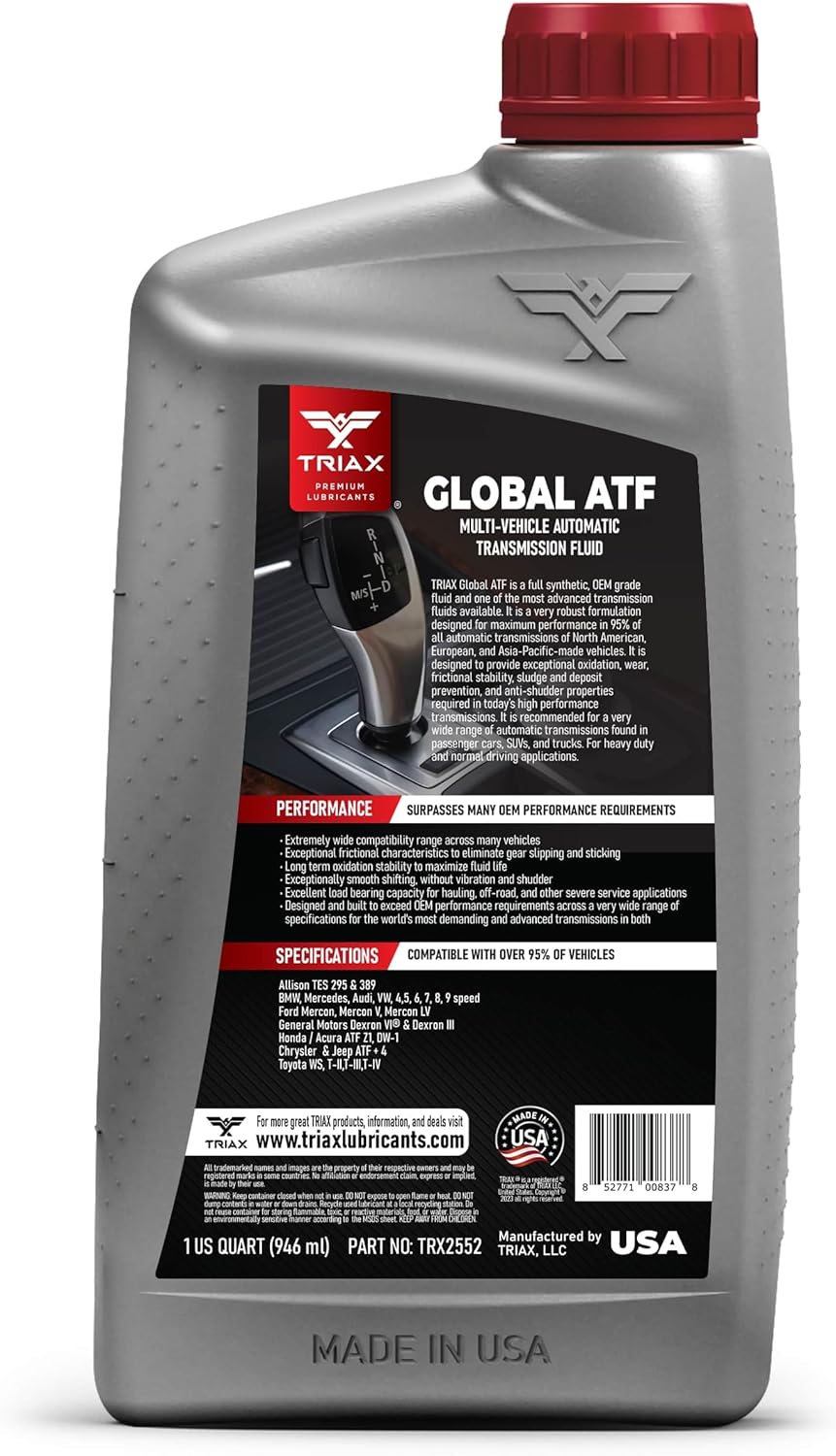

As for the fluid I changed mine to Triax universal  at 35000 and now the out going fluid at 30000 mile increments it still very red.  It  sounds electrical .  If your scan tool allows a shift relear could be done.  Waiting for the next up date!  You are also allowed to be lax. 71ISV0A2G+L._AC_SL1500_.jpg
